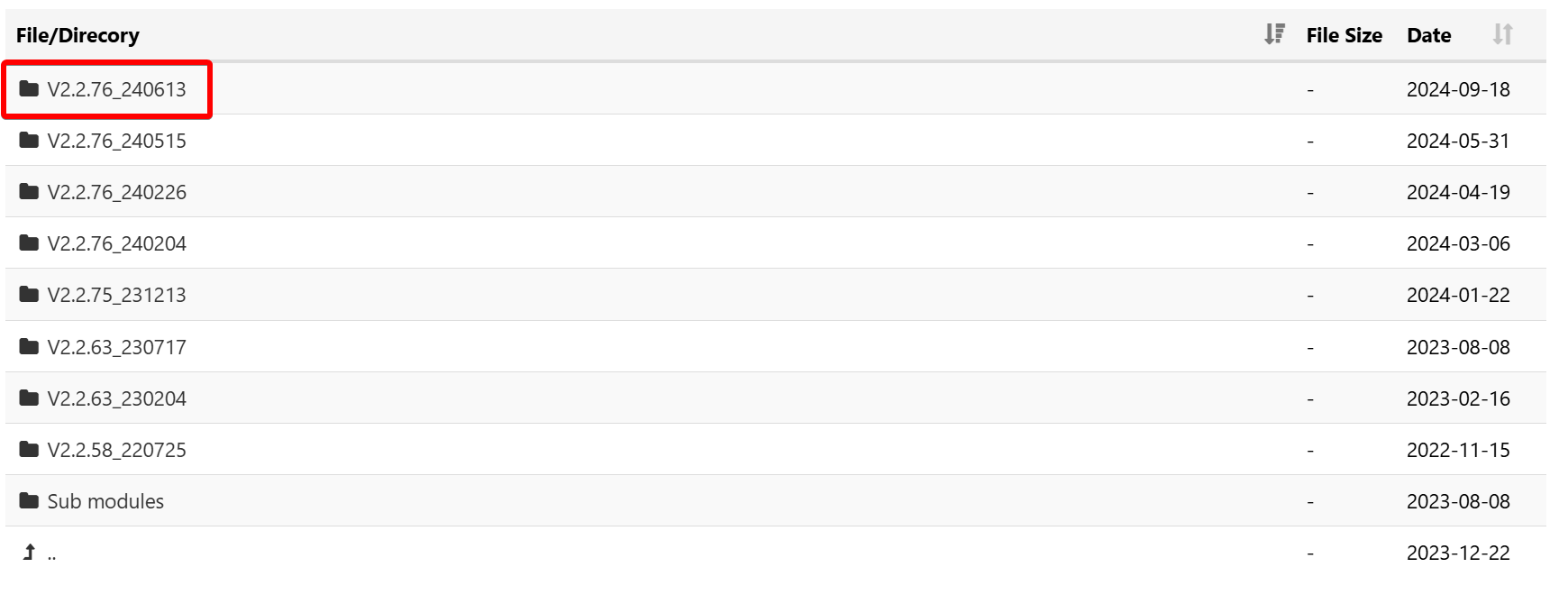

There are quite a lot of different build versions of the 2.2.76 firmware for the DS-KD8003-IME1(B), are you using the latest, which is V2.2.76 build 240613?
When you have both devices running the latest firmware, factory reset them both, as we've seen this resolve problems before after firmware updates.
Also, delete and add the indoor station to your Hik-Connect account after that, and test with any VPNs on your router / Antivirus briefly disabled, which we have also seen cause this problem.

Yes, I'm using the latest 240613.
