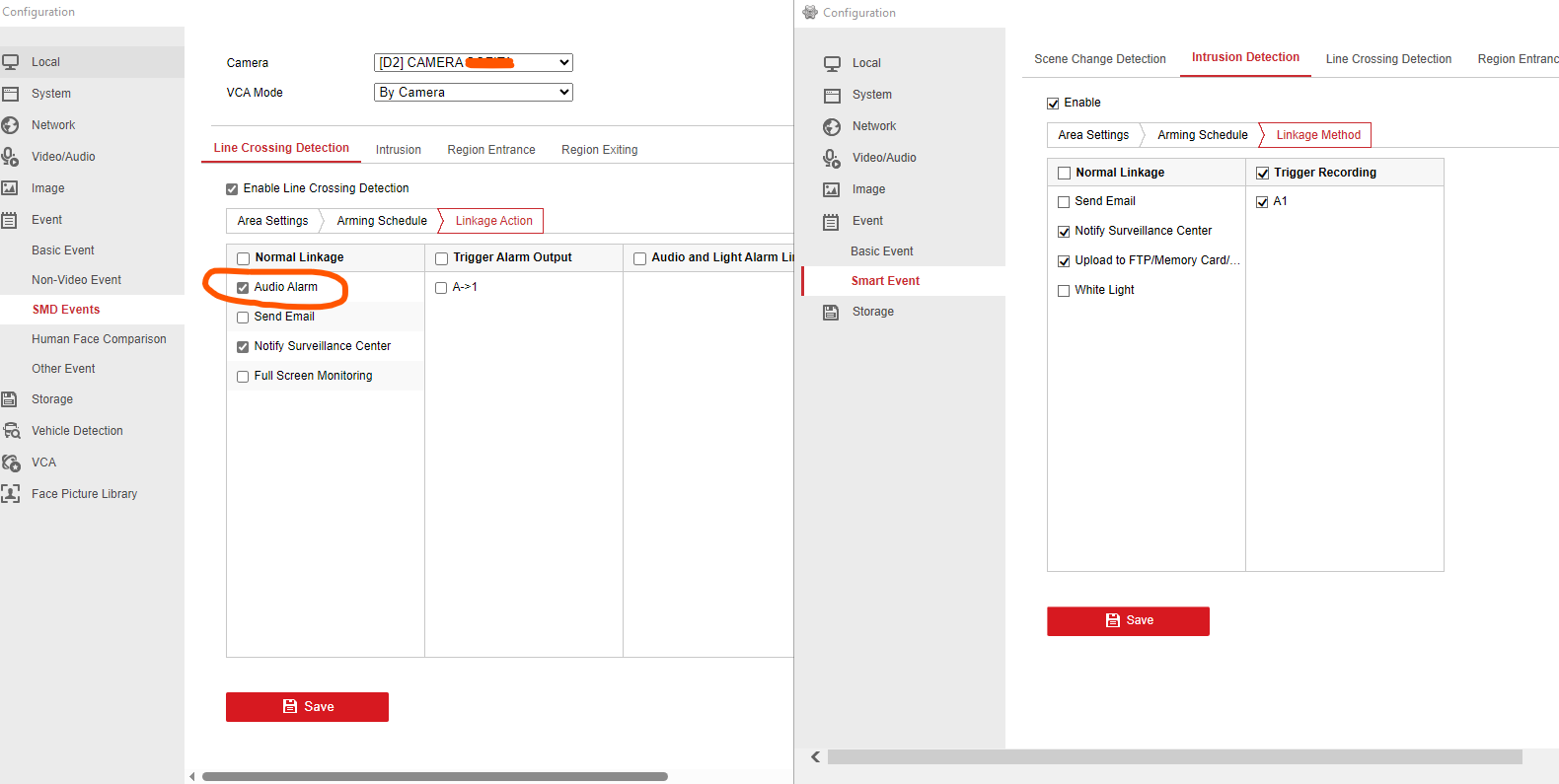

All Cameras settings are set by camera except one that is only included in NVR settings.
This setting is Linkage Action-Audio Alarm. I do this first, selecting only the type of Smart Event I want to use. But you can do on all kind of Events for future use. This remains selected when saved once.

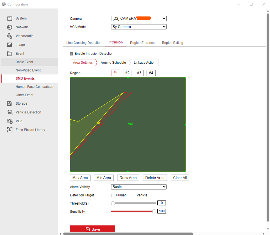

Now about the rectangles and decagons I can not understand why they fixed only for VCA mode by NVR and not VCA mode by Camera.
This is what they write on K20A9_V4.75.005build230630_ReleaseNotes.pdf:
"7. Perimeter algorithm optimization
. Supports a max of 10 points
Support max and min rule"
They don't write only for VCA mode By NVR

Hi JB. How do I apply Audio Alarm if not applying on NVR? But if you apply, then the areas are converted to rectangles and you have to do them again(repeat) from camera. Agree, that may be I am the only one with those issues. Left pic is the NXI-K2 right pic is the ColorVU
Hi
Correct, do the available settings in the NVR & then (if necessary) do any settings on the camera that are not available in the NVR interface.
I've seen similar. However, the individual rectangles (grid) cover the same shape on screen as the polygon. It's just the way that shape is represented.
Most times yes. It depends on the polygon. Sometimes it can even become a triangle. I cannot understand how the NVR chooses the dots and then closes the rectangle by itself

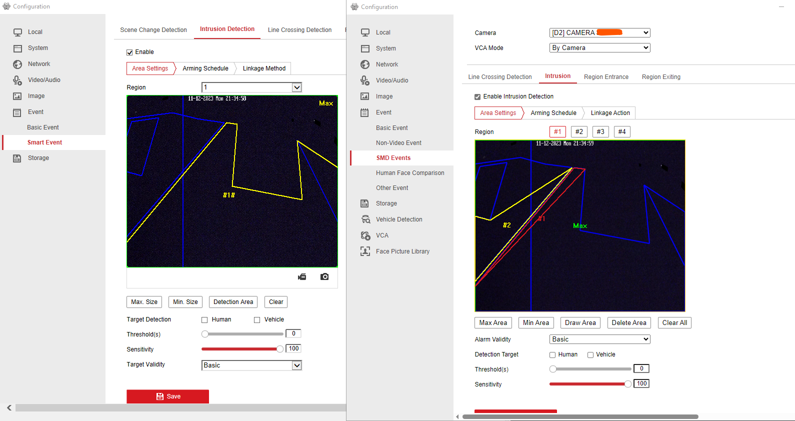

IVMS 4200
Left pic ColorVU Intrusion settings, two Intrusion areas #1 yellow and #2 blue area, two Line crossing detection the vertical blue on the left and the slanded one on the right.
Right pic NVR Intrusion settings for ColorVU automaticaly modified by the NVR region #1 red and region #2 yellow. But you can also see the blue ones created by the Camera settings
Above mess does not mean that the areas created by the camera do not work. It means that if you modify and save a change on the NVR e.g. the Linkage action for Audio Alarm or the Full screen Monitoring, then you have to draw the lines again in camera settings and not the NVR

Yeah it's a bit weird. It looks as though when you drew Region 1, you started at the bottom left, clicked the next two points (above, then a fraction to the right). At that point, the drawing of the zone completed itself down to the first point, prematurely, before you finished the polygon.
I remember the bug where polygon motion zones used to default to a large (almost full screen) rectangle following a reboot. That took so long (probably more than a year) before Hikvision resolved it.
They are both 9 points. The rectangles include solar panels with reflections, so excluded for false alarms.

Yeah I see that. What I mean is, it looks as though when you drew it via the NVR, it autocompleted the shape from point 3 (back to 1)
No I drew it via the camera. Yes it was simultaneously autocompleted from point 3 back to 1 by itself and by the NVR and I saw that when entered NVR settings. All of them, IVMS, NVR and browser.
But it is OK though and you can see the right regions on NVR Live View
I'd always draw the area on the NVR (which then applies it on the camera if using camera VCA). That's not to say there's not some bug as alfaclvi is experiencing.
Yes I agree that the solution is to draw on NVR, but then again, to achieve the result of one 10 sided polygon(like mine 'Only Connect' puzzles), you have to use all four regions of the NVR. They must fix, as they fixed the 10 sided for VCA by NVR
So you're saying the bug is that when setting up intrusion by the NVR interface, it's not possible to draw a 10 point polygon on that particular NVR?
Yes. This is the "problem". But as I told you before, it's not a big deal since it works fine if all work is done by Camera. Its just an indication if at at least you don't save something by NVR at this particular setting
