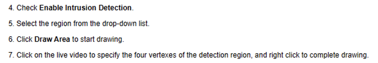

The help file associated with both my M series NVR and the G5 camera both indicate that for intrusion detection you're limited to a four sided polygon (not 10 as is allowed for motion detection)
M Series:
G5 Camera:
Both indicate 'click on the live video to specify the four vertexes of the detection region'

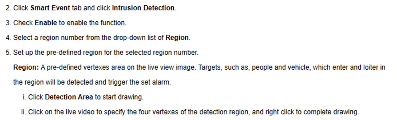

Yes I know JB. Same thing for DS-7608NXI K series
2. Set Camera.
3. Select VCA Mode.
By NVR
The event will be analyzed by NVR. The device can analyze videos that contain human and
vehicle. Only the target of selected type (human or vehicle) will trigger alarms, which can
reduce false alarms that are caused by other objects.
By Camera
The event will be analyzed by camera.
4. Turn on Enable.
5. Optional: Check Save VCA Picture to save the captured pictures of VCA detection.
6. Set the detection rules and detection areas.
1) Set Arming Area. Up to 4 arming areas are selectable.
2) Adjust Time Threshold and Sensitivity.
Sensitivity
The size of the object that can trigger the alarm. The higher the value is, the more easily
the detection alarm will be triggered. Its range is [1-100].
Time Threshold
Range [1s-10s], the threshold for the time of the object loitering in the region. When the
duration of the object in the defined detection area is longer than the set time, the alarm
will be triggered.
3) Optional: Set Target Detection as Human or Vehicle to discard alarms which are not triggered
by human body or vehicle.
4) Click Draw Area and draw a quadrilateral in the preview window by specifying four vertexes of

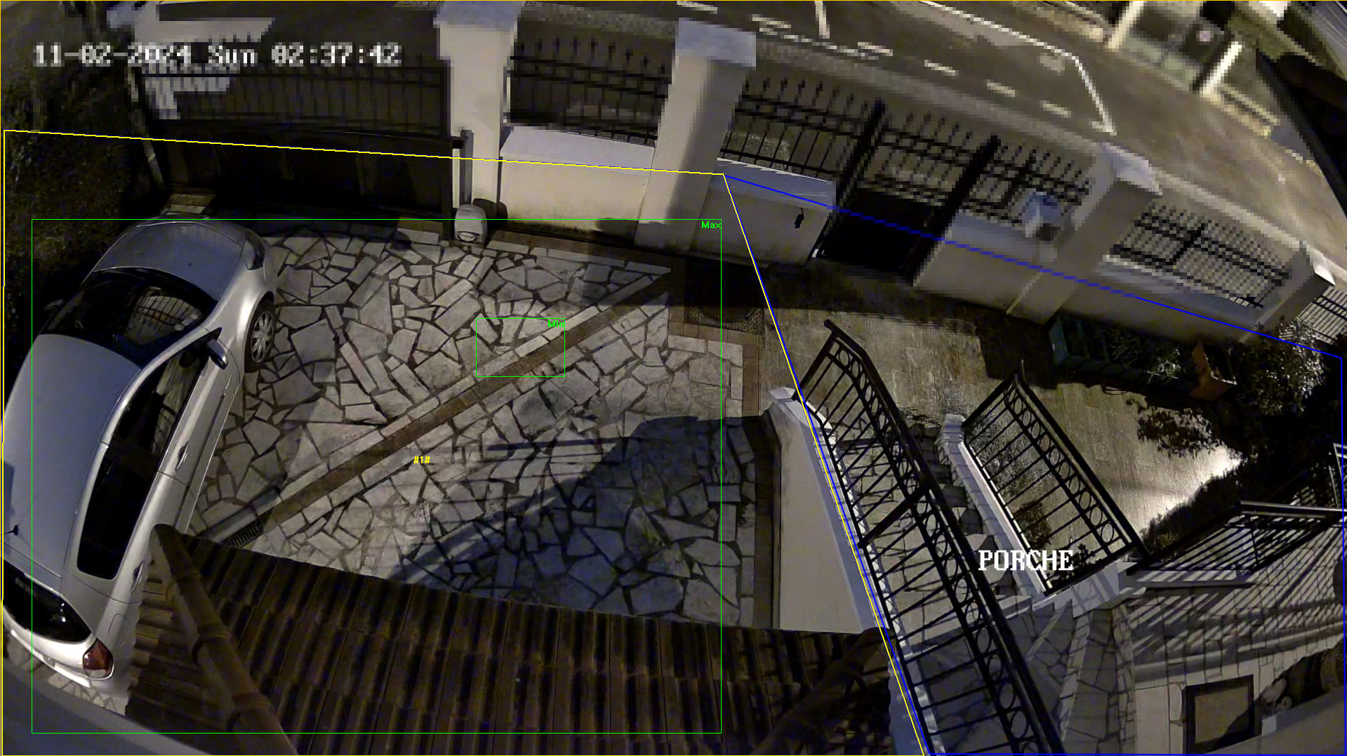

With the new settings, i get no notification at all, for ex this night at 2:07AM the car entered the area with lights, the area turned red but i did not get the notification on the app. (basic event/motion detection recorded the event)
Settings:
From smart event/ intrusion detection with human and vehicule unchecked, sensivity 100 and thresold 0 . I've redrawn min size and max size (as on the screenshot). The max size has to be that big because i've seen that the shadow of someone walking in the area is also taken on the analysis.
I've also configured basic event / motion detection with sensitivity at night = 50 and i get 100% records on the hikconnect app. I haven't enable notification as i would get a lot of false positive. Every car passing on the street with lights get trigger by motion detection as the light is moving inside the area, reflects on the walls, car, etc..
I'm not sure if i'm doing something wrong, should i check again human/car ?
All settings were done on the camera (not on the NVR)

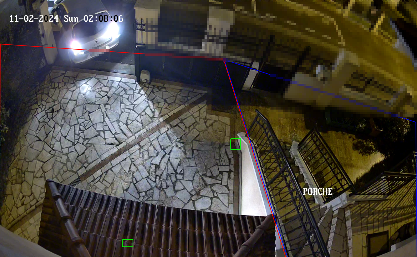

Attached screenshot, this is exactly what you are describing, the region is triggered (red) but send no notification.
What are our option ?? How i'm supposed to get notification if some thieves are visiting us at night?

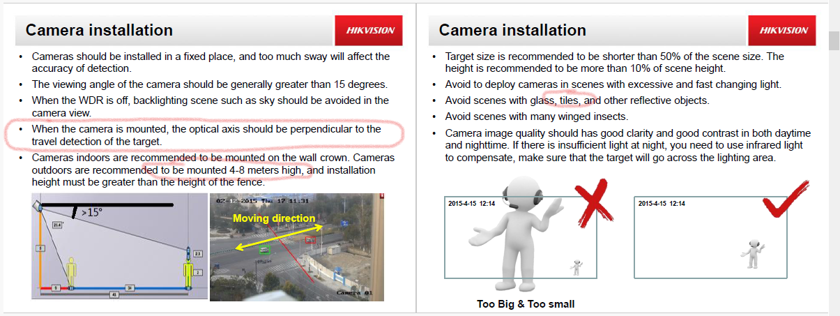

No I don't believe these are codec issues. Codec, bit rates, constant or variable, i-frames etc I believe that concern Playback for iVMS, Hikconnect and NVR GUI.
I believe that as if it concerns Detection, this is just an installation position issue. Two things: Height placement and Optical axis not perpendicular to travel direction of target. Not backlight, no angle, no excessive and fast changing light, no bad clarity or bad contrast.
Another common with Martels placement is the flooring broken tiles mosaic. We have similar tiles that may cause a "camera confusion"
I cannot think of something else. VCA recording or event alarm delays are other kind of issues, and not optical.
But maybe both can be solved with firmware.
For the time being I do not intend to change camera position. Cannot afford the cost of a new installation and cabling. There also many limitations with GDPR and neighbours or public roads.
I hope they will solve before our products become EOL and support
I think you are right!
