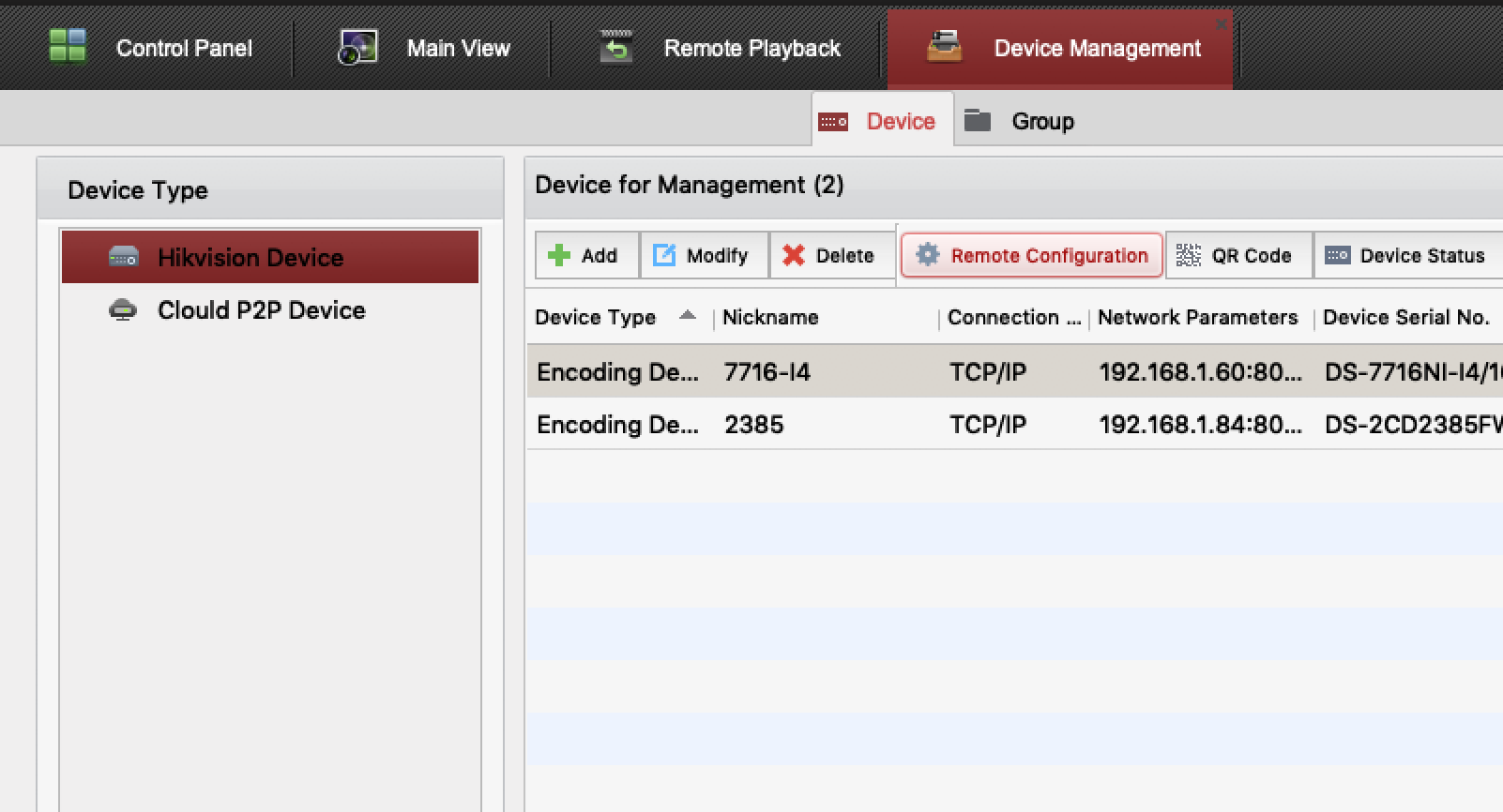

You should be able to do this in iVMS-4200 by going to Device Management, select the doorbell and open Remote Configuration (see below) you should then see all the settings including a Maintenance menu where you can load the firmware.

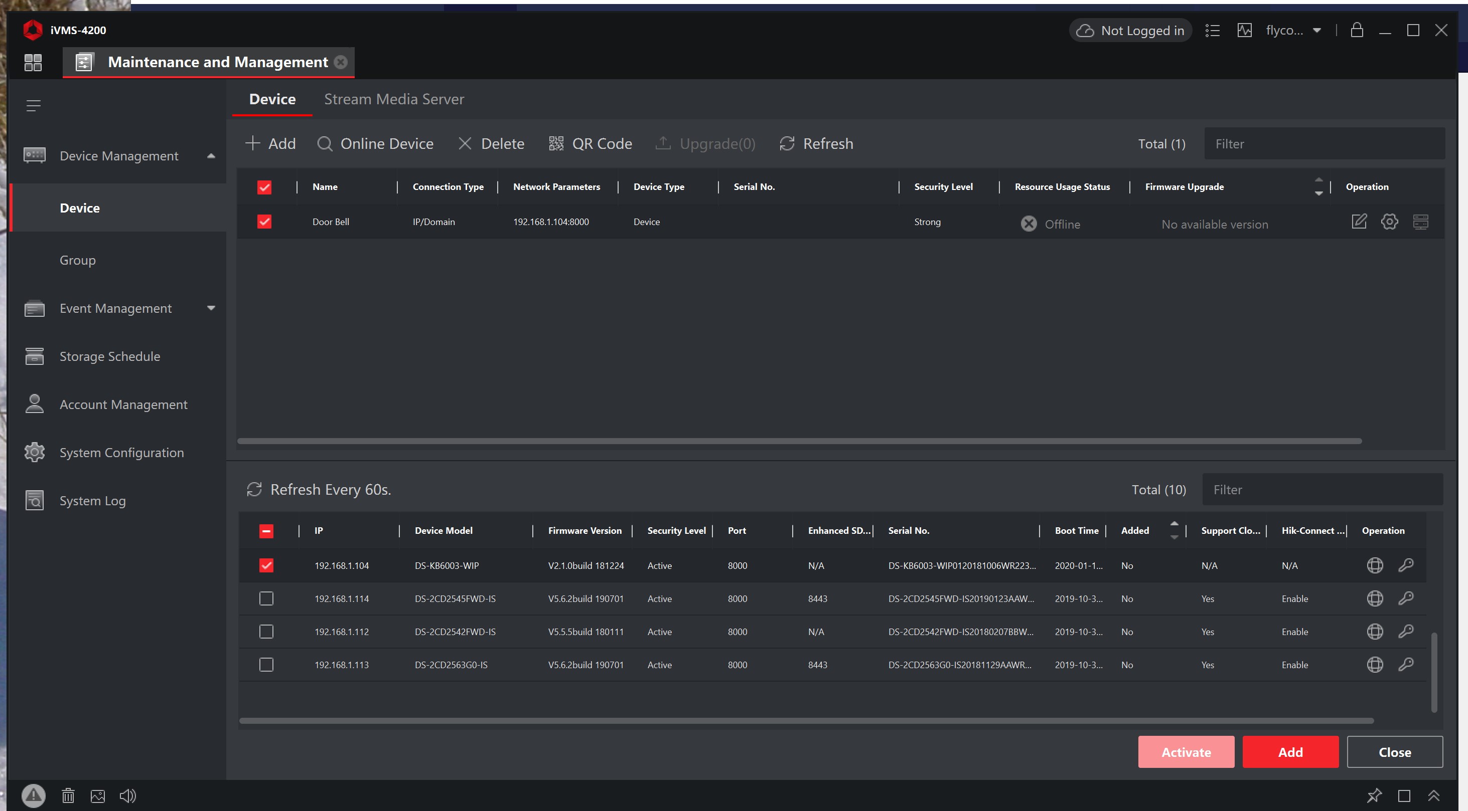

Just downloaded IVMS 4200 but it looks nothing like your screen shot. I found a Tab "Maintenance and Management" but when I click on Remote configuration there is no option for a firmware update.
This is a screen shot of my IVMS4200 page, It keeps telling me my door bell is offline although I can access it through Hikconnect.
It looks like you need to log into the camera with its password to access Remote configuration.
