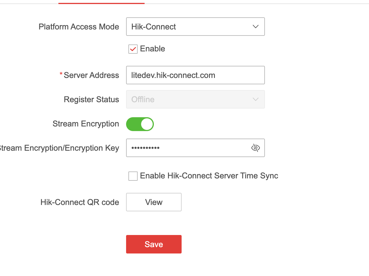

I’m on my NVR directly now and it looks like I have internet but hik connect still saying offline
Have you scanned the barcode on the nvr from the app and reinstalled the nvr to the app?
I have but when it trys to connect to it, it says it is not connected to the network even thought ive tested it and it seems connected to the network. gone into the network page on the nvr tested it.

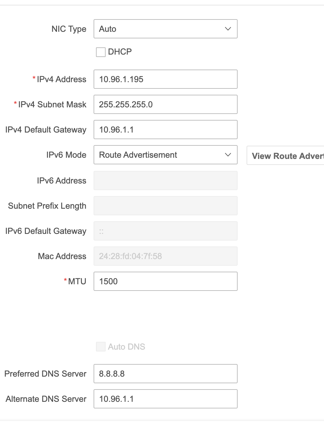

Post some screen shots of network pages and page for hikconnect on nvr. Also app settings page in the app
this is the nertwork settings via IP and they do match what i saw on the NVR and also the hik connect page. There isn't a settings picture to send because i removed the NVR from the app so trying to re add it but that doesn't work because the register status is offline.
Your nvr hikconnect page needs to say online. So that's the first thing to look into
