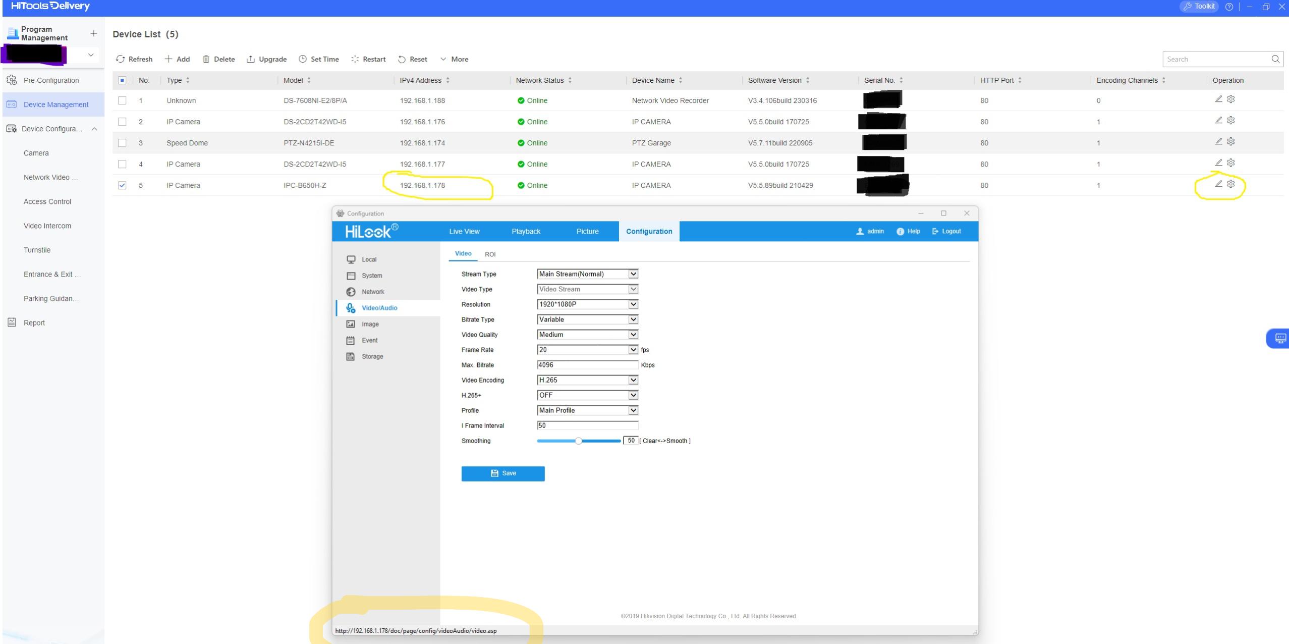

If you install HiTools Delivery it will see all your online cameras.
You can see the IPC-650H Z circled.
1. Tick the box on the left
2. Click on the setup cog circled on the right
3. You will get the Config pop-up screen which you would have normally got if you accessed by browser.
4. You can see by the IP address path circled at the bottom of the screen that HiTools delivery does access via the IP address

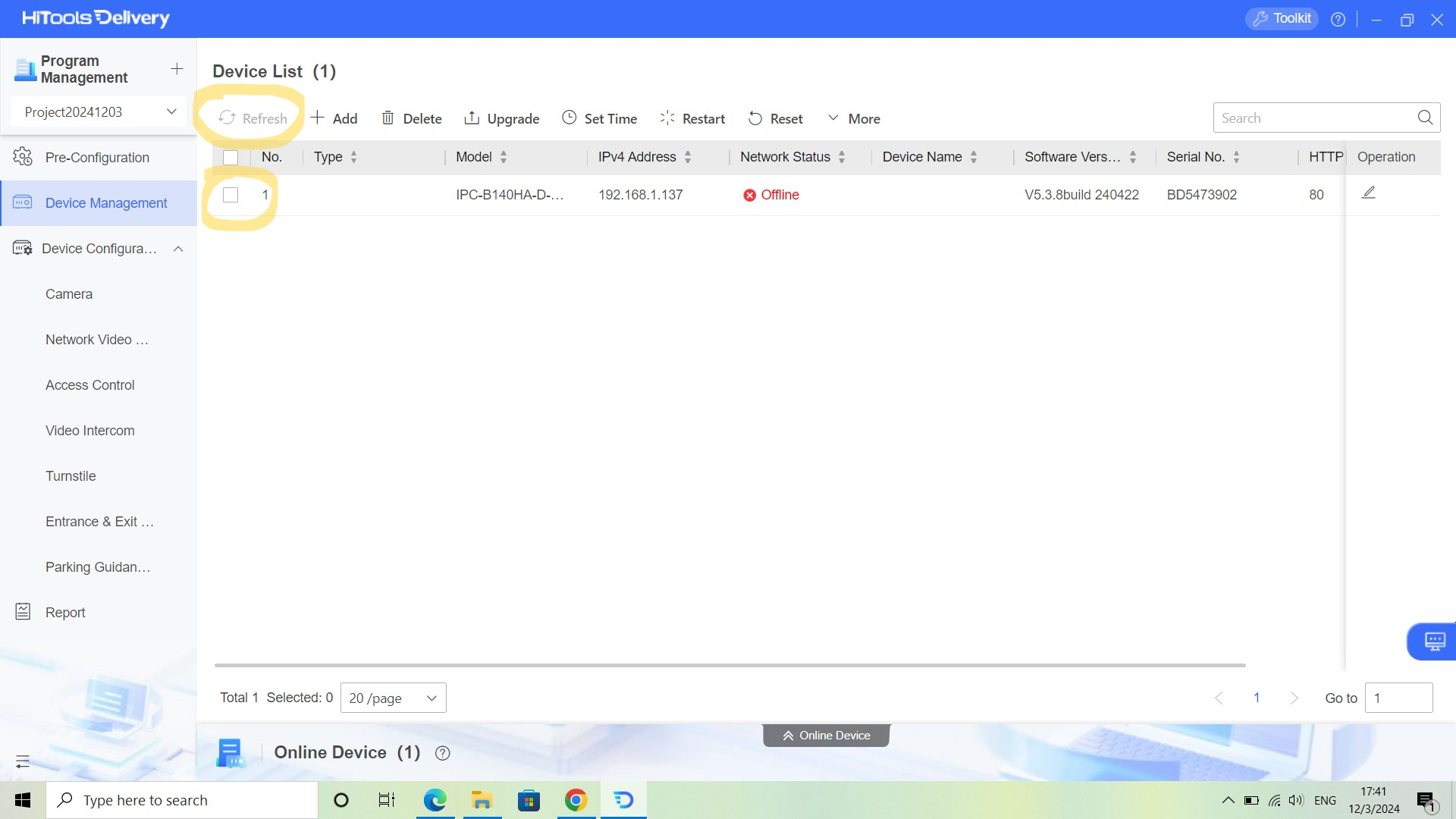

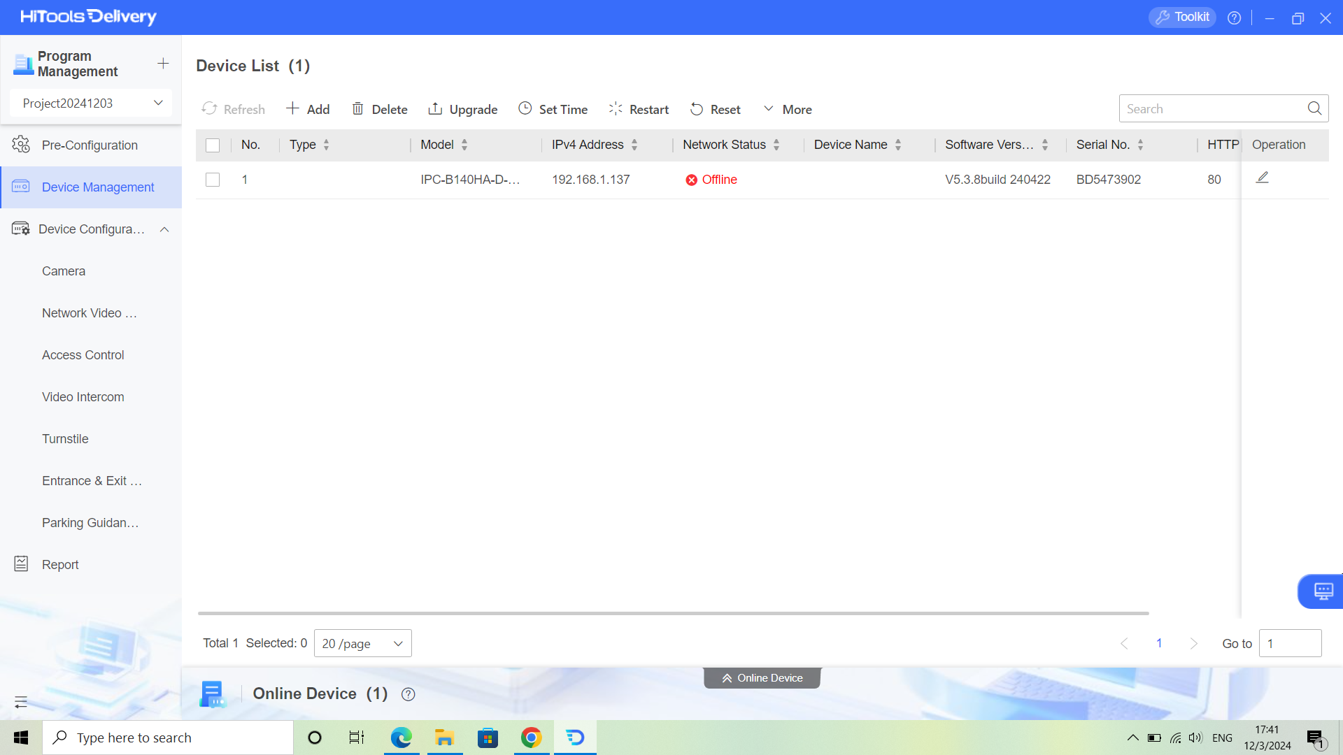

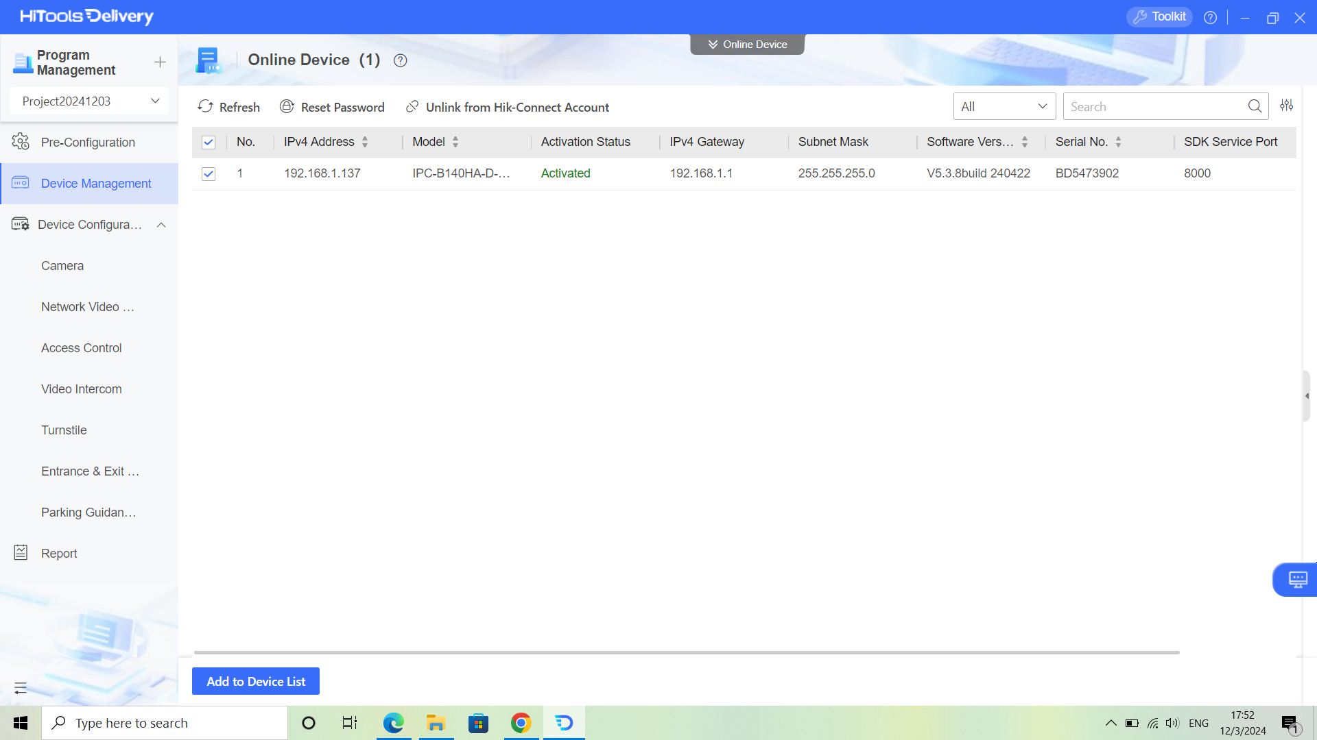

Click add device to list and then try from there-
Also why in SADP is your IP address for the camera 192.168.1.226 ? Have you changed it manually or are you using DHCP to get the 192.168.1.137?
Have you checked your Network and IP leases? Are you clashing with another existing IP address ?
Try DHCP instead
