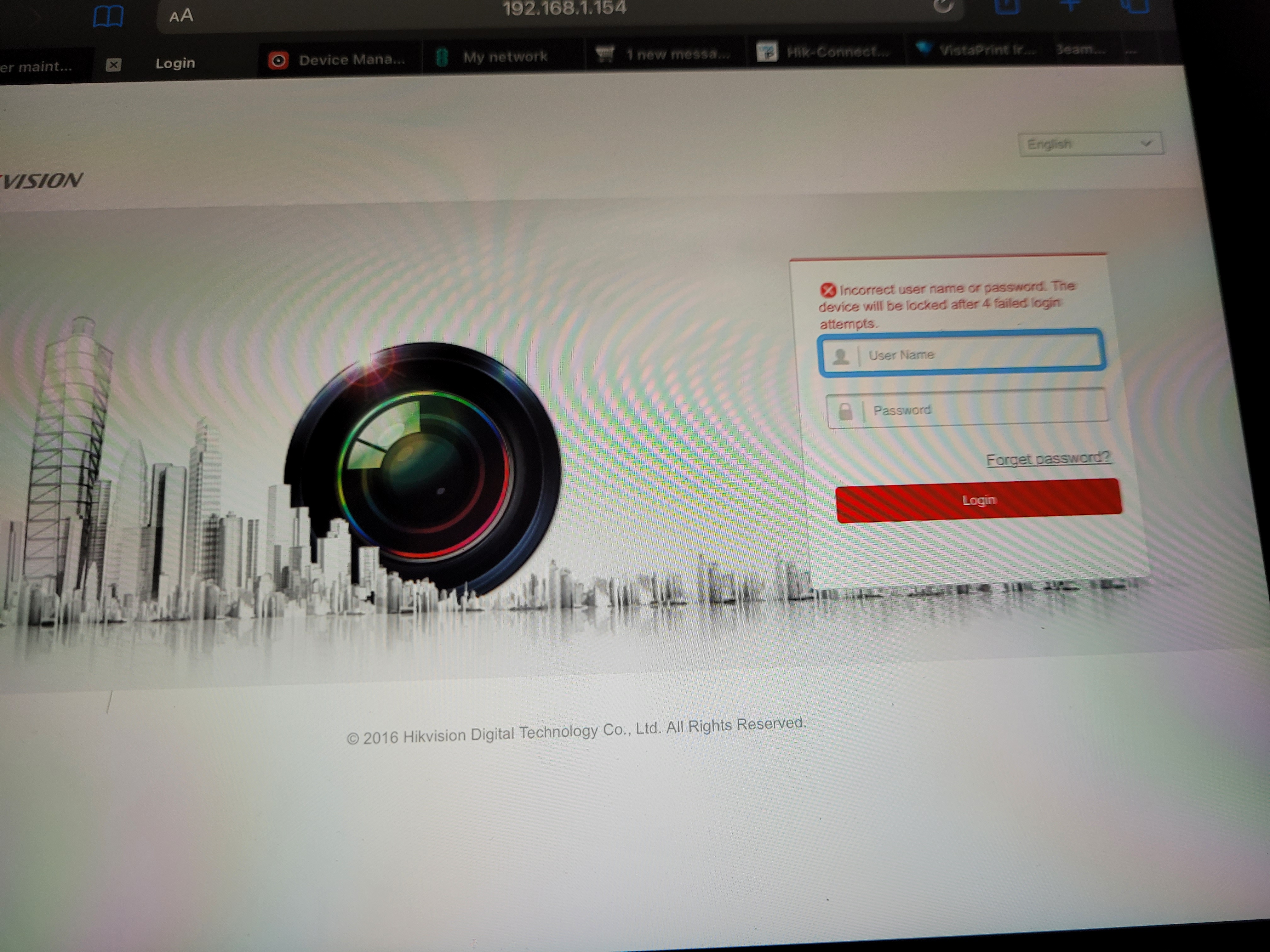

Hi I put my user name and password in and this is the response I get

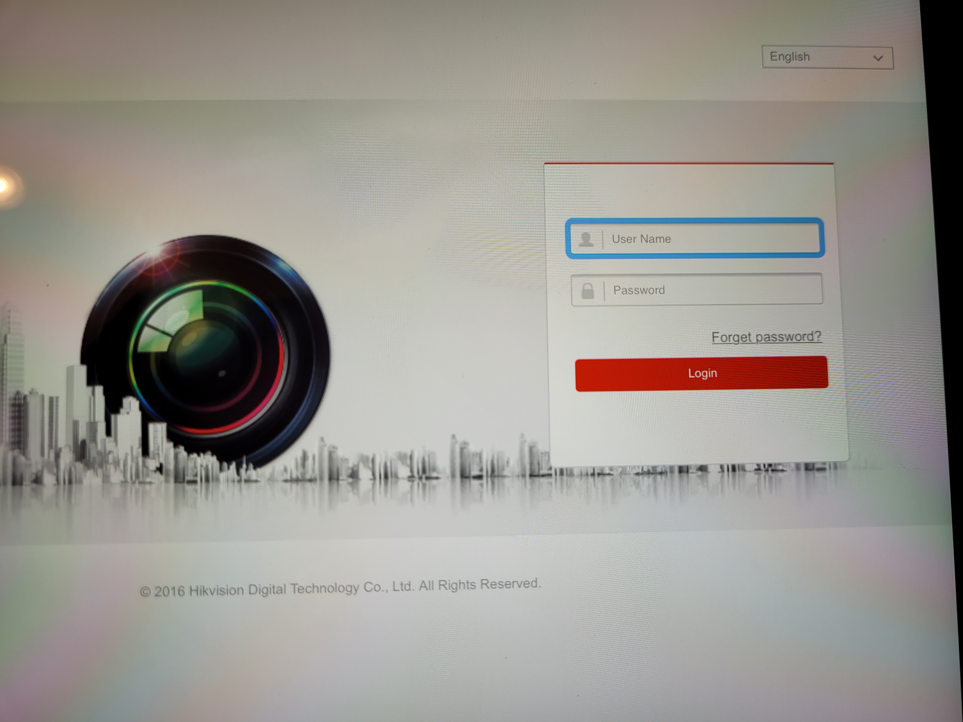

Hi it is not the camera I have reset it is the nvr box to then put new passwords and new user name in
Then I have tried to log in using the new iser name and password and it won't let me

What browser are you using when trying to log in to the NVR?
From your screenshots it looks like Safari, can you please try logging in using Chrome?

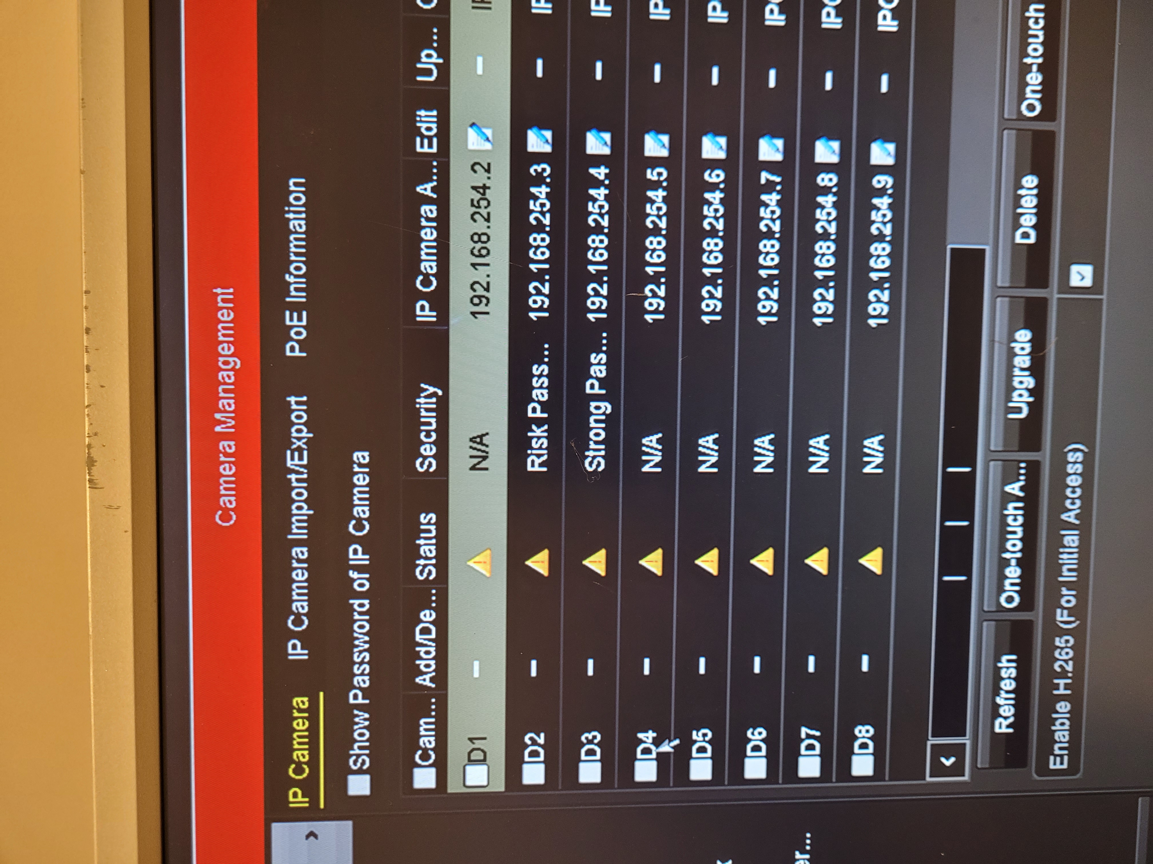

Also if I reset the camera will that also get rid of the yellow triangle ⚠️

The yellow triangle is a notification that there is an error with the camera connection, if you click on the triangle you should get a little window confirming what the error is. (most likely that the password does not match)
Once you have the password set correctly the cameras should connect with the NVR and the triangle should go.
