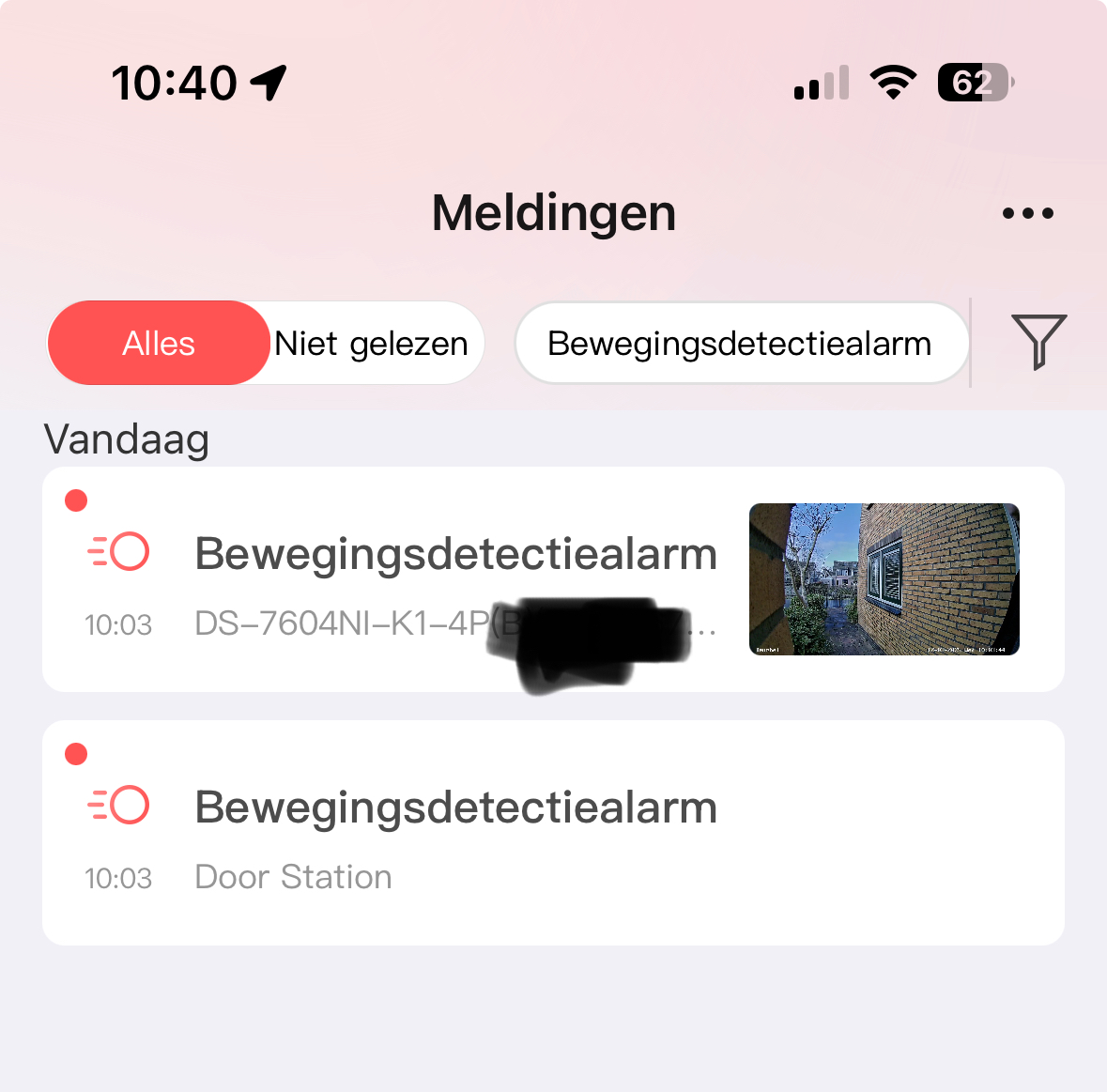

I have the doorbell connected to nvr as well. So doorbell notifies with single photo and nvr with the corresponding video.
Also check on intelligent notifications and that you have set the area of which you would like to check.
When someone leaves the door or enters the door the notifications will pop up. If someone rang the doorbell, the same screen pops up, and when answer the call you will see live view within the app.

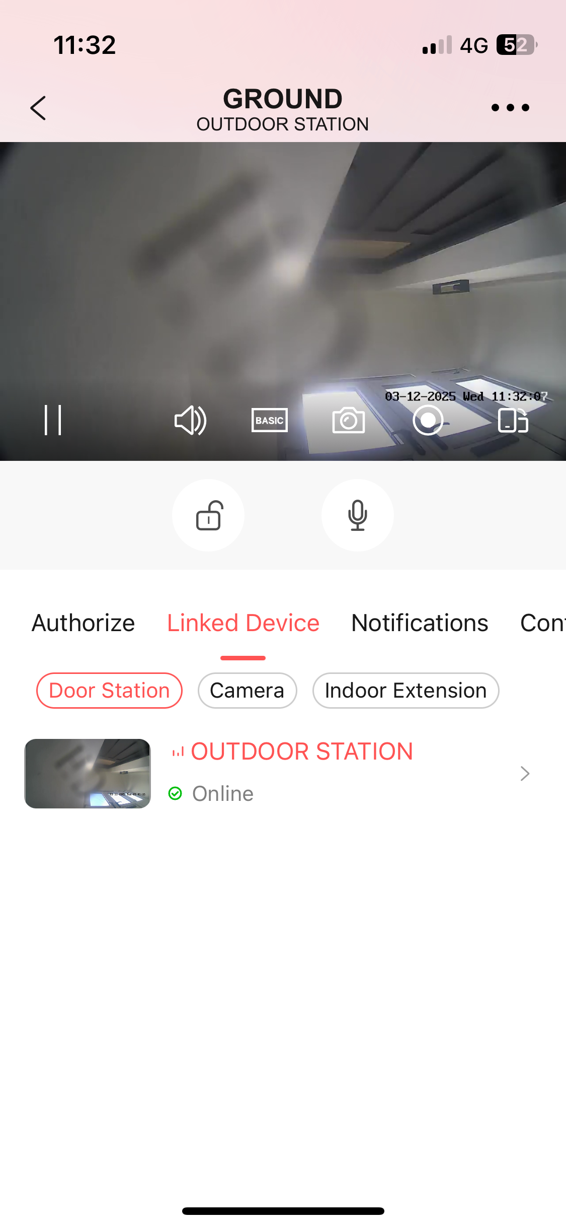

Hi MTV, I was advised to remove the doorbell from the app, instead the outdoor station (which the doorbell is linked to) needs to be the only device in the app.

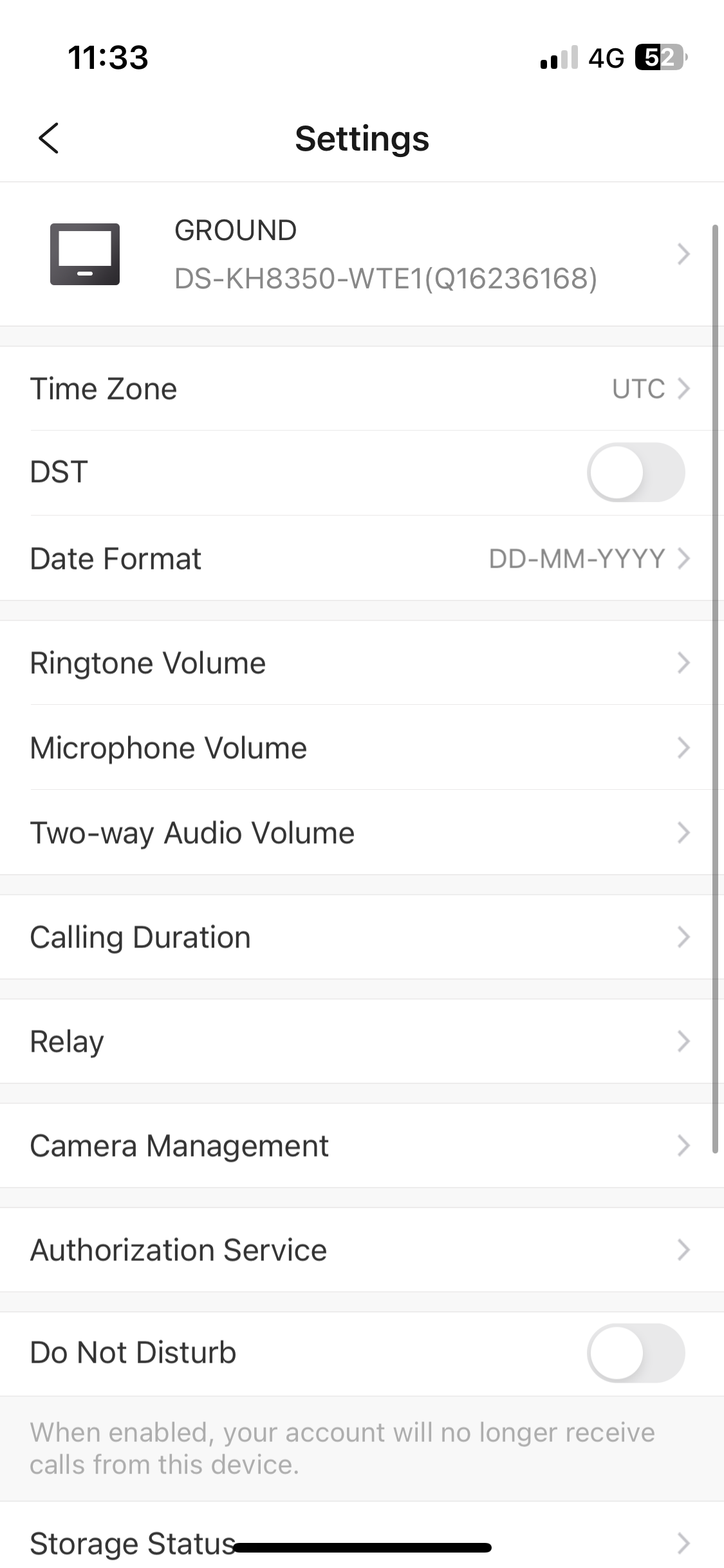

It does have enable and notifications set under Me -> Settings -> Noticiations, as for device settings on the app, there is no option you mentioned under the outdoor station (see attached) ,although was there if and when I add the doorbell into the app - When door bell is pressed, I do get a pop up notification (The first image i sent), but without a still single photo.
intellegnet notification, I believe is not yet fully configured ie mapping the zone but want to - I am first trying to fix this single photo notification.

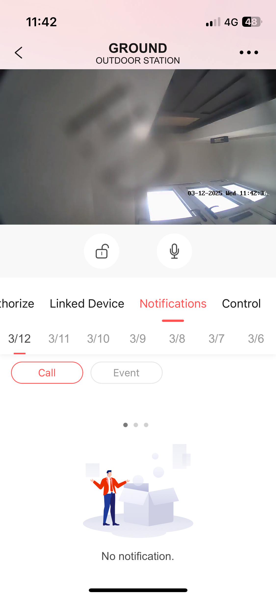

Also interesting, I made a call, answered, then under the notification tab, it doesnt show anything under call or event, the 3 dots keep cycling around and around, see attached

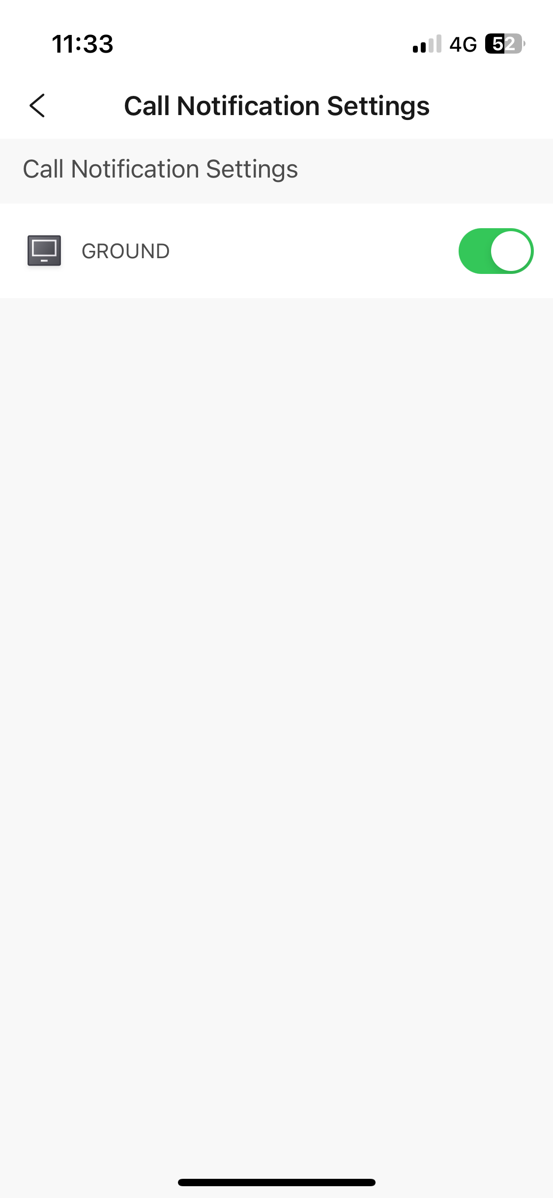

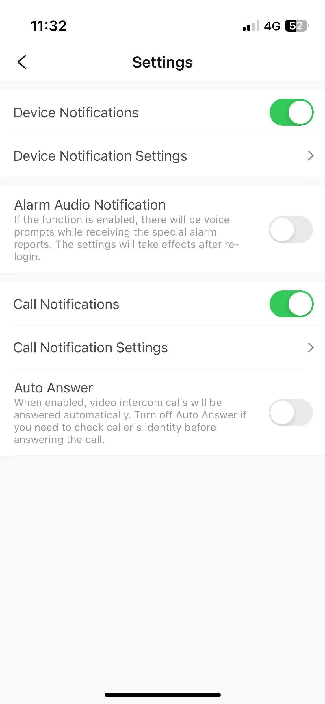

I think that only applies to motion notifications. My 6113 has Notification set to 'Disable' and Report Events is turned off and yet I still receive calls directly to Hik-Connect. To receive calls and call notifications including the snapshot, all you need to have is 'Call Notifications' set to on and 'Call Notification Settings' > Doorbell turned on in Me > Settings

You can only try to see which gives you the best results. I've lost track of what the original issue was! I don't think you can get a preview image on the phone until you swipe the app open when the door station calls - at that point whether it immediately connects or gives you the option to connect/reject is dependant upon the Auto Answer option. It's been that long since I had an indoor station that I can't remember whether I got snapshots for the caller in Hik-Connect when the indoor station was on Hik-Connect.
