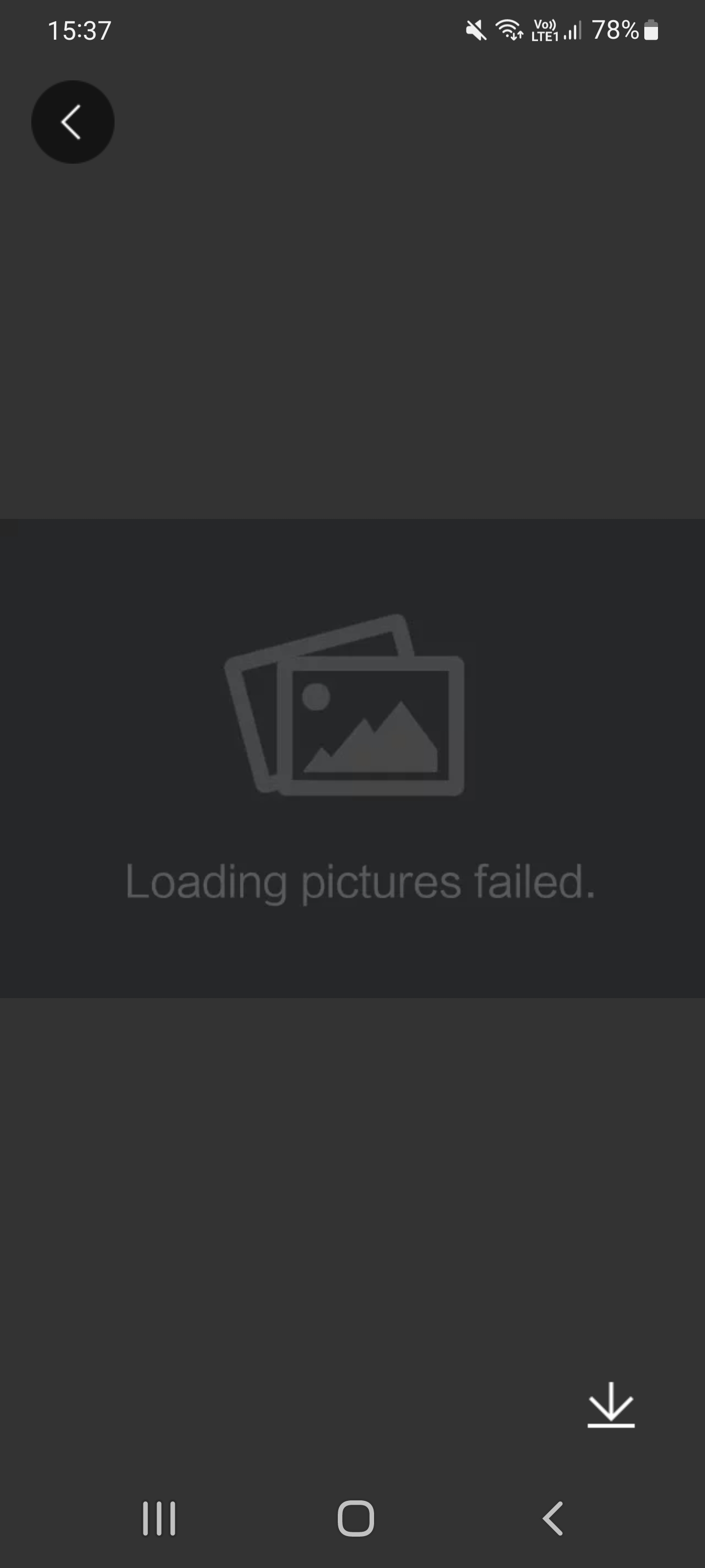

Since the update my Hikconnect has also failed to show thumbnails, it did before

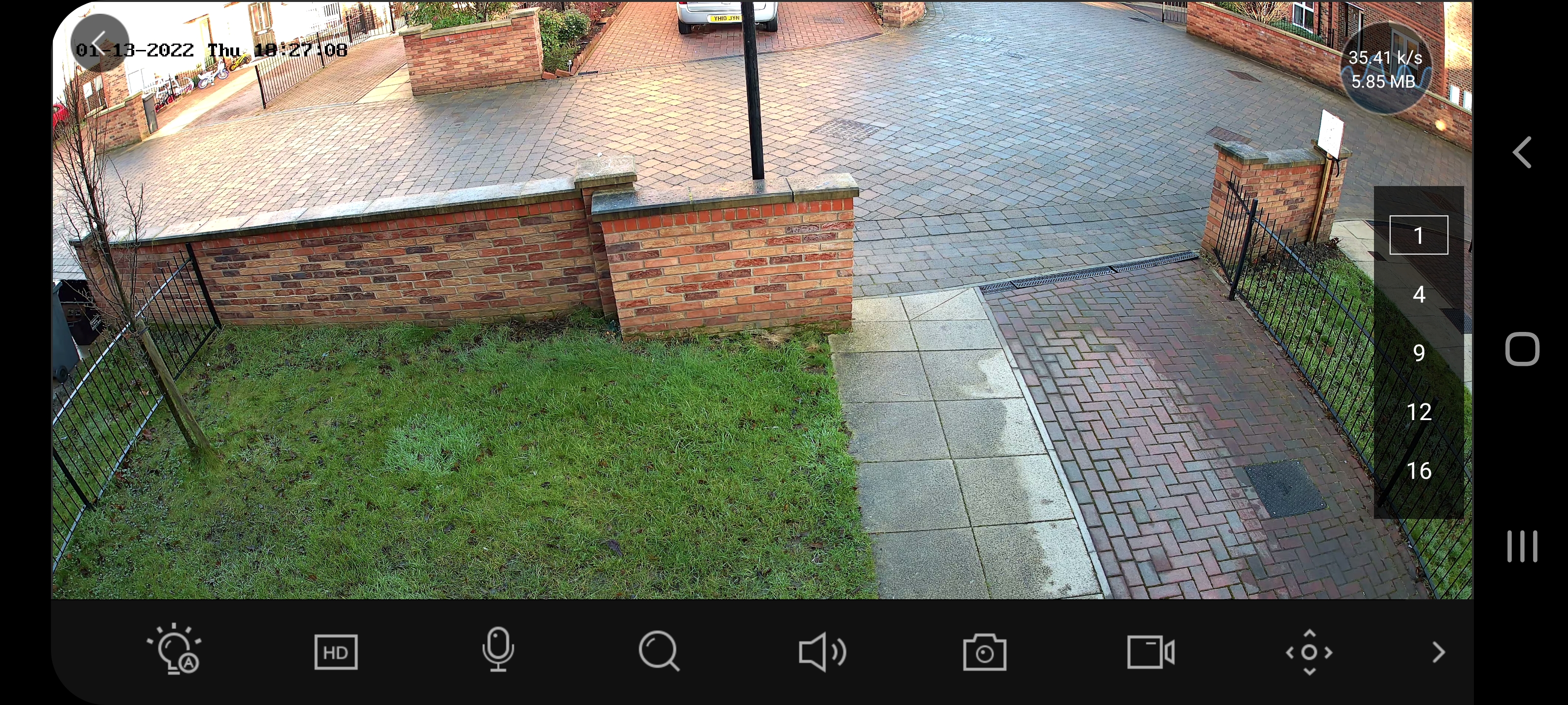

Update. Green screen is gone. I got the app back. After getting the app back online through the nvr.
Crossed fingers it is. Was panicking for a while. But I can now log in on a Web browser and the app again. In the app it loaded up in HD with out the green screen.

My hd on my 8mp now. No green screens.
I just need to get my notifications working again. I get live view but not notifications lol. Seems like a bit of investigation is needed.
