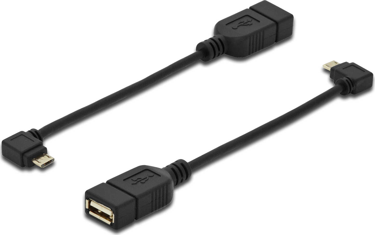

I have a semi-solution for DS-KH9310 indoor unit; The back panel has a micro usb port that means you can connect an external microphone and automatically Android uses this microphone as the main one. I managed to do an experiment using the following:
1. Using the following MicroUSB (M) to USB-A (F). Please note the angle of the MicroUSB
The MicroUSB cable must be capable for OTG else it will not work.

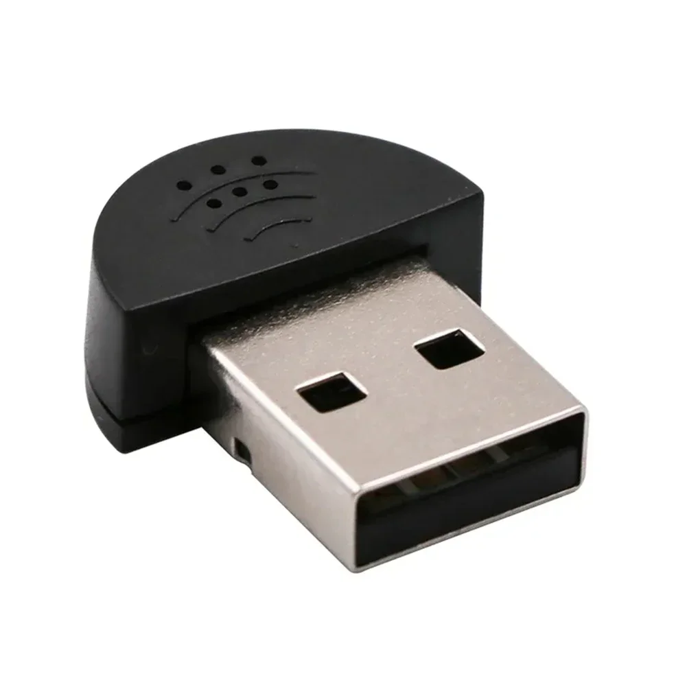

2. Plug a small USB A microphone
USB-2-0-Microphone-Portable-Mini-Omni-Directional-Stereo-USB-MIC-for-Laptop-PC-Computer-Chatt...webp
The sound was much better and completely different than the unit's microphone.
( Most of these products can be found at your local electronics store (and/or AliExpress) or you can create a custom one by chopping down a MicroUSB OTG cable and a cheap microphone and later do the connections)

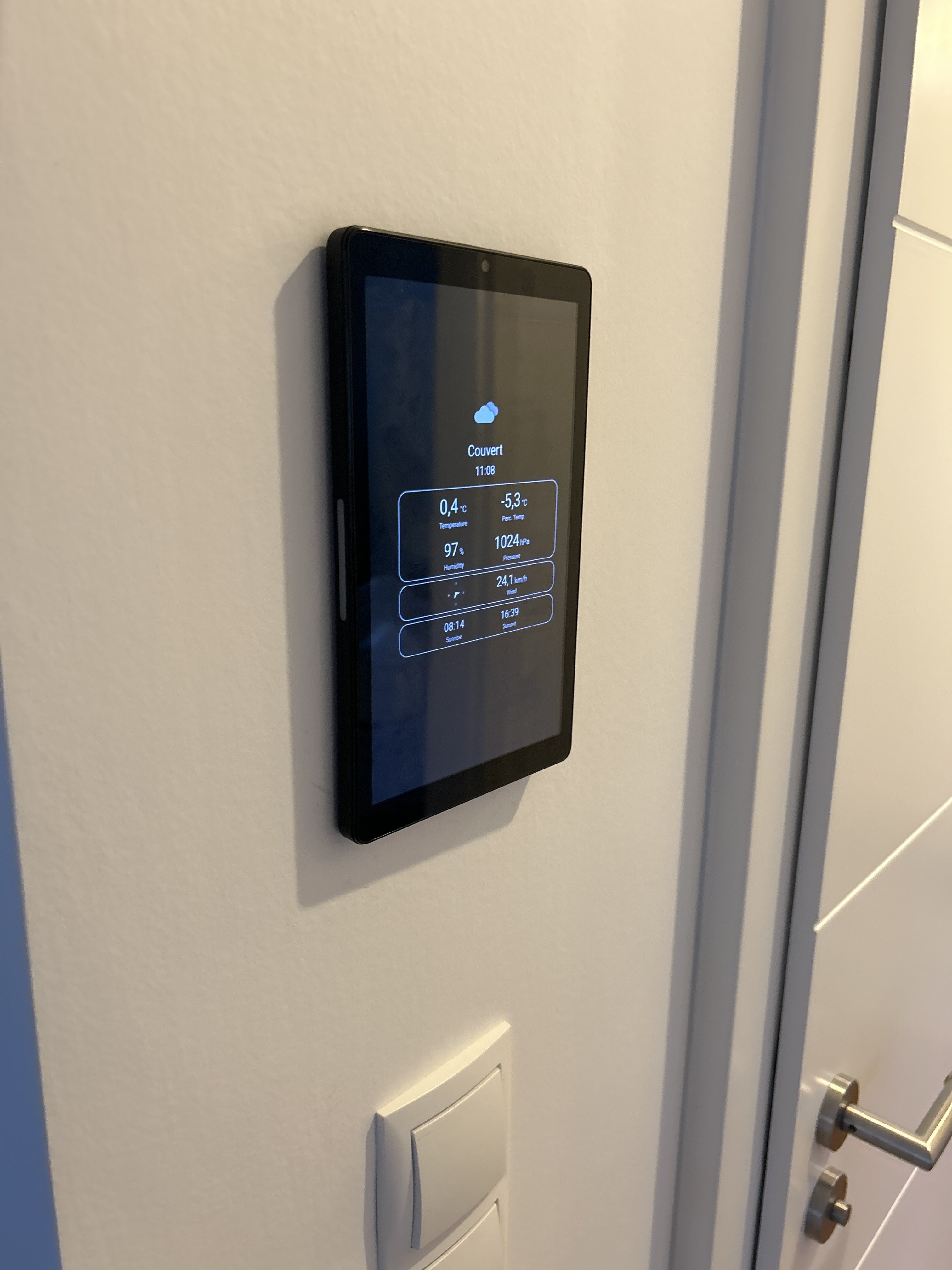

Hello,
An update on my side. So I returned the indoor station and got refunded.
I ordered a wall mounted Android tablet YC-SM08P (link) which I bought from AliExpress (it exists in black or white, with 2Gb or 4Gb RAM).
I installed HikConnect app on it (the unit is delivered rooted with an « su » on the system so HC complained about rooted device. I just removed the su and switched Root off from developers options and it worked).
It all works perfectly well ! At the end of the day I now have a way thinner / more modern screen on my wall, which is a full Android 11 responsive tablet, which receives the calls from the outdoor unit very quickly and answering from it works perfectly with two ways audio.
I have been able to install all the apps I regularly use to manage the house (digital thermostat, Sonos app, UniFi camera monitoring system m, …) which now gives easy and convenient access from the house hall, which is much appreciated by my wife who did not like having to use the phone for this and that.
My main screen is the family agenda, with all tasks and appointments for the days (useful with 3 kids), and a random family picture from Google Pictures widget.
Also I have setup a time/weather screen saver which gives a nice and useful information all the time (from Here).
It is soooo convenient, without its limitations and way nicer that the HikVision indoor station … and for less money (you can find wall mounted Android tablets under 200€, I paid the YC-SM08P around 180€ VAT included).
I hope this helps.
