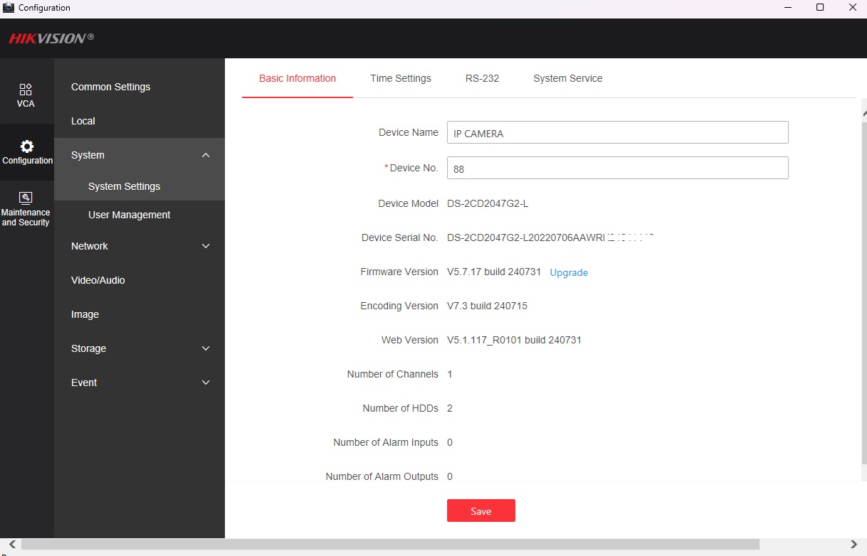

Firmware New firmware V5.7.17build 240424 for ColorVu G5
Updated on 5.7.17_240606
Motion Detection is not working at all on DS-2CD2047G2-L and Acusense DS-7608NXI-K2(V4.82.100build 240606) with previous settings
Increased Sensitvity to 100, there is Detection, but motion Event is not uploaded as VCA.
Enable Dynamic Analysis for Motion is now renamed to Enable Dynamic Analysis for Face Detection(was from previous "temp" firmware)
Enable Dual-VCA is Enabled on camera(Display info on stream seems OK on NVR)
Save Camera VCA Data is enabled on NVR.
Performed a Restore to Defaults and imported a previous Device Parameter backup file, but issue remains the same
I 'm going back to 5.7.15
A mess once again

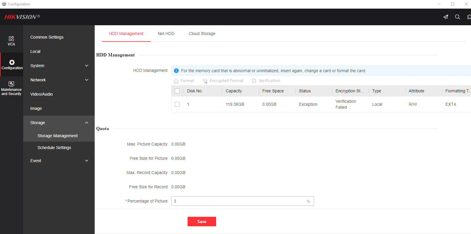

I cannot know if the reason is the below:

My SDcard was encrypted. But I cannot understand the relation to VCA upload on NVR HDDs

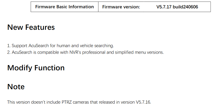

New release notes. A very detailed information from the new author!!!!

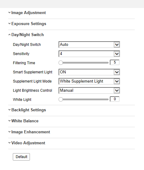

@alfaclvi - Am I right in thinking you have these G5 cameras connected to a NXI-K NVR on 4.82.xxx? If so could you possibly check whether the Smart Light Compensation is there/working in Hik-Connect (light bulb icon with letter A). I installed a system today and the icon didn't appear on the customers app at all for some reason despite the cameras having the feature (could just be a temporary glitch)
Hi @JB1970
Yes this works on NXI-K v4.82.100 build240606 and on ColorVu DS-2CD2047G2H-LIU V5.7.15build 240411 and Hik-Connect v6.120.0103 Android
Below is my configuration, if that helps:

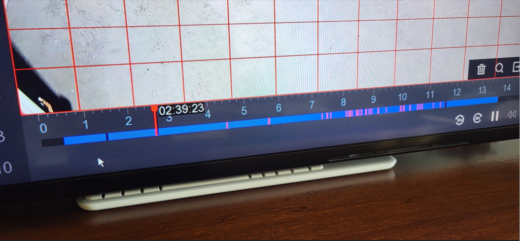

The results in the timeline displayed respect the AcuSense filter in the camera (in my case only Human events are shown in the Smart search area)
Hi @JB1970
On NXI-K NVRs there is no selection(no icon buttons) for Human and Vehicle when on NVR GUI I select Playback-Event-select(double click camera)-click Space Rule-perform either Draw Motion, Draw Intrusion or Draw Line Crossing. So this is impossible to deselect(uncheck)!!! (see the mouse cursor area on picture and the timeline after the 11:30 gap).
Those two buttons(Human and Vehicle) exist only in Playback-Normal-check the camera you want to search, but only for two things. Intrusion and Line crossing(possibly Intrusion includes Region Entrance and Exiting).
So the Playback-Event for Normal(Motion) search by Rules is impossible.
I reinstalled 5.7.17 to check again. Same problem, but what I noticed is that by the time 5.7.17 is installed the Normal(Motion) Events are recorded but they cannot be found. This was possible to understand when reinstalled 5.7.15, performed the Rule Playback search and by surprise, all Motion Events that where recorded when on 5.7.17, could be found.
So this is possibly an incompatibility with latest NXI-K firmware v4.82.100 and if so this must be fixed.
I also took the risk to install firmware v5.7.16 which is similar to 5.7.17, but the problem exists there too.
I hope the new firmware for NXI-K will solve this issue.
