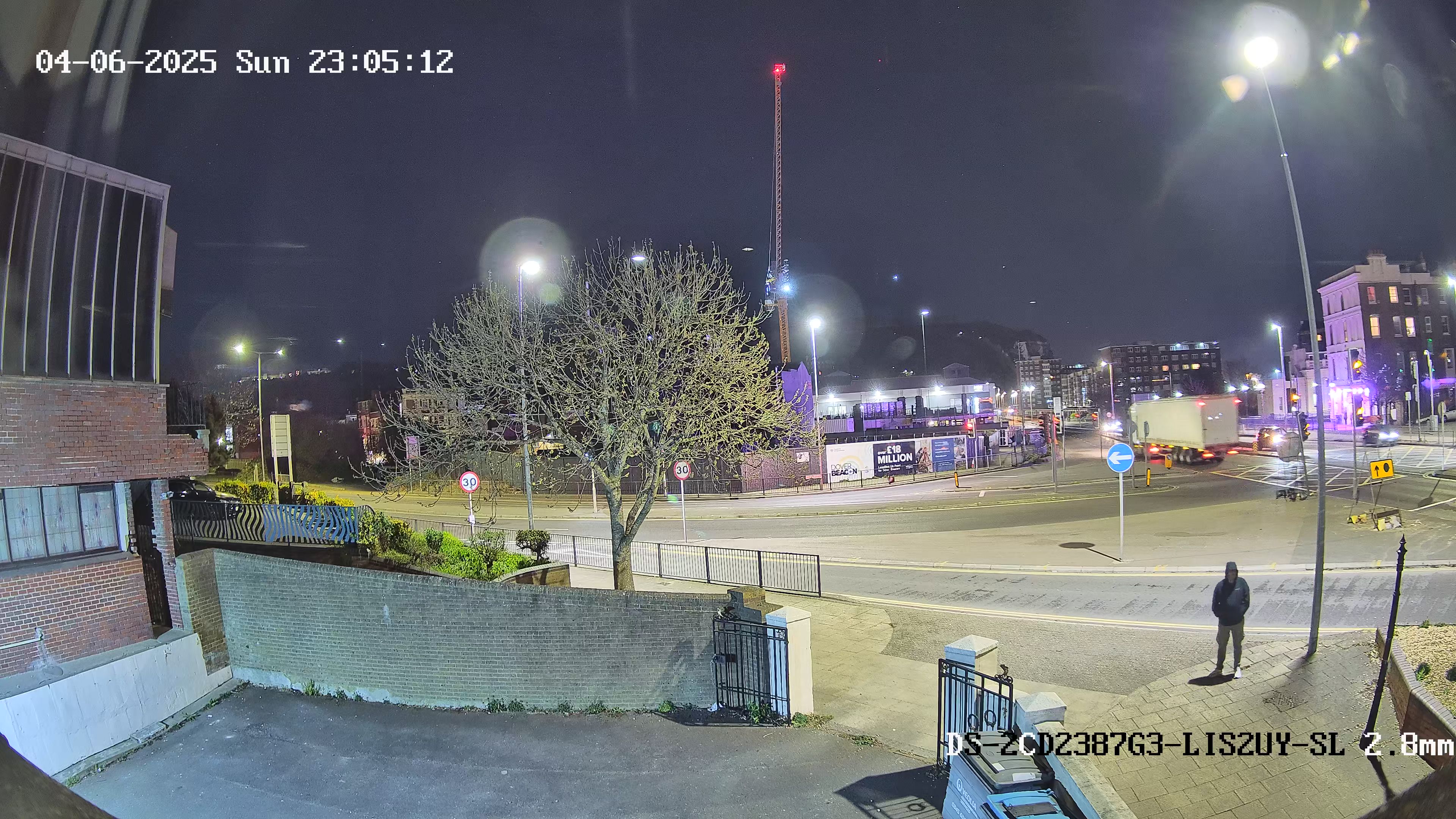

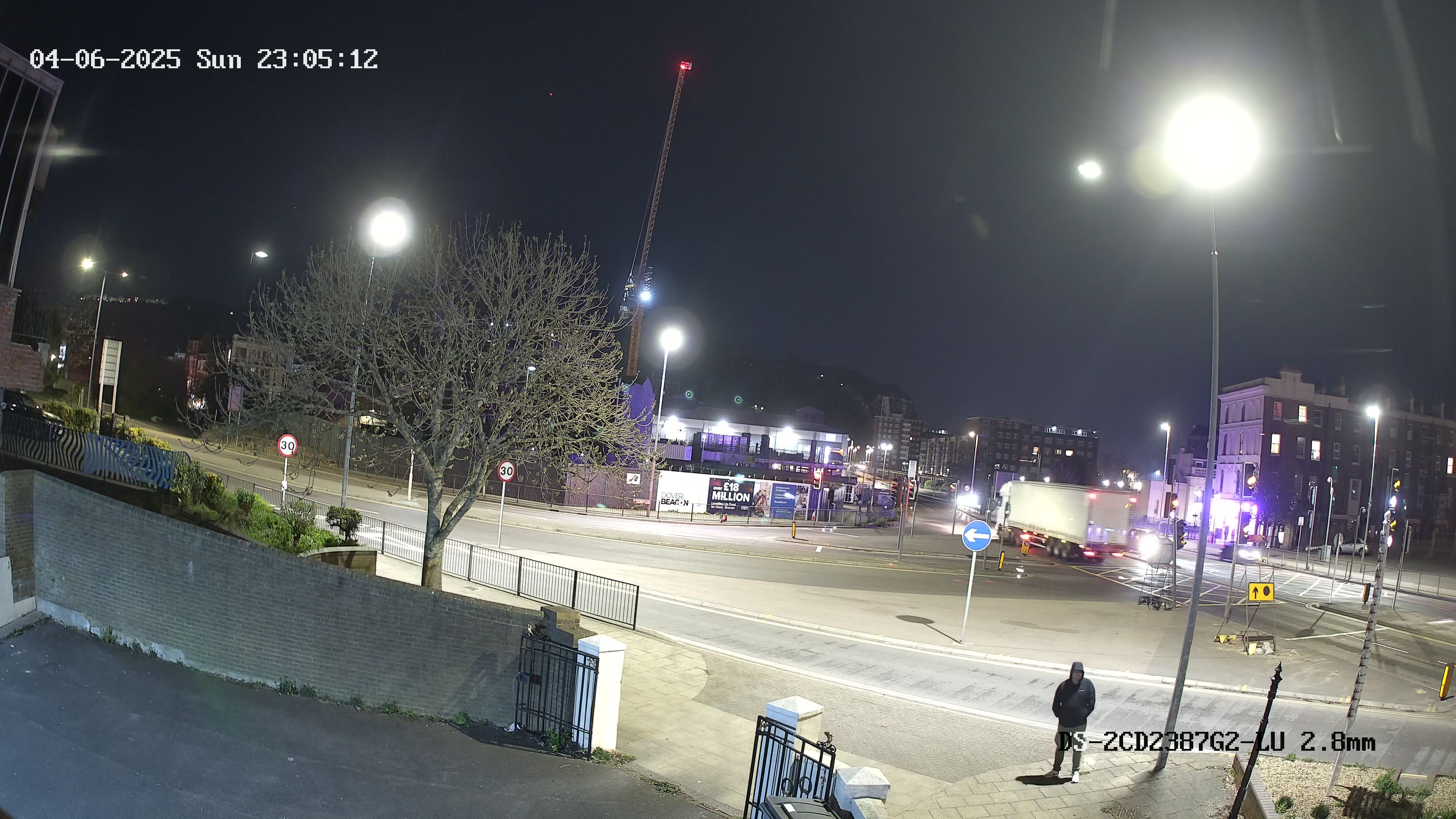

regarding the video noise, I was referring to the images and video footage posted by @Kyle , these are both 8MP cameras 2387G2 and 2387G3 and to my eyes the G2 produces less noise and blur compared to the newer G3 model.
I’ve not looked at that video but IIRC the cameras were viewing through a window and were at default settings. Any camera will need image settings adjusting to get the best out of it. I doubt you will be able to make an accurate comparison without trying one yourself.

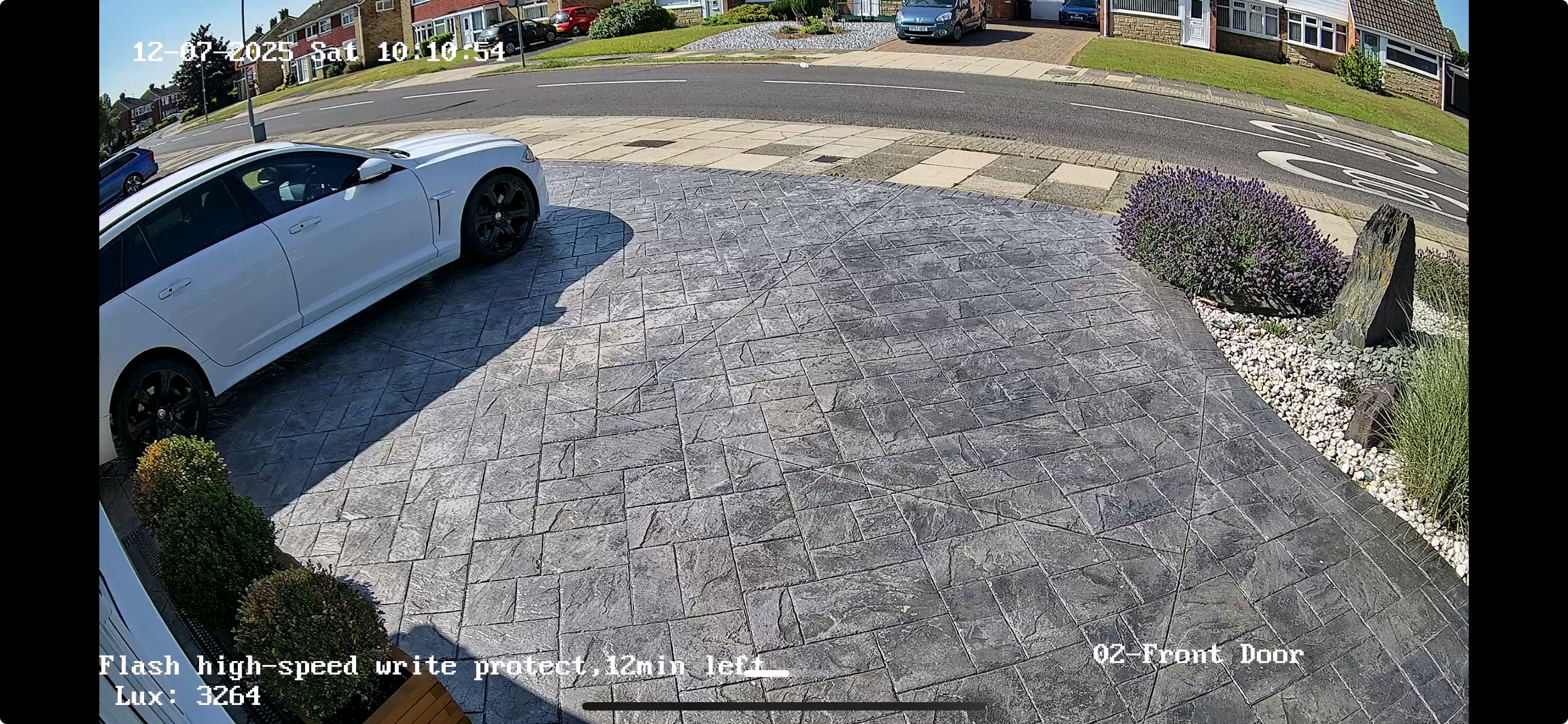

Well, the "Flash high-speed write protect" message is back again. Looking through the playback this just appeared with "12 minutes remaining". Previously it counted down from about 14 hours (expressed in minutes). I'm not sure whether the camera is just knackered after a couple of months or this is some bug. An internet search reveals nothing:
Are you using an sd card ? The message could be referring to the storage media that the camera is recording to.
I ordered 2x 8MP G3 and I’m waiting them soon.
No - this camera has no SD card so I can only assume that the message relates to the cameras built in flash storage. I'll contact the suppliers technical support early next week and will return it if the cause cannot be explained.

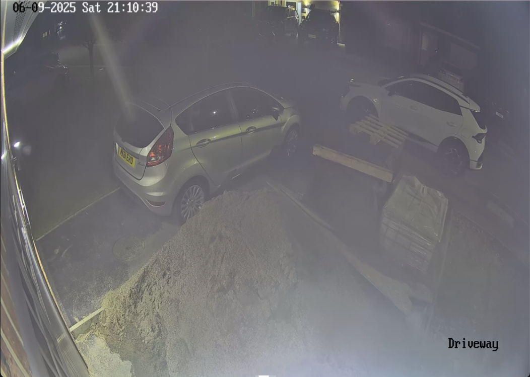

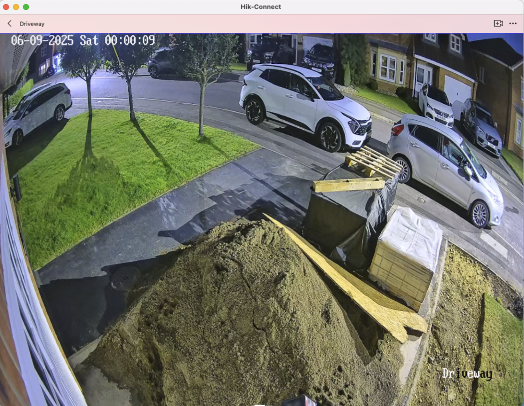

Evening JB , wondering if you or anyone else for that matter could advise me on the best way to combat this problem is to have with my G3. Ive only noticed it these past few weeks with the dark nights rolling in now.
How would you best get around having a good picture with both my outside lights on and off, or is it going to be a case of you cant and have to manually change it every time?
Here is a picture of what it is like with my lights on , and off , Thanks.
