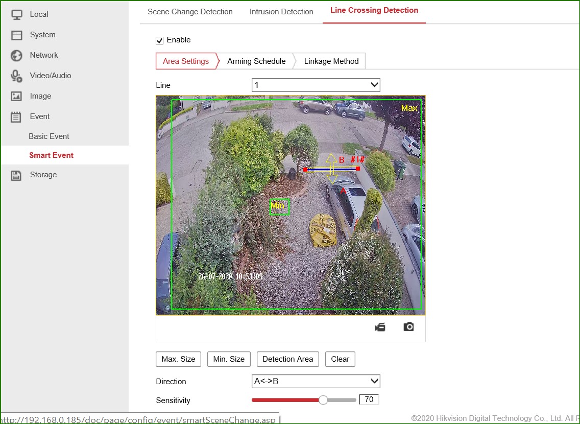

Cleared all previous line crossing/intrusion configurations. Made a new single line crossing. Also, made two new motion detection. Walked through all regions several times. Nothing! Should I start looking at the other system tabs? Or put my old camera DS2CD 2342WD-1 back up. It did motion detection/line crossing/intrusion everyday for 3 years.

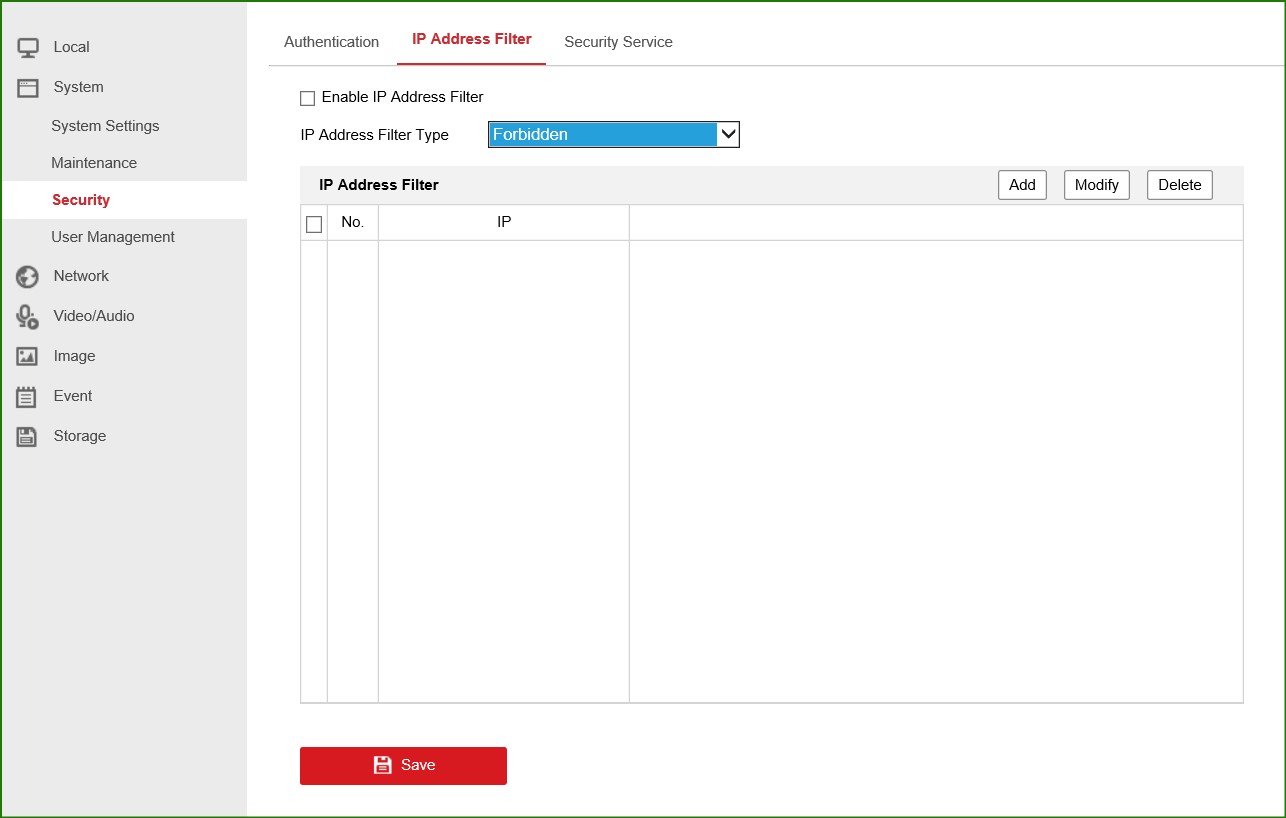

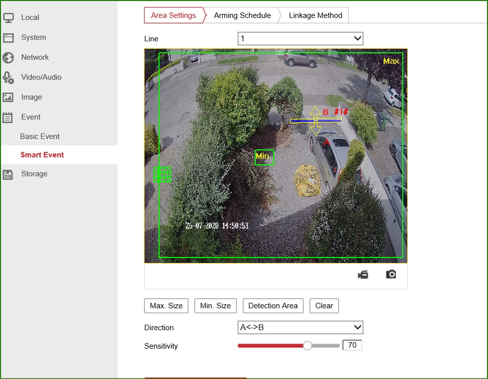

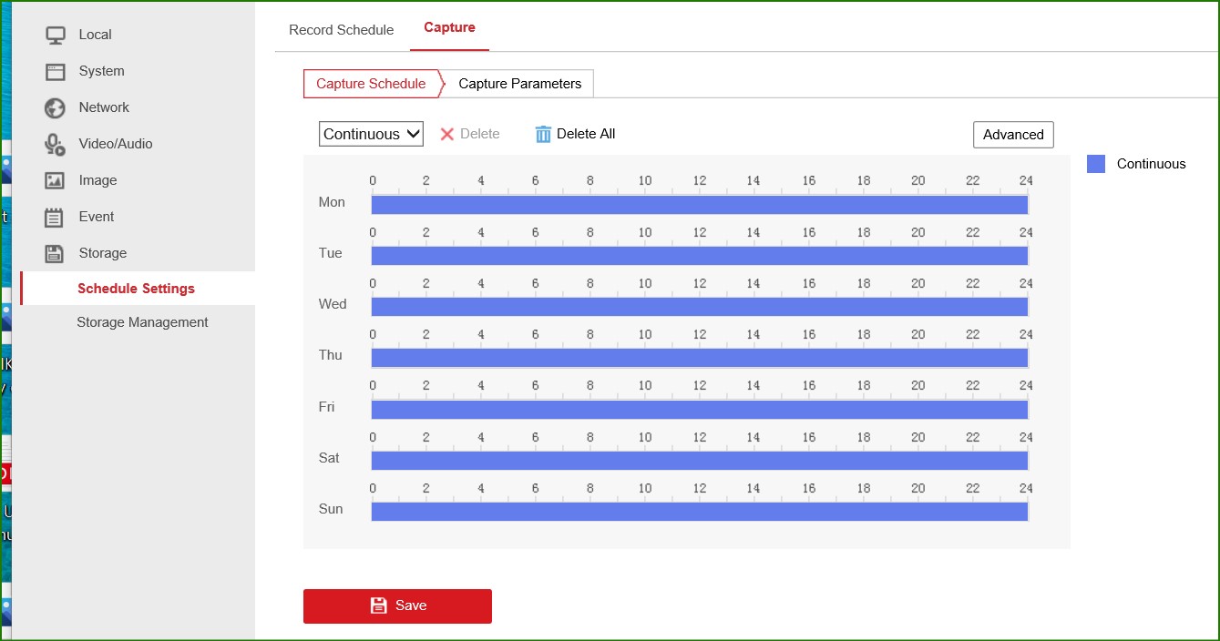

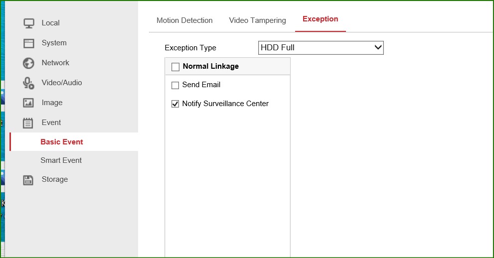

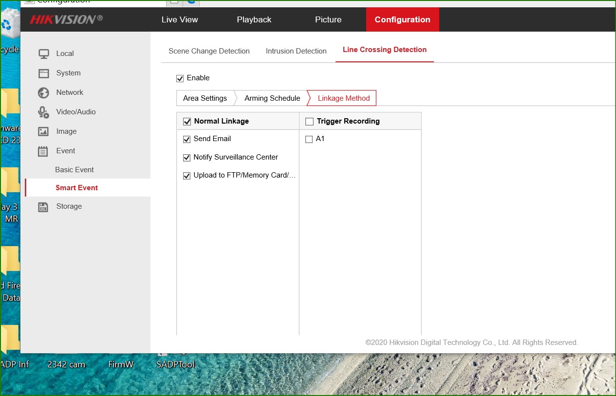

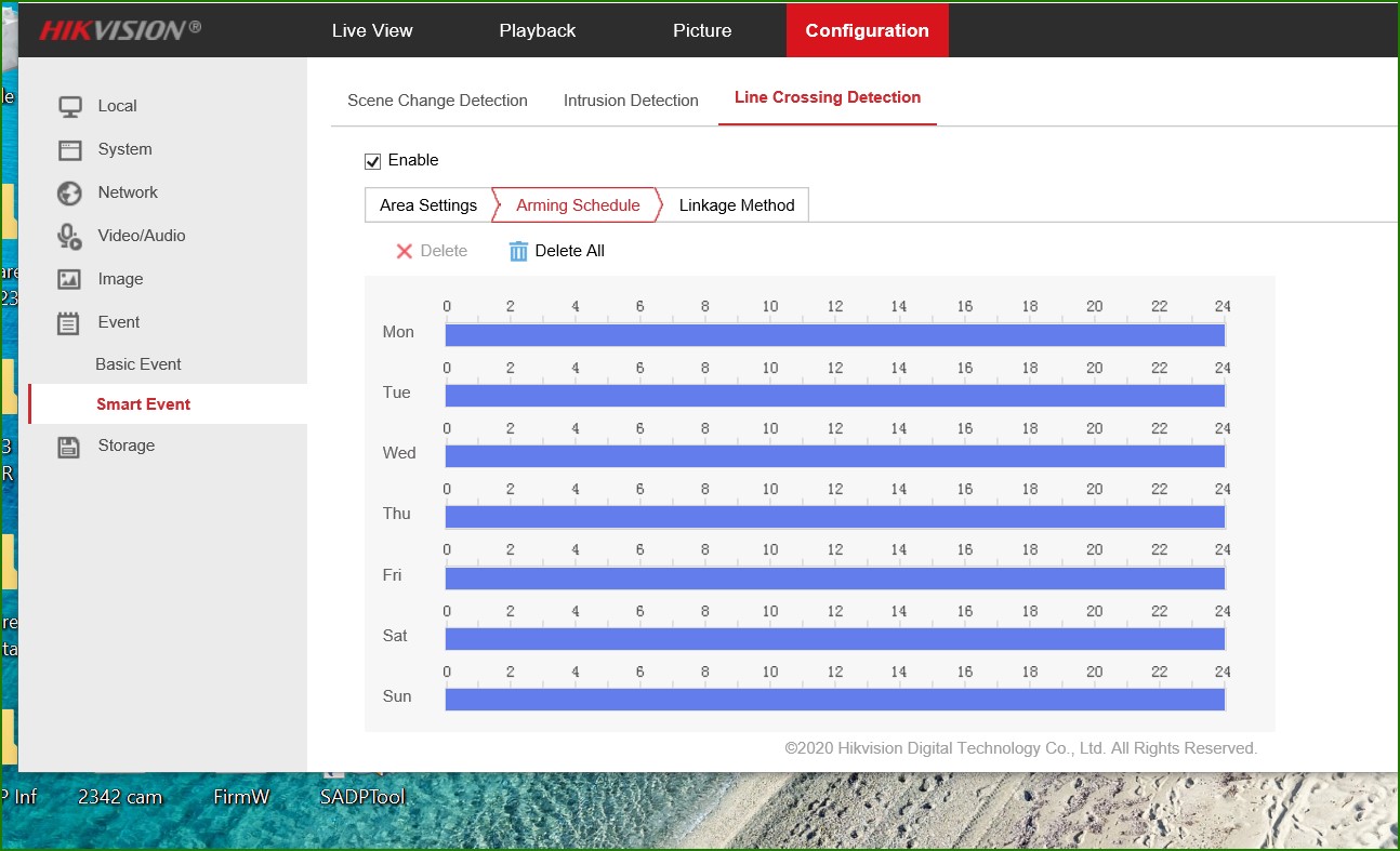

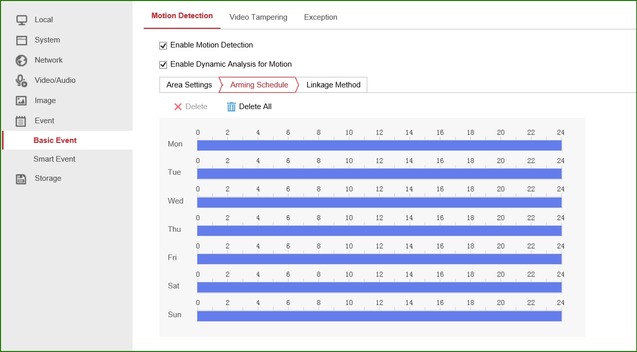

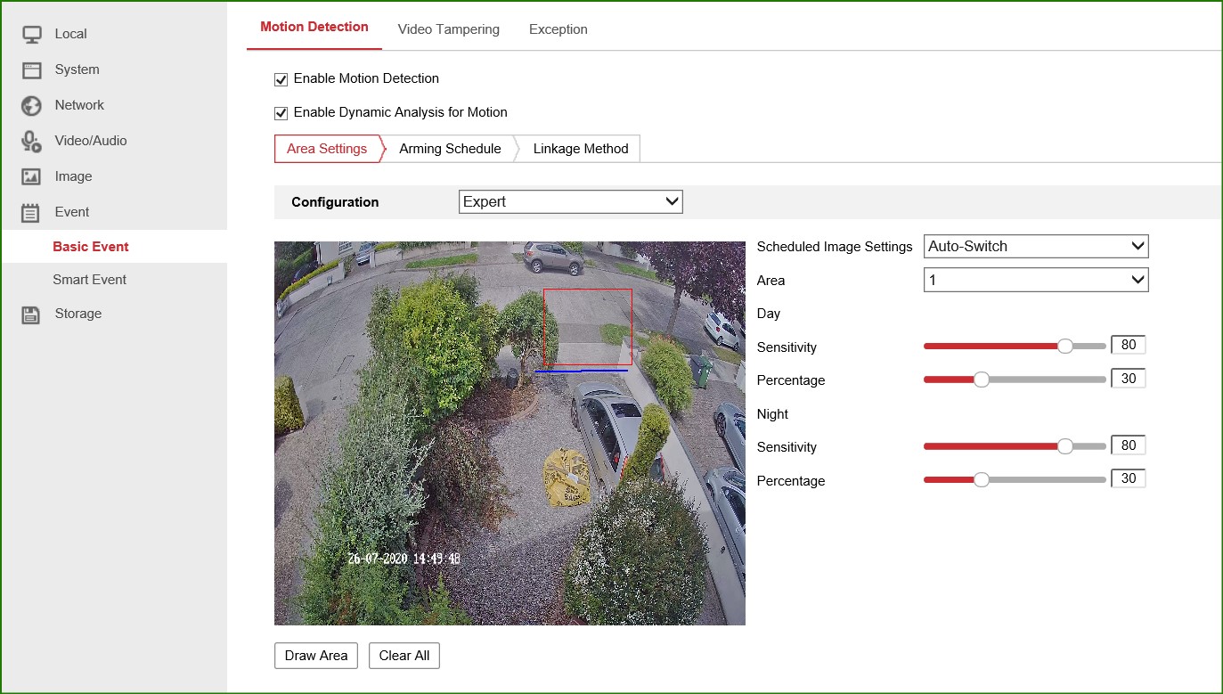

Couple thoughts. First, you're not showing arming and linkage method for your smart events so it's still not possible to know what you're doing or why you're not getting notifications. Second, your min max boxes look much better. Third, as suggested several times, stop using motion detection under basic events. Only use line and intrusion detection and fine tune those. Also, where are you expecting to get notifications - on Hik Connect? If so, there are two areas under settings in the app where you need to turn on notifications. You'll have to look through the app to find them, and there are several threads on here with instructions and pictures.

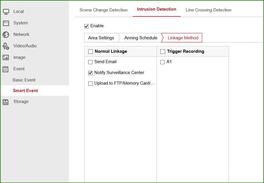

Arming and Linkage for Smart Event.

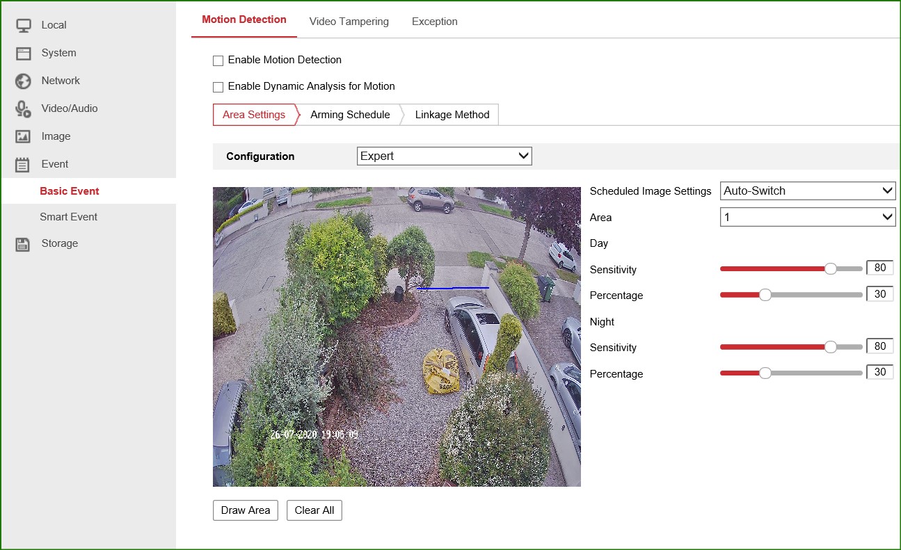

Disabled Motion Detection.

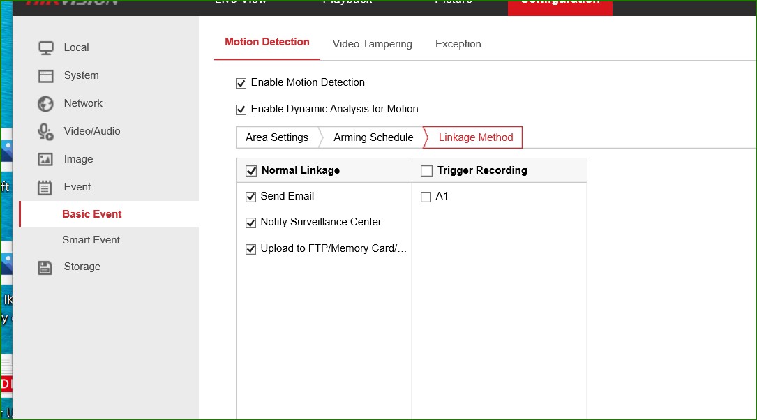

So for your linkage method you have all three checked. Assuming you have an NVR, why do you have the box ticked for upload to card? You also have email checked, are you getting an email?

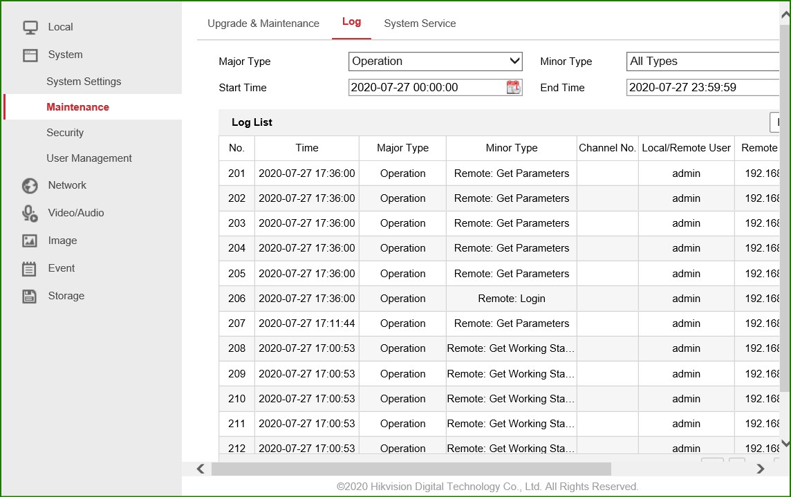

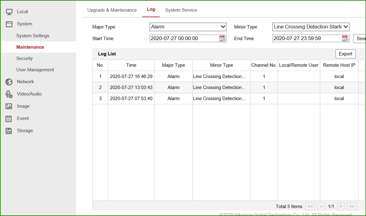

You can check whether any events are being triggered by going to the logs and reviewing them. Don't have my setup in front of me right now, but it's possibly under the maintenance area.

I found the log and discovered events.
I have now, unchecked 'Send Email' (never got emails)
I have unchecked to 'FTP/Memory' (I thought FTP was something to do with sending the snapshot to my phone)
Surveillance Centre only box checked now.
I must not have saved Disable Motion Detection yesterday!
I'm going to read up now on the Log minefield.
All those options stored under the Minor Type over on the right when you have when Major Type Operation selected over on the left!!!!

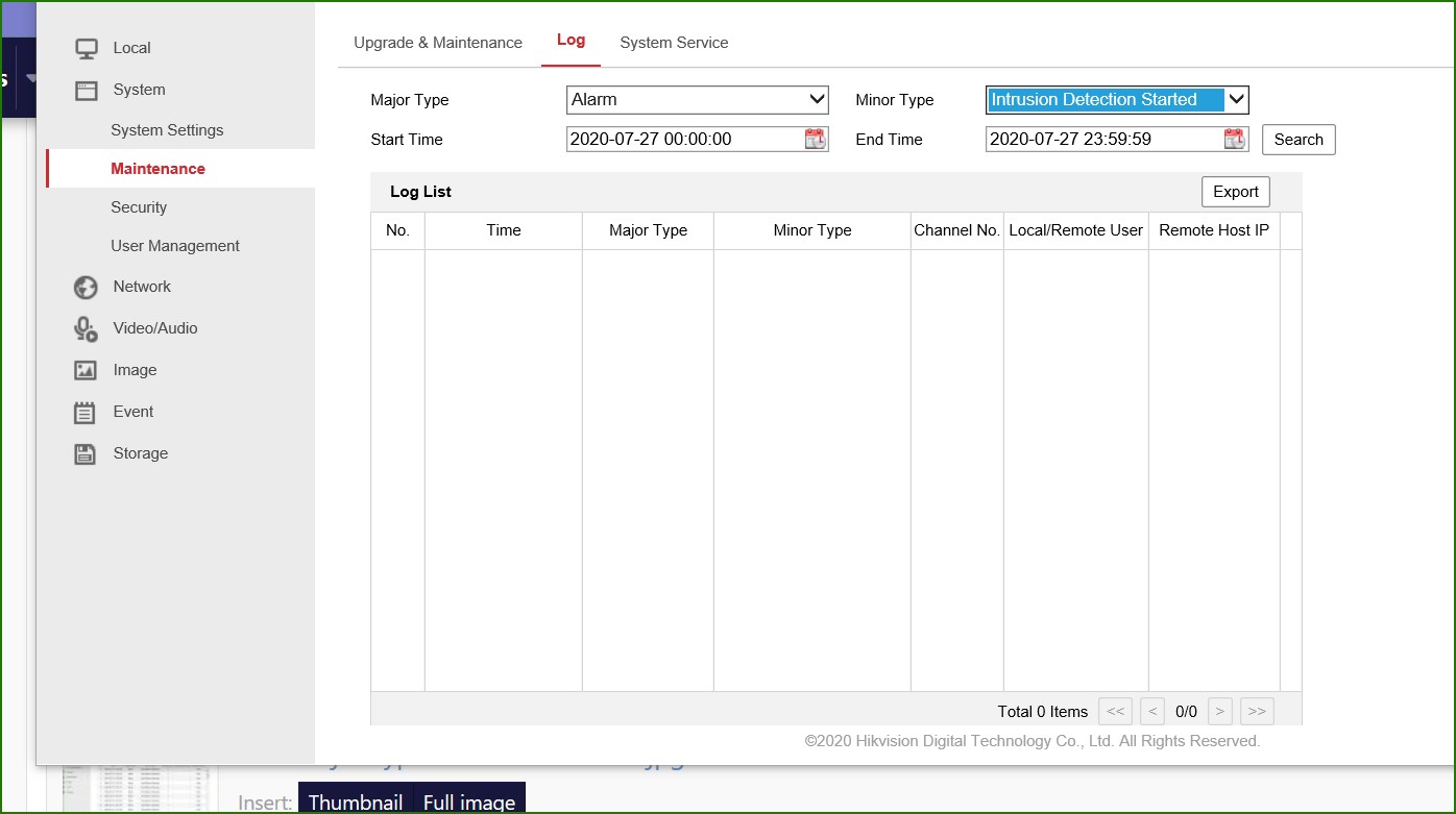

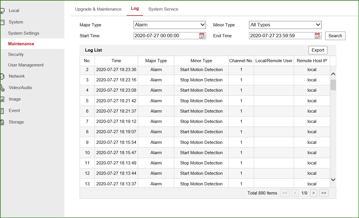

Pick a camera. Make sure you have line crossing and intrusion properly set up and saved. Then go walk through the areas of that camera. Go back to your computer, look at the logs, and see if you are getting both events. If so, you have a notification problem and not an event problem. Go from there.
