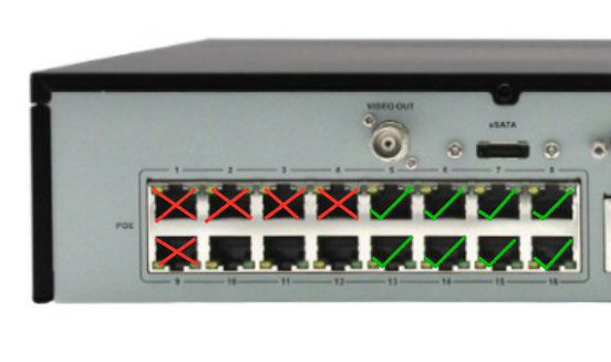

Here's a bit of an update on my findings so far.
I've tried cameras in various ports to see which ones are stable and which are disconnecting and there seems to be a
pattern emerging. I've marked a picture to indicate which ports are working fine and which are not indicated by green ticks or red crosses respectively. I still need to test D10, D11 and D12. It takes a while because each time I move a camera to another port I have to leave it a day to see what happens.
As you can see from this picture it appears that the PoE ports are split vertically into 2 halves. I'm wondering if the circuit board provides power and or data connections separately to each group of 4 ports?
With 8 of the 9 cameras connected to the right half of the PoE ports, I only had 1 camera disconnect on the D9 port in 24 hours.
I'll continue my testing over the weekend by trying the remaining 3 ports one at a time for a day each. Going by the pattern that's emerging, I would expect to see 3 red crosses on the remaining ports. But we'll see.
Just a side note. The picture I used isn't my specific model but for the purposes of what I'm trying to explain, any 16 port picture will do.
John H.

After several days of port swapping and testing the results, I can now confirm that any cameras connected to ports D1 to D4 and D9 to D12 are suffering random video loss of signal and sluggish operation in live view. And ports D5 to D8 and D11 to D16 work absolutely fine.
My initial thoughts were that this is a hardware fault with the left side 8 ports or some other component connected to them. But, another thing I've noticed during testing has made me reconsider that thought. The majority of these camera disconnects are occurring during the night. Not all of them, but a rough estimate would be at least 90% of them are. If this was a hardware fault then I would expect these disconnects to be more spread out during any 24 hour period. Although, during the day time when there's very few disconnects, the Live View mode still displays random sluggish images.
I hope this information might be of some help to point the Hikvision engineers towards the source of the problem.
I'm currently running 9 cameras connected to my NVR so 8 of them are working fine. I can live with that for a while. But I intended to add another 2 at some point this year and as things stand at the moment, that's not an option with this NVR only able to operate at 50% capacity.
John H.
