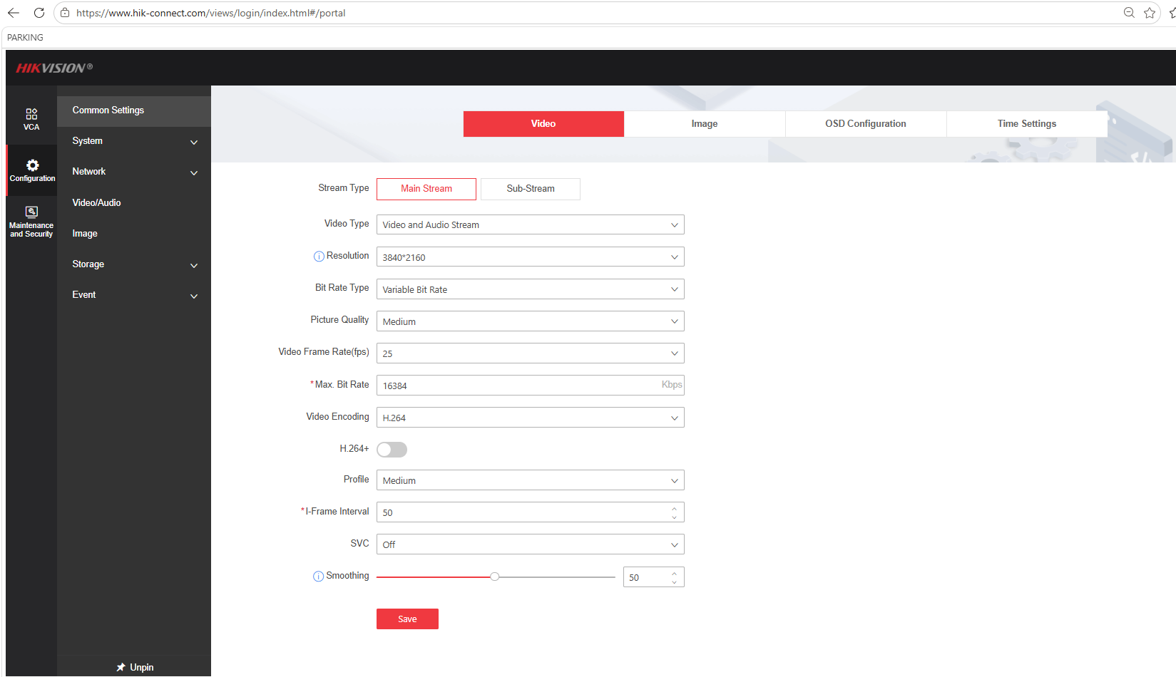

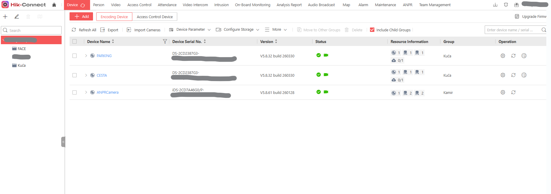

Yes if you enable TeamMode, then you can access remote configuration via HC web.
It looks like this
But its not really 1/1 options you can use. Some will be local only. But most of the stuff can be done via cloud.

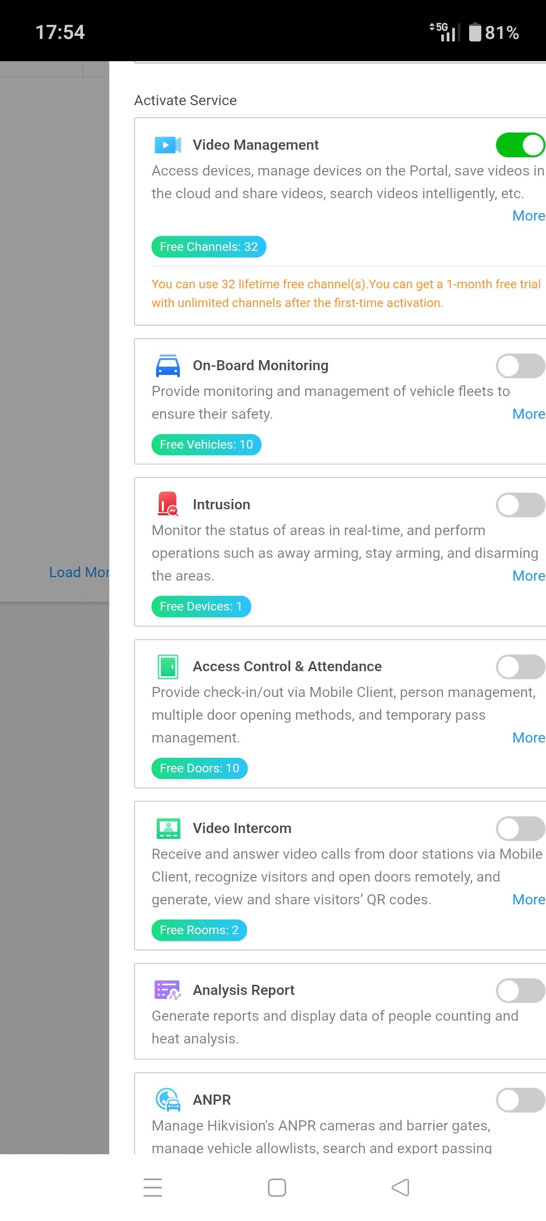

Hello
I found the section you mentioned but I'm prompted several option like the attached screen where most of the services seems to be a trial, then need to pay.
Is it the right place?
Which service should be used?

You can tick everything, you have 32 free channels
Literaly says there
It wont charge you qnything in advance
You are right. I mislead the the point about paying. It is referred to the unlimited channels but the 32 channel are included.
Which is the right one for the configuration?. Should be the video management I suppose
Thanks again
You may as well enable everything, you wont be charged anyway, but yes video management is for remote config
