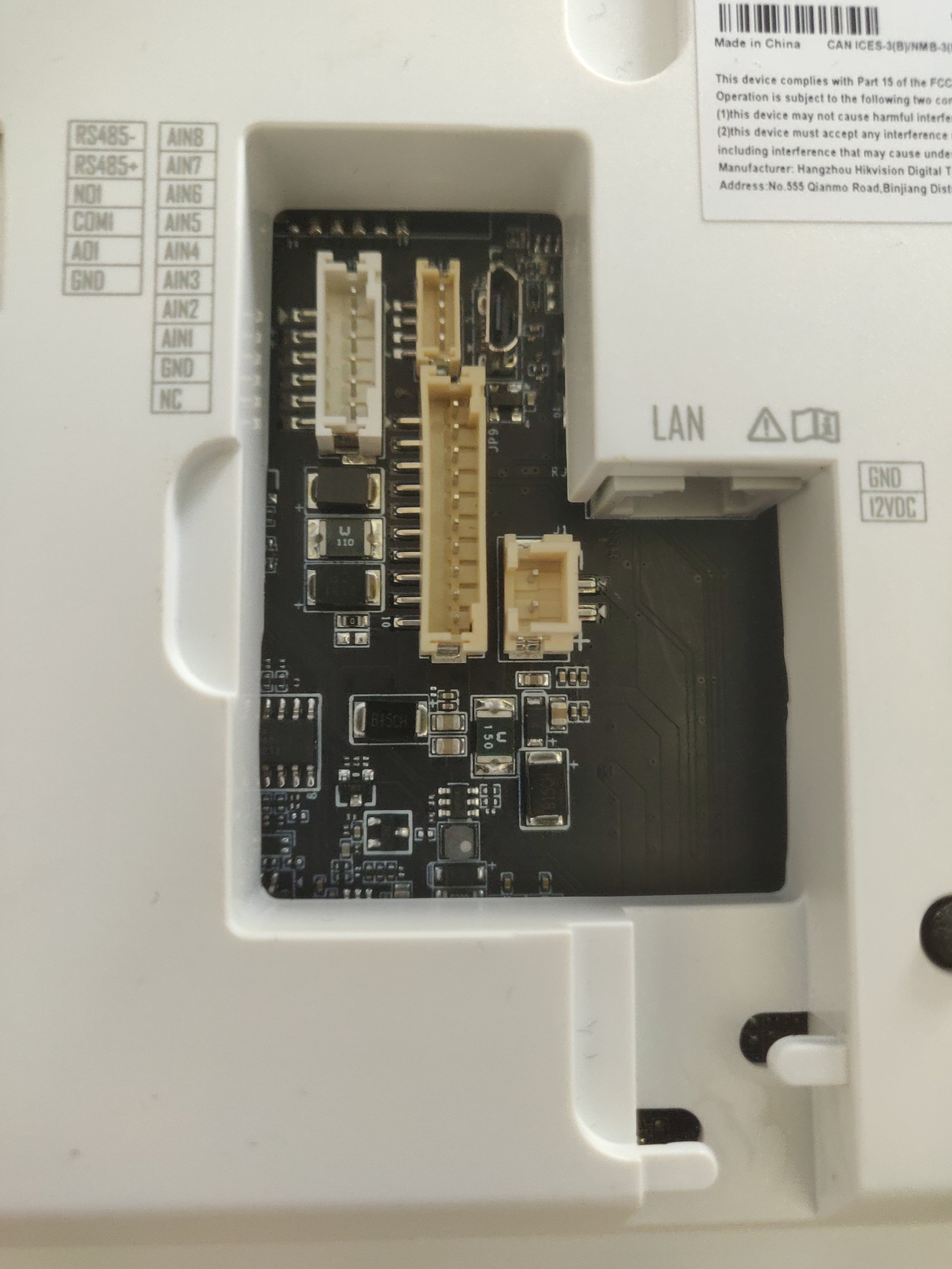

Ds-kh9510, hikvision gave me the picture I showed in first post, the connector on it is also JST ZH

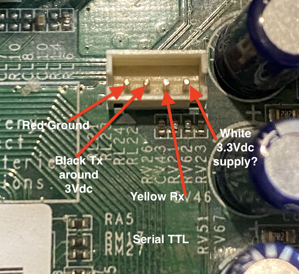

The 4 pin JST ZH connector looks the same as mine on the NVR. The black Tx wire on the JST ZH connector assembly should be around 3Vdc, I measured mine with an oscilloscope, a DVM should be the same.
