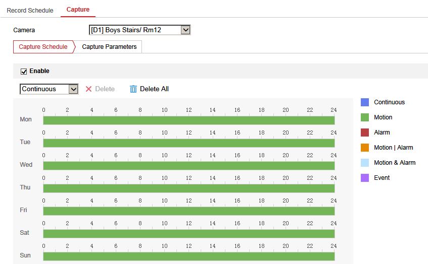

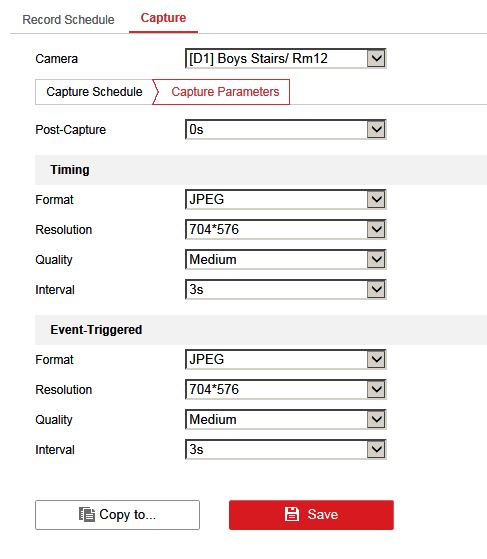

What is this screen and why do we need it?? Record Schedule and capture are both on.. the record schedule is working as we need it.
I presume those are settings for image capture. What about this schedule tho??

Is this the Nvr or one of the camera web interfaces?
If not onboard storage of a camera, it looks like your set up for continuous recording of still images.. JPEG at 3 second intervals and a pretty low resolution?
