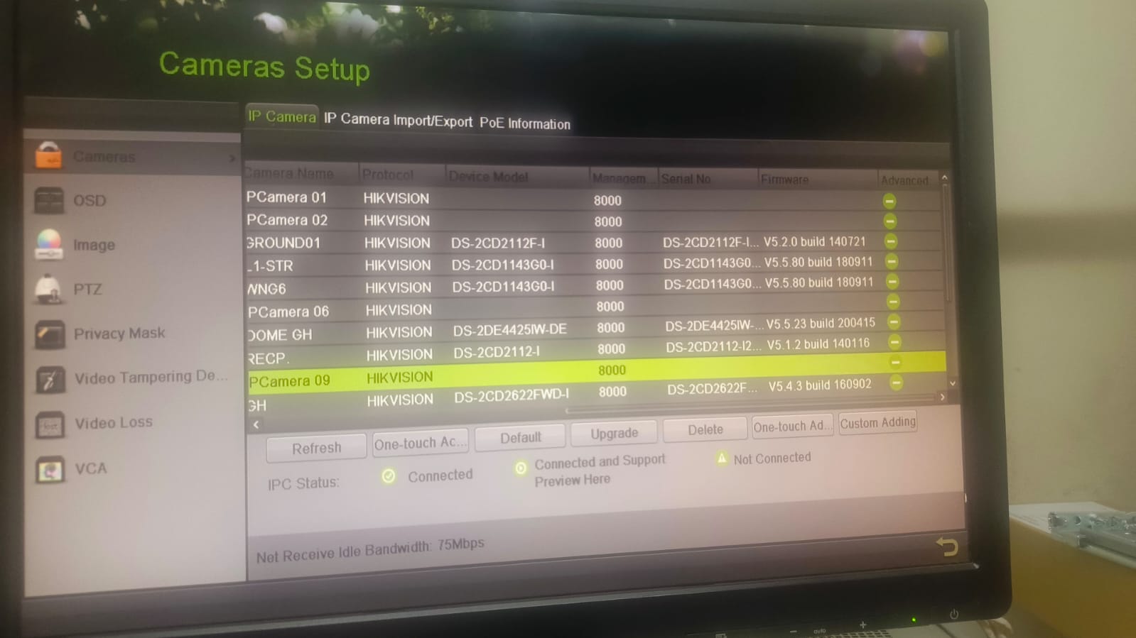

When attempting to add the new cameras to the NVR:
The NVR reports one of the following:
Offline (IP camera does not exist)
or
Unknown Error
The cameras never come online.
While troubleshooting, I discovered that this issue may not be limited to the new cameras.
Several existing channels are also showing:
Examples include:
These cameras were reportedly connected and operational at some point in the past, although I cannot verify exactly when they stopped working.
At the same time, several other cameras remain online and fully functional.
This has made me wonder whether the problem is broader than just the newly purchased cameras.
Current status resembles:
D03 Online
D04 Online
D05 Online
D07 Online
D08 Online
D10 Online
D12 Online
D14 Online
D16 Online
D06 Offline (IP camera does not exist)
D09 Offline (IP camera does not exist)
D11 Offline (IP camera does not exist)
D13 Offline (IP camera does not exist)
D15 Offline (IP camera does not exist)
The new cameras were added to available channels but remain offline with either:
or
Unknown Error

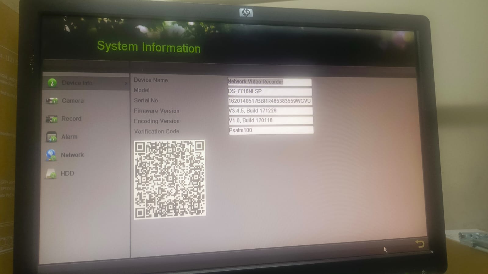

One thing that stands out is the age difference between the NVR and the new cameras.
DS-7716NI-SP
Firmware V3.4.5 build 171229
DS-2CD1043G2-LIU
Firmware V5.8.10 build 250714
There is roughly an 8-year gap between the firmware generations.
I am wondering whether the NVR firmware may be too old to properly support these newer G2 cameras.

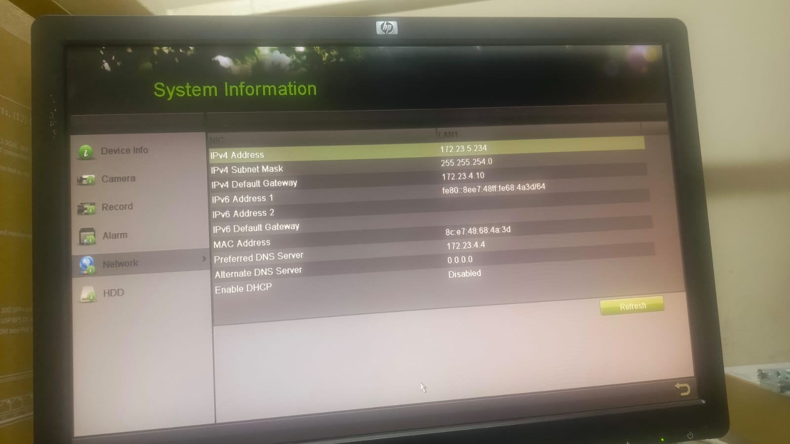

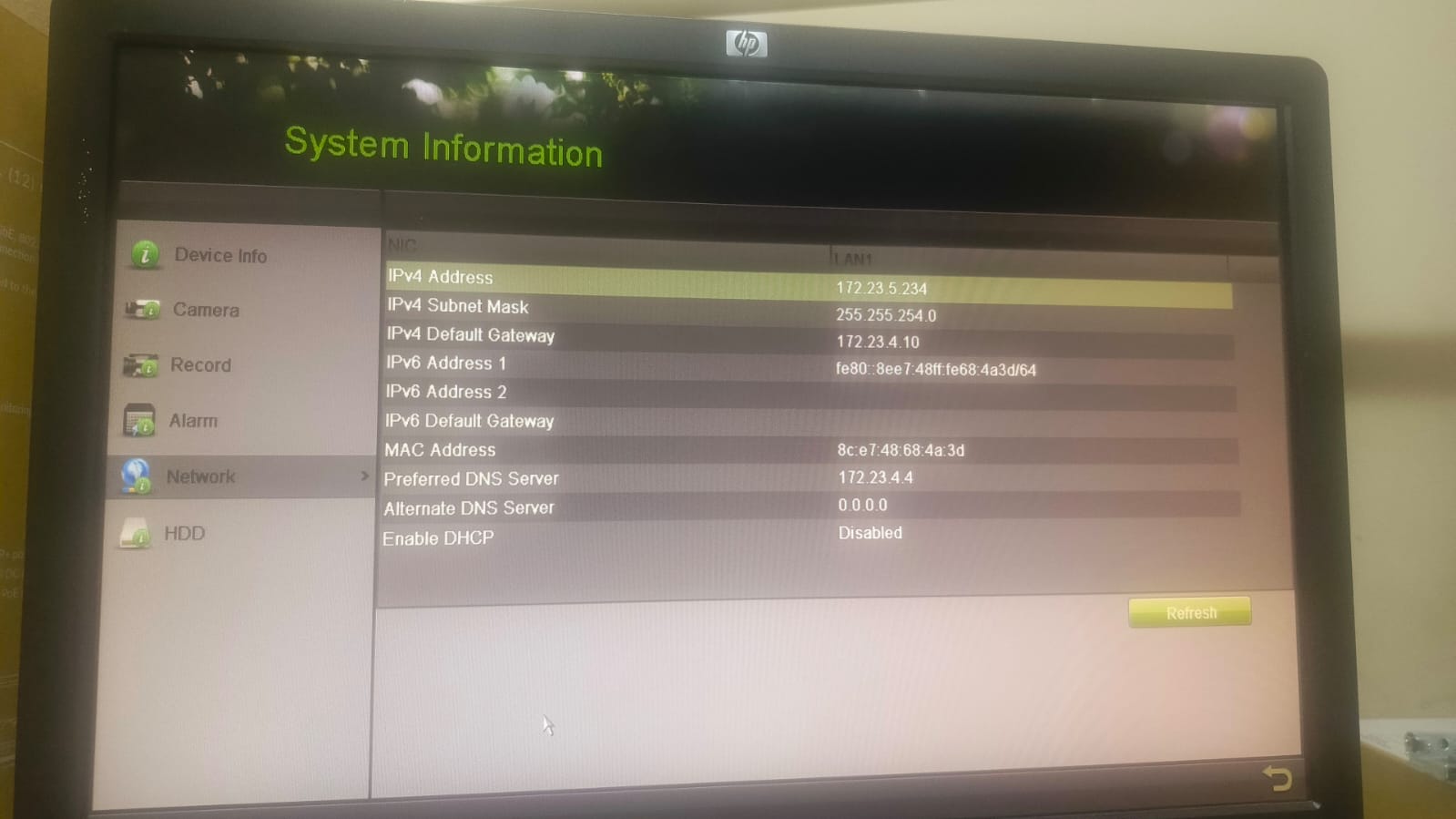

IP Address: 172.23.5.234
Subnet Mask: 255.255.254.0
Gateway: 172.23.4.10

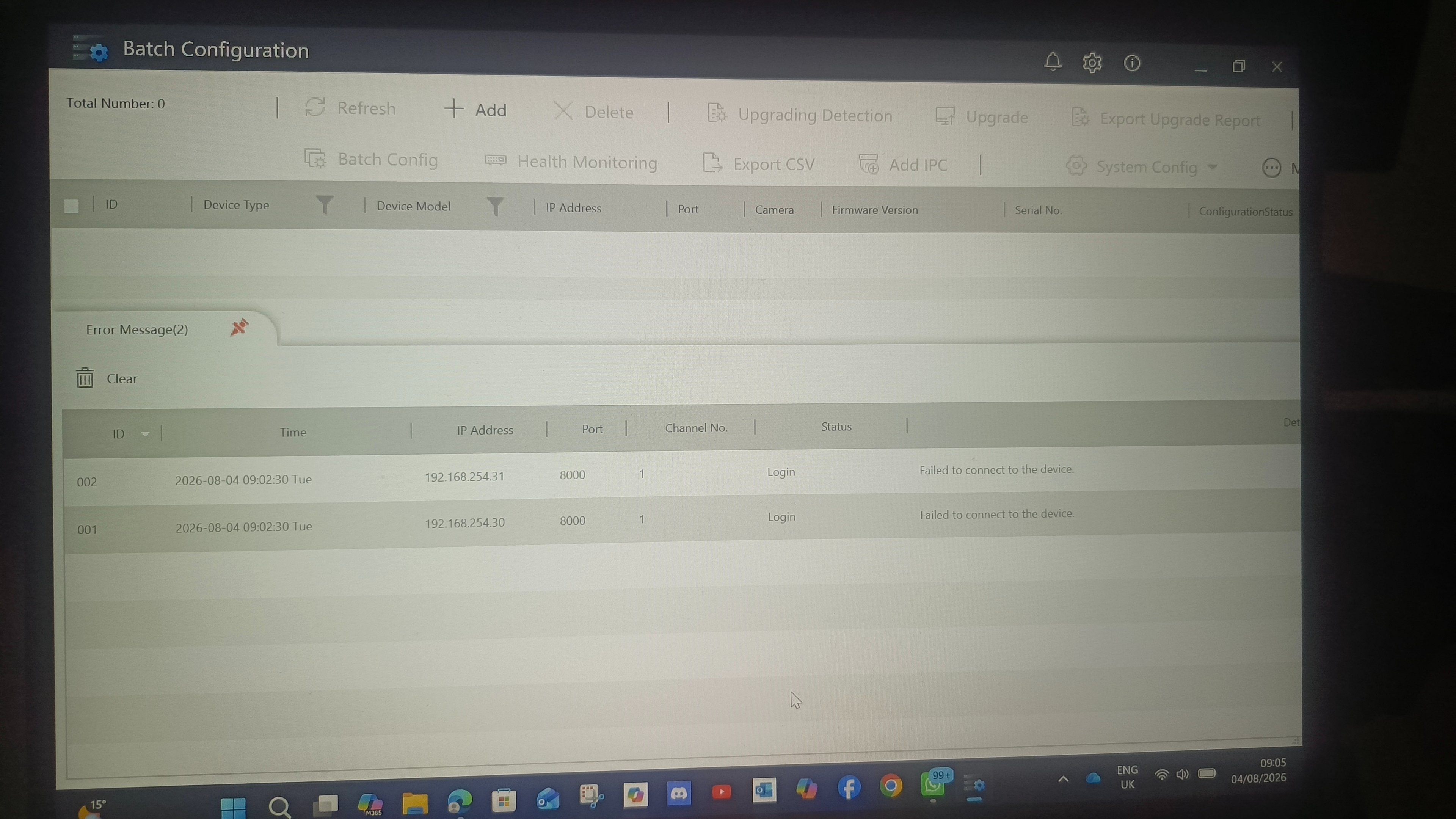

NVR Behaviour
- Protocol: HIKVISION
- Management Port: 8000
- Username: admin
- Correct camera password entered
or
Unknown Error
Additional Observation
Examples include:
- D06
- D09
- D11
- D13
- D15

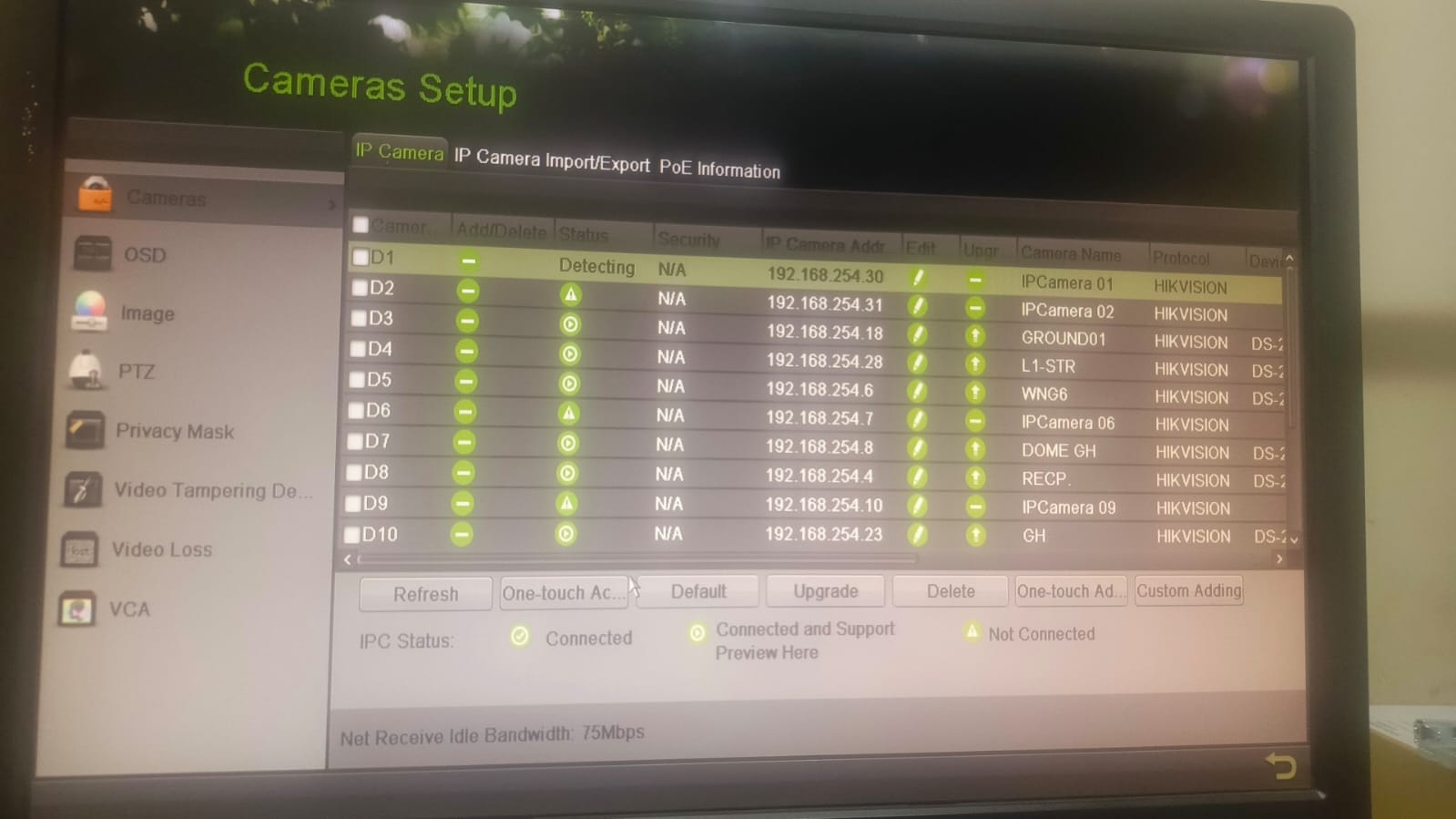

Camera Management Example
D03 Online
D04 Online
D05 Online
D07 Online
D08 Online
D10 Online
D12 Online
D14 Online
D16 Online
or
Unknown Error
Firmware Concern

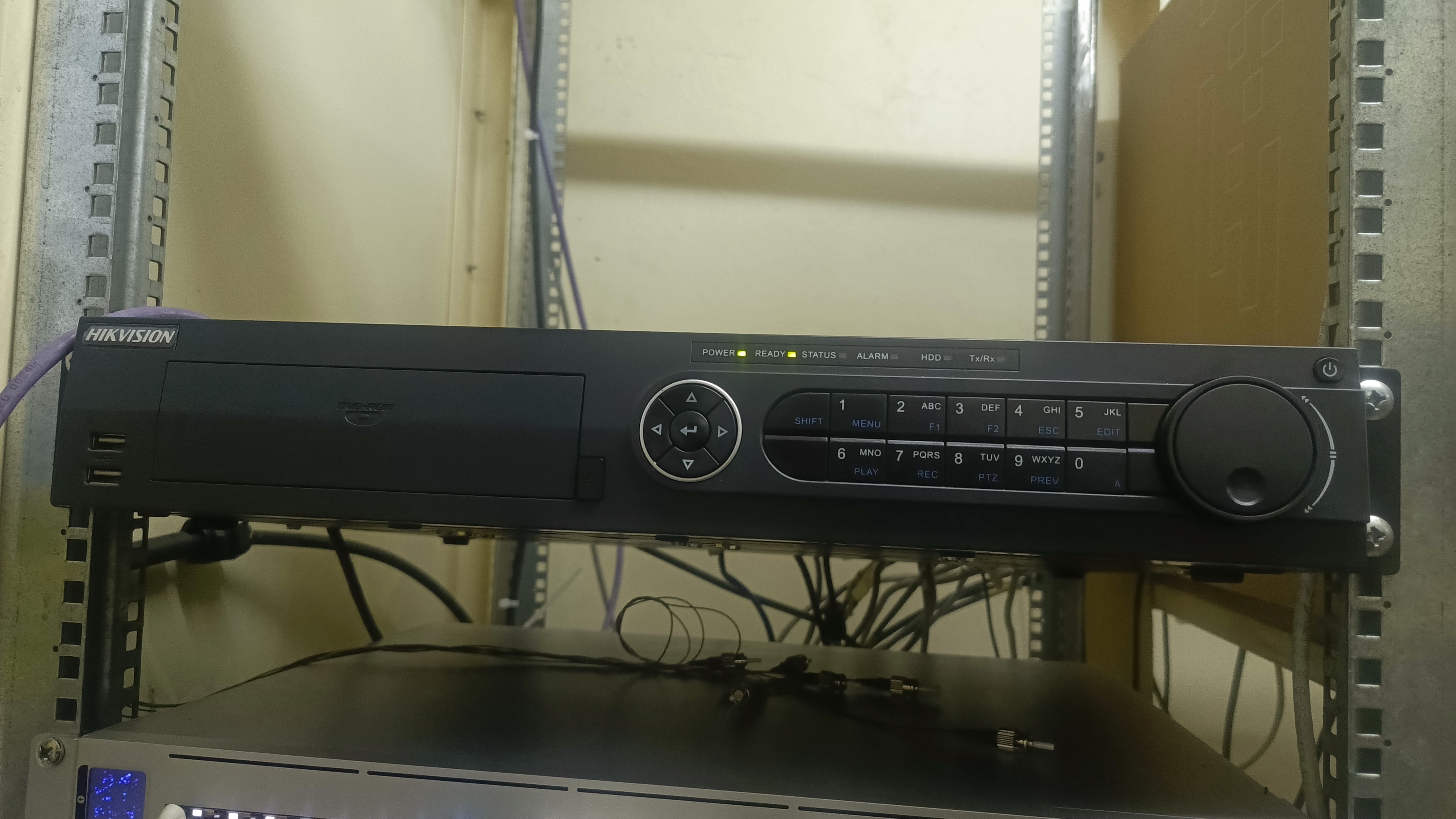

NVR
DS-7716NI-SP
New Cameras
DS-2CD1043G2-LIU
Network Configuration
NVR LAN1
Camera Network
192.168.254.x
The NVR already communicates successfully with several cameras on the same 192.168.254.x range.
