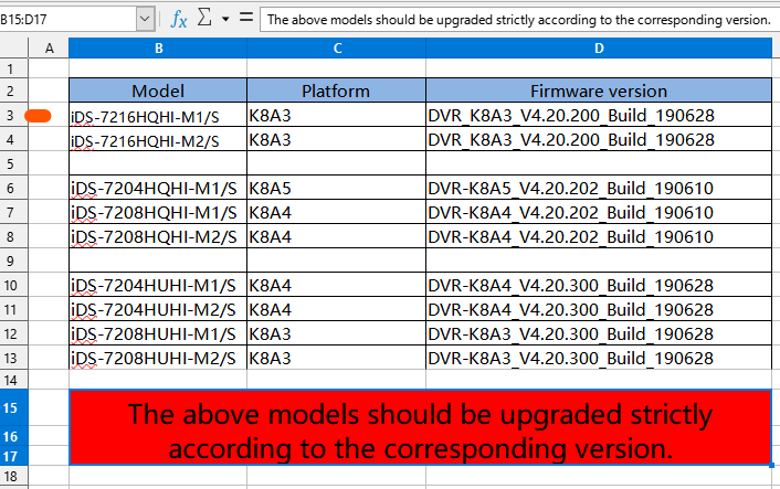

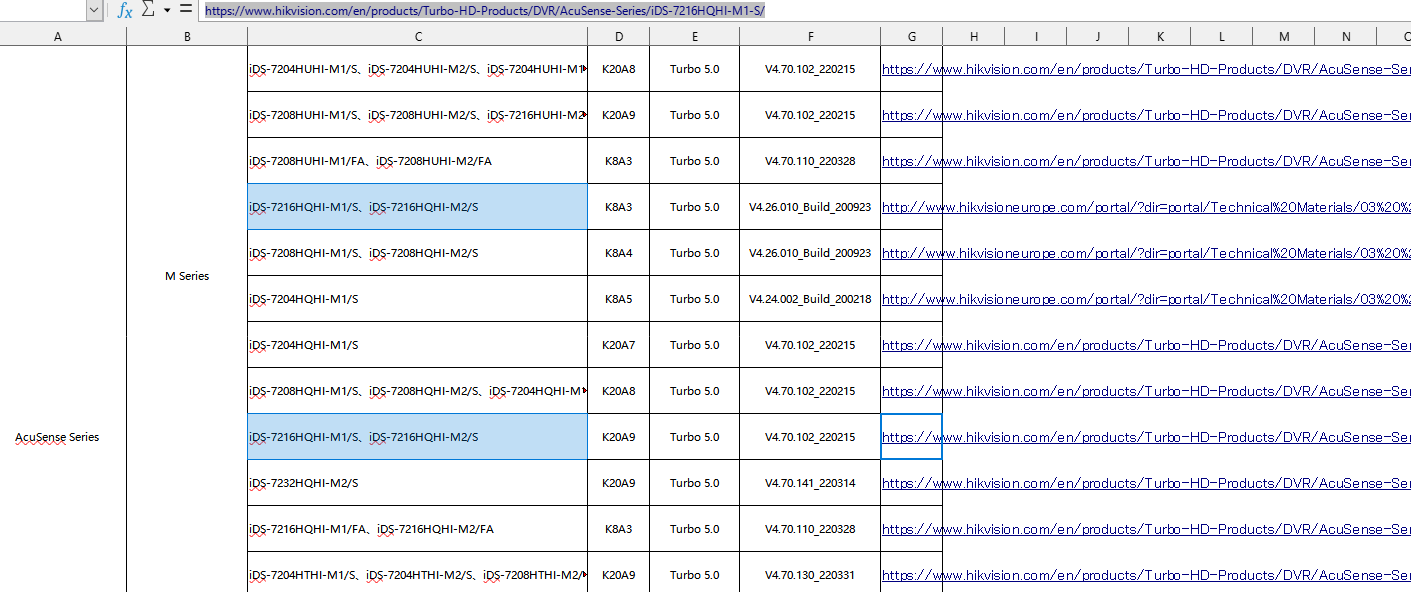

There are two different boards for iDS-7216HQHI-M1/S
There is also a different version of firmware for the (C) models
Check the board number printed on your board beside HDD
Read the .xlsx files" for Turbo 5.0 : "The above models should be upgraded strictly according to the corresponding version"
