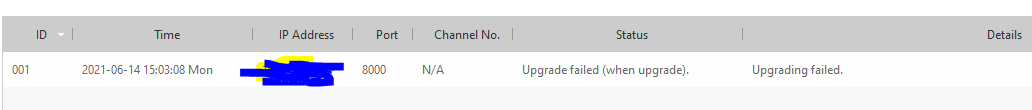

Ok Thanks - yes that looks like it should be the right one in theory.
I tried using v4.30.200 from that page and they all just give an "upgrade failed" error on the web UI. Tried using the batch config tool and also putting the digicap.dav file onto a usb stick and upgrading locally on the NVR but that also fails with a version mismatch error.

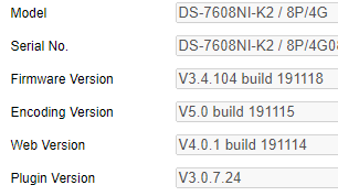

The model and firmware listed on the device are as follows - interestingly the firmware version here does not appear on any of the Hikvision sites for download.
Ruled out local issues on my PC as the cameras firmware all upgraded fine.
Any other thoughts on whether this model requires a different firmware variant?
