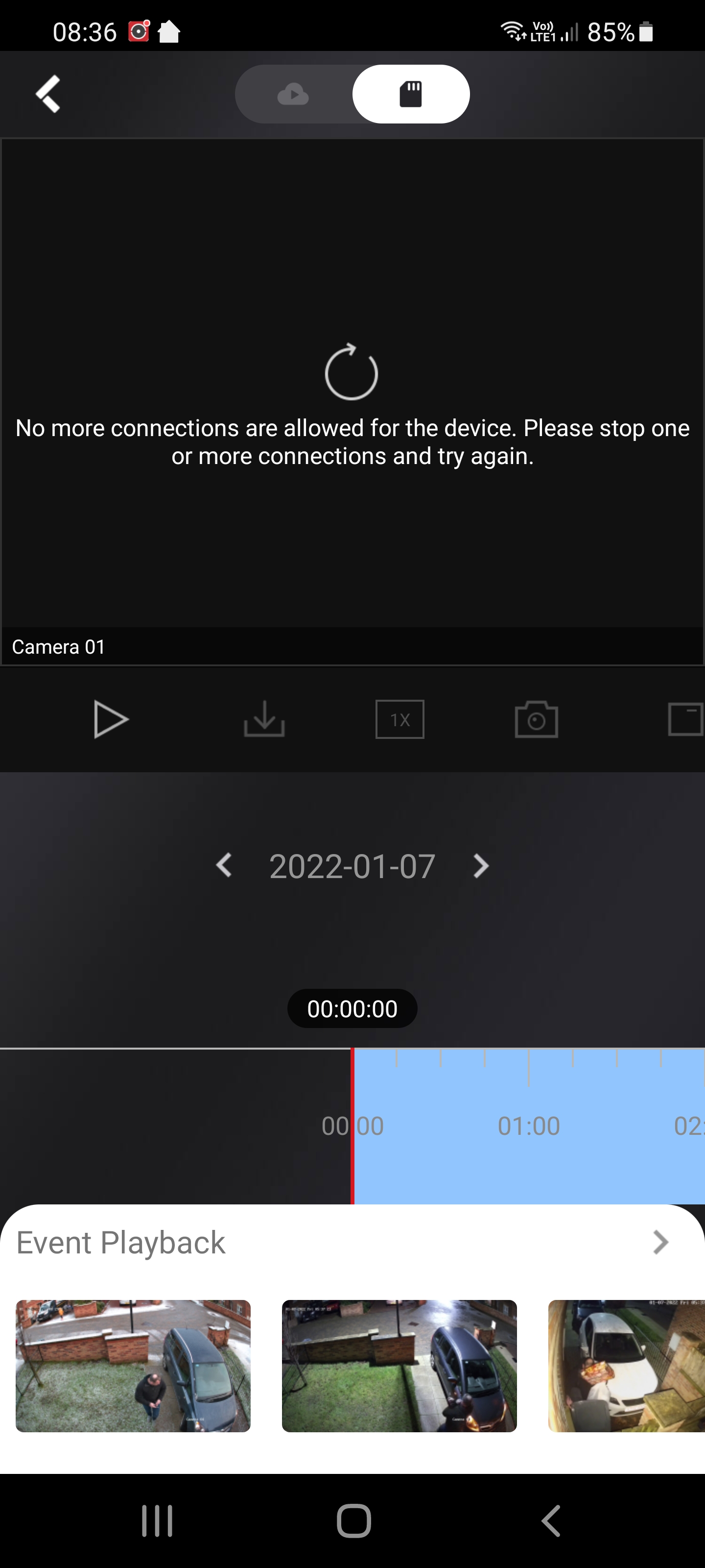

After an nvr reboot it's done it again via playback in hikconnect. With in a week its done it again!!
That means the playback via the nvr will also not play.
Why is this happening?
What connections am I supposed to be stopping?
