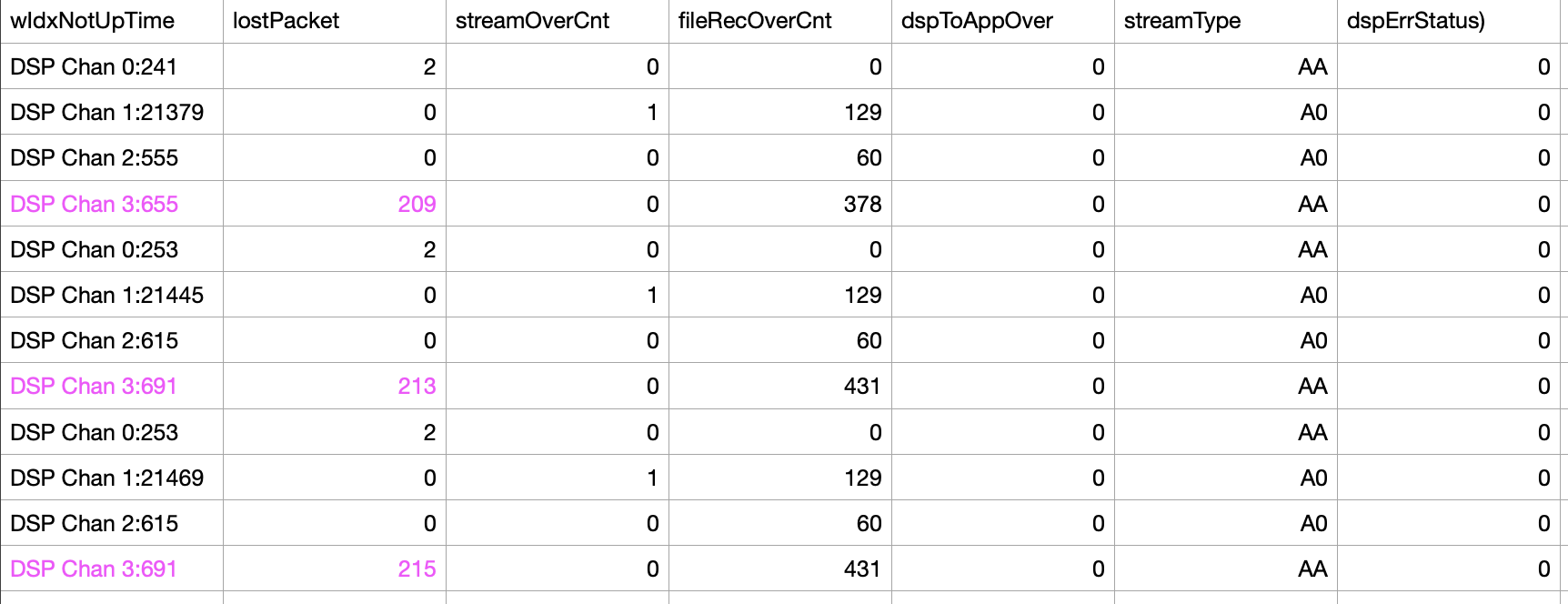

Ok, I dropped by the office, here’s a couple pics. I will have to look up a network connectivity log for the nvr, not sure where that is. But for now…
Looks like we’re getting closer to the root cause.
I think DSP Chan 3 is Channel D4 and is dropping a lot of packets, is that the problem one?

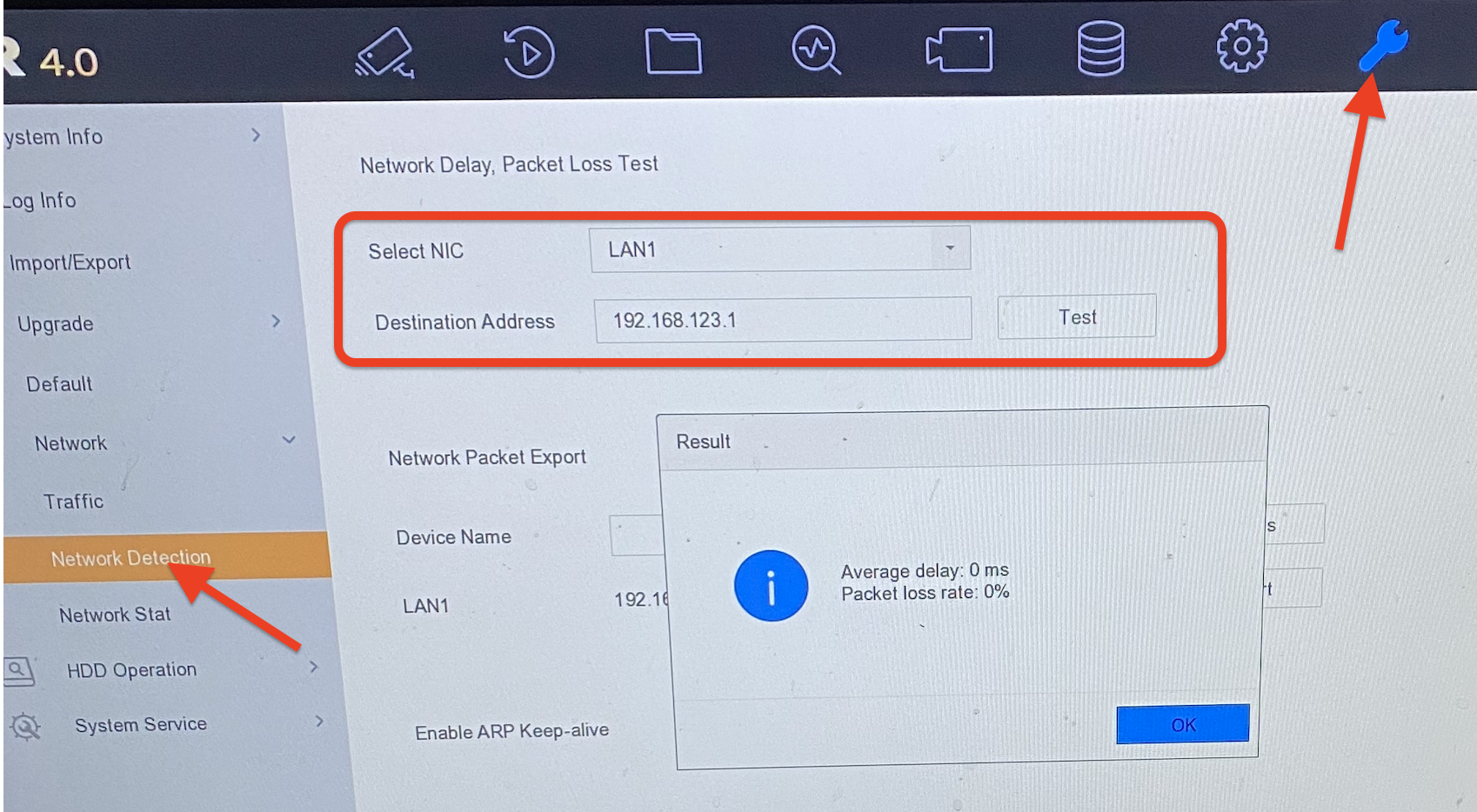

See attached image from my older NVR, should be similar to yours. Your NVR ping test may have more functionality. You may be able to ping the cameras from your NVR, I don't know what the ping does so the results could be misleading.

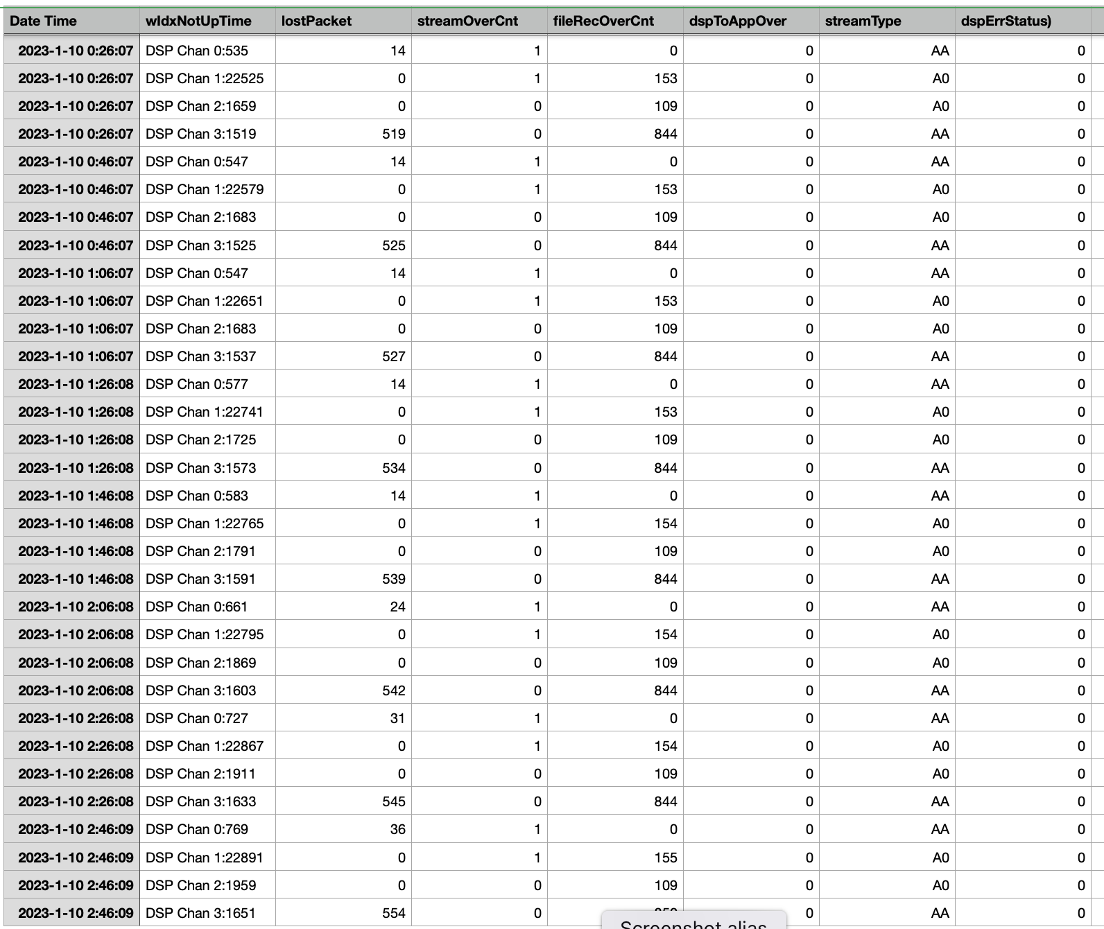

I attached the logs from yesterday, did you use a program to open the network log, I can see the dropped packets in the event log but certainly isn't as legible. I hope to here back from the telco today. I had more video loss reports last night to the hik0connect app than the previous night.
I think the smaller LAN1 file is html code, the other is parseable text. I used to write scripts to process these, we are not seeing the full picture here.

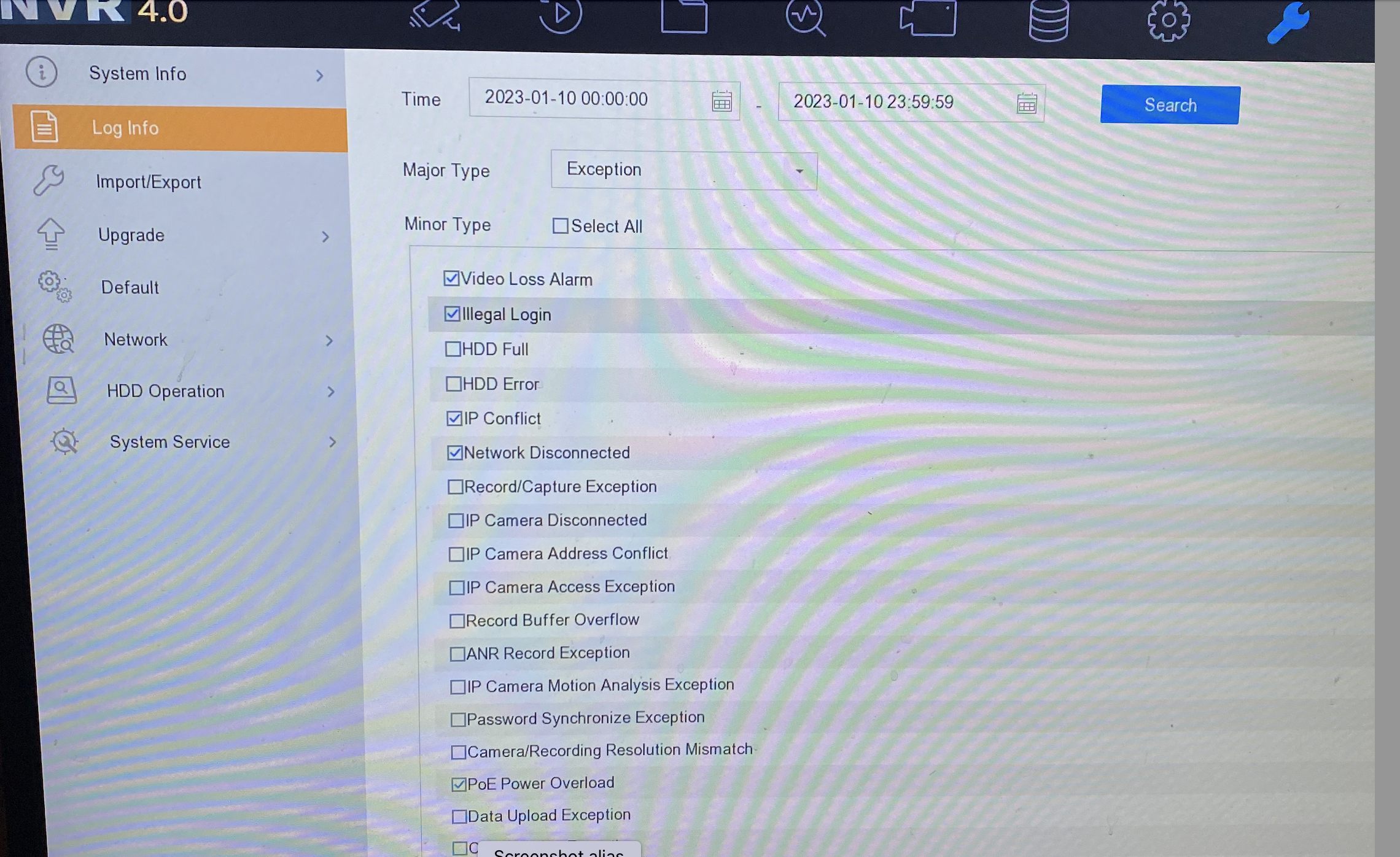

Can you export this log from the NVR?
set date time range
Major type exception
uncheck minor type box
select ones I've checked. Deselect the illegal login box.
you can check others if you think they are relevant.

I’m sure you noticed, but the pic with lost packets seems to be every 20 minutes, I can try swapping injectors to see if that moves the packet loss from 3 to 2, won’t explain the other video loss but might point to an injector issue?

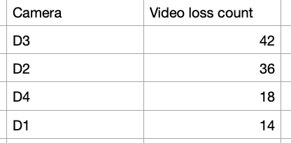

I also see multiple video and connection loss for D2 D3 D4, not so much for D1
The logs are difficult to follow, very poor data consistency.

Here's the export with only the noted selections. I also scaled back the prerecord to 0, there were some buffering errors (if I understood correctly).
