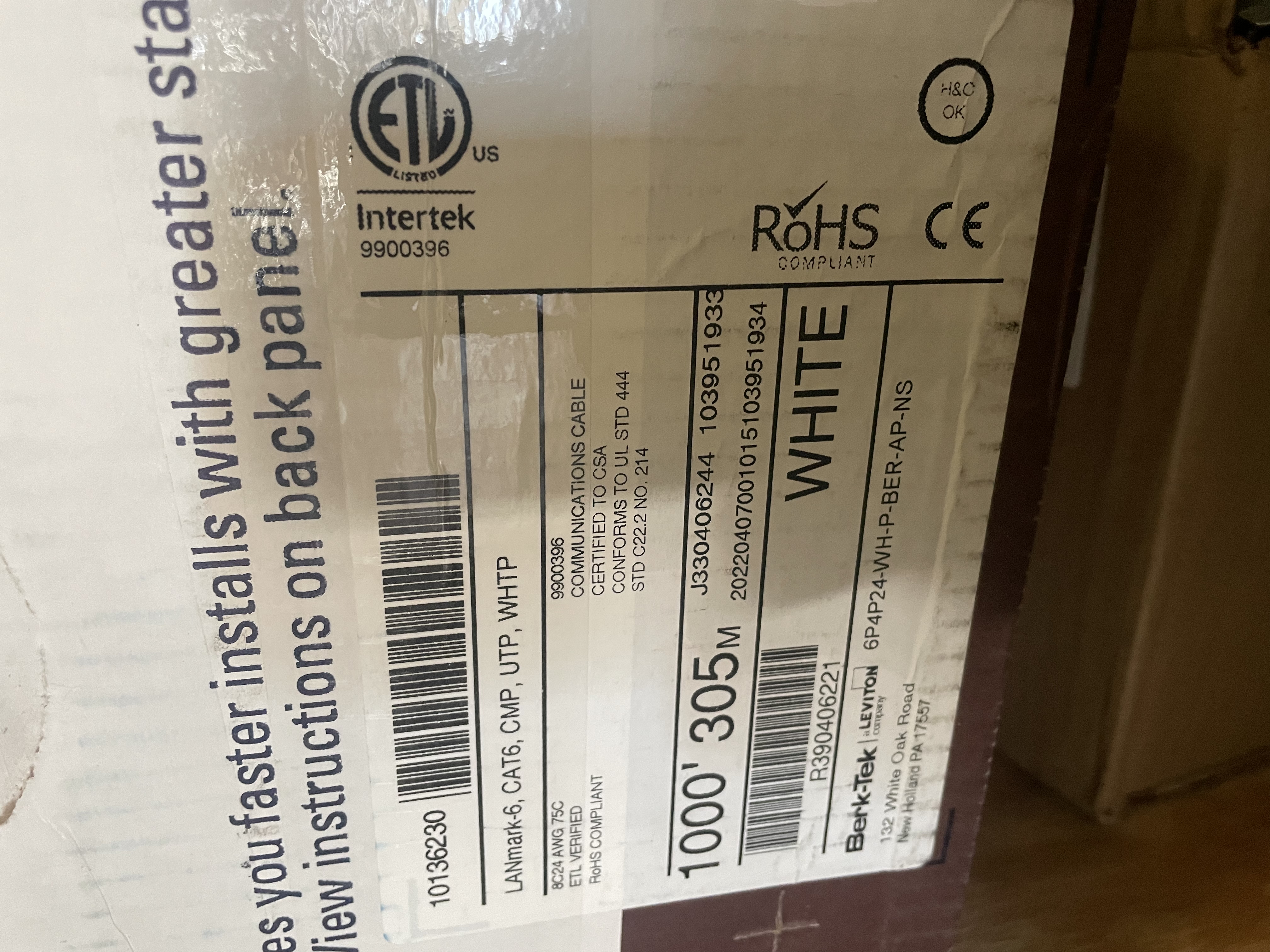

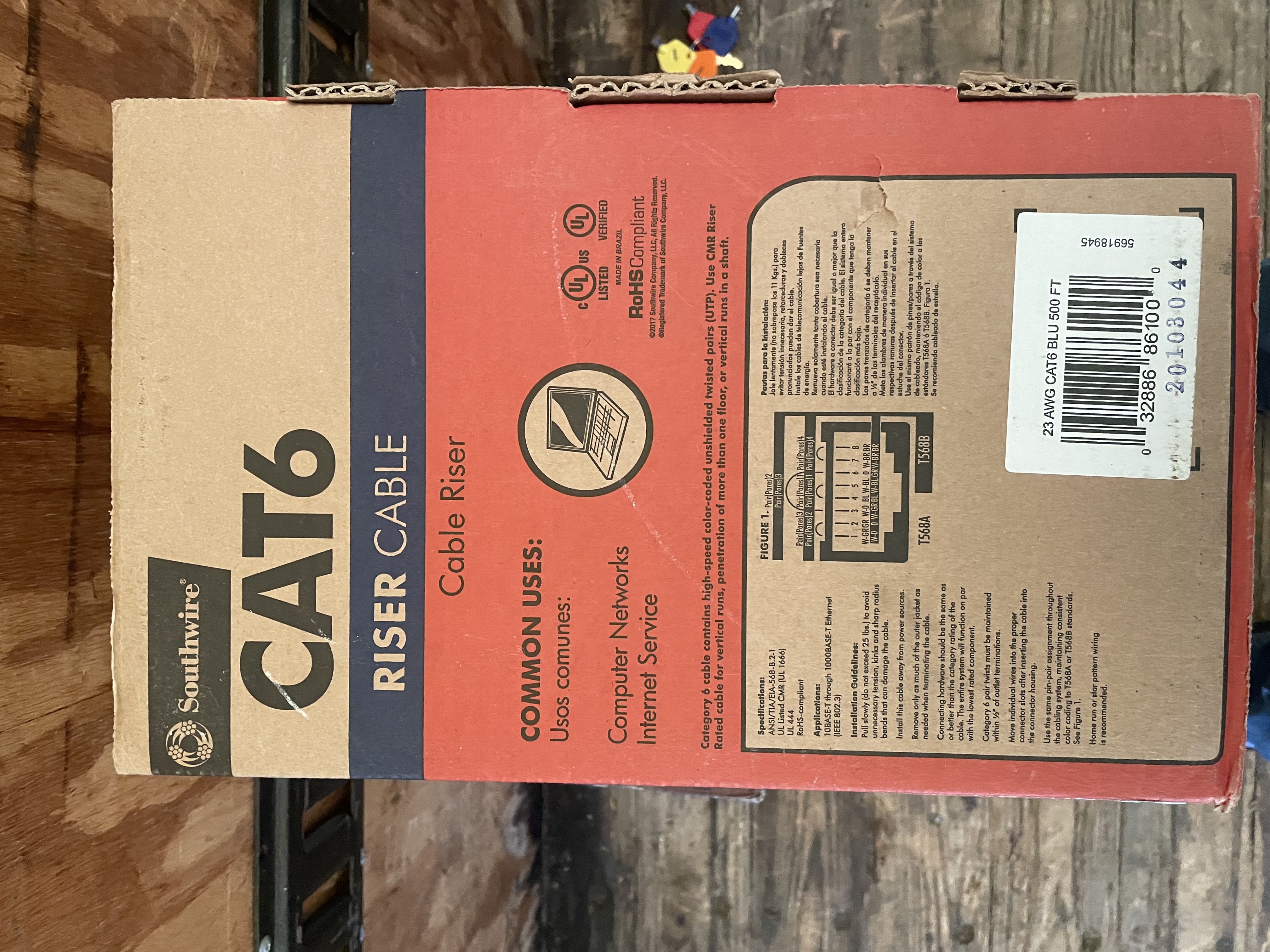

(brand a, brand b),
what are the specifications of the cables?
That’s the wire most of my cameras are on, brand b is I think a mono price cat5 cable, I do have brand c also pictured (brown box), this is what I had run for a couple drops but not yet put into service.
