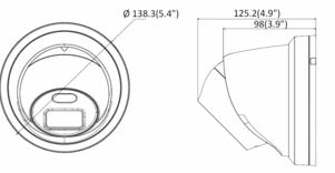

How is it? And can you tell me if you can wall mount it like this?
Whats the Volume of the siren and voice warnings like at night?

The camera will wall mount just fine like that. I have all of mine mounted that way. One thing to be aware of is that unlike the previous Easy IP 3 cameras - these turrets are slightly larger in diameter and don't have a big enough recess behind them to conceal the connector so it's got to push in the wall or you use an intake box. With the ISU/SL I'd recommend the latter as you've four leads to conceal - LAN, 12V DC, Audio, Alarm.
Don’t they all run off the Ethernet lead?
Hi @GLO,
They do, the LAN connection will carry both power and data, which is all you need.
The other connections are optional, i.e. you can connect a siren to the alarm lead, a microphone to the audio lead, or supply power separately via 12V DC if you aren't able to connect the camera to a PoE switch or NVR to do so.
