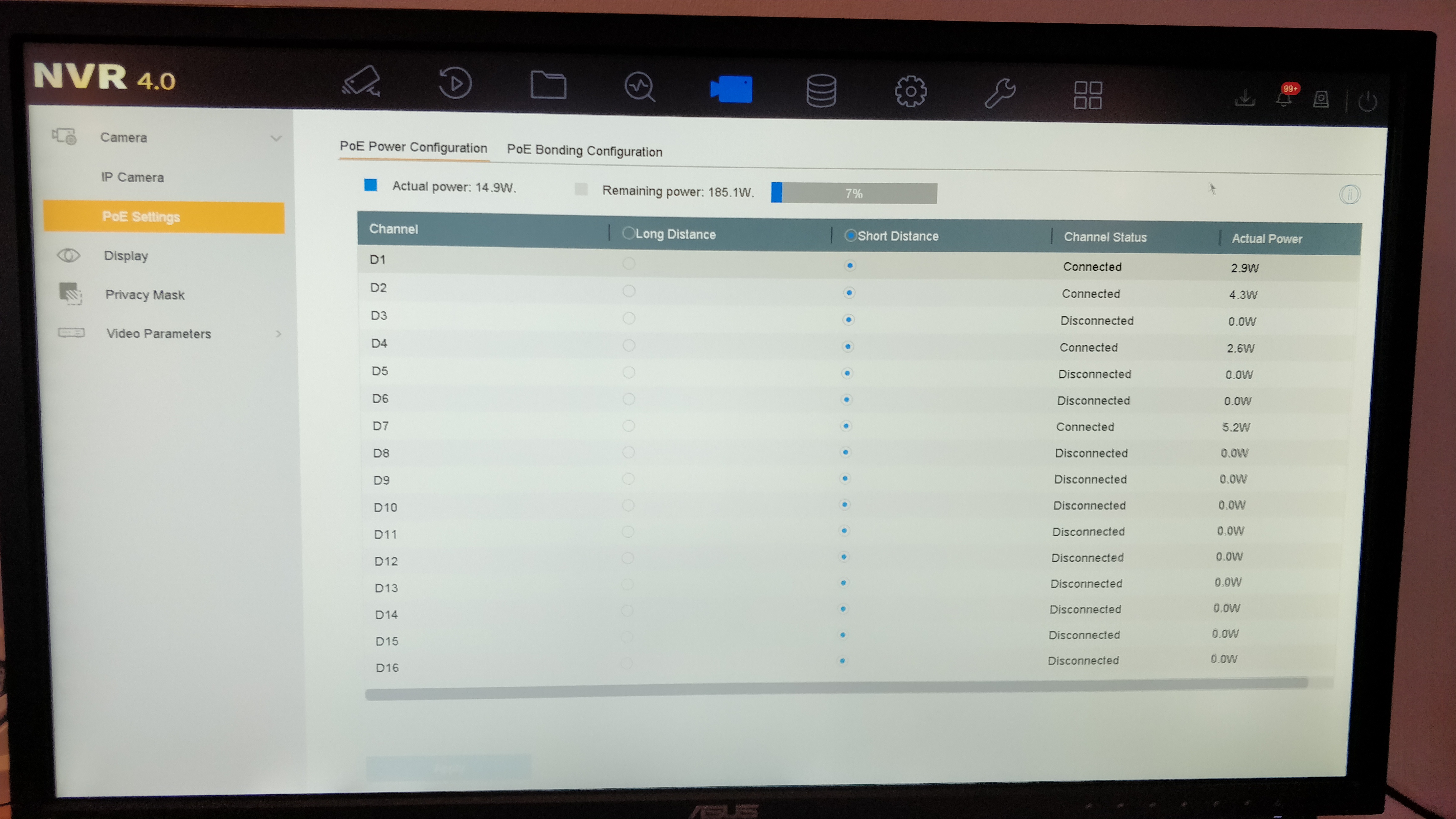

If you use a directly connected monitor you can navigate to the page shown below which gives you a live reading of the PoE consumption of the directly connected cameras, be aware that the total PoE level may appear low under the max. PoE supported when you view this data in the day time but most cameras will more than double their PoE usage at night when the IR LEDs are turned on, so maybe check both in the daytime and at night.
2535
Thanks @Dan will try and get a monitor from somewhere as NVR in loft and my monitors in office are wall attached.
