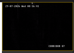

Its only this one channel with two different cameras. Attached is how it looks on the NVR and web view. The corridor when locked up has very little light as shown. The other image is when the lights come on.
Thanks for your reply.
Try the affected camera plugged in at the NVR. If it works normally there then it's likely something in the camera view. Or even just spin it around to a different view to prove the theory.
Thanks for your input. I will try plugging in at the NVR and see what transpires. Unable to do this till Sunday so I will let you know how I get on.
