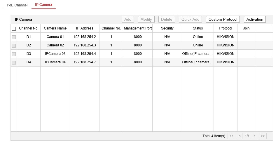

When I go on-line via Internet Explorer and then go into 'Configuration/camera management' it is showing both cameras as being on-line but I notice that it is showing the management port for both cameras as 8000 and, then end column titled 'Activation' with the word 'Join' beneath that, there is nothing showing against either camera. I don't know if that is relevant or not. Here is an image of what I am referring to.....

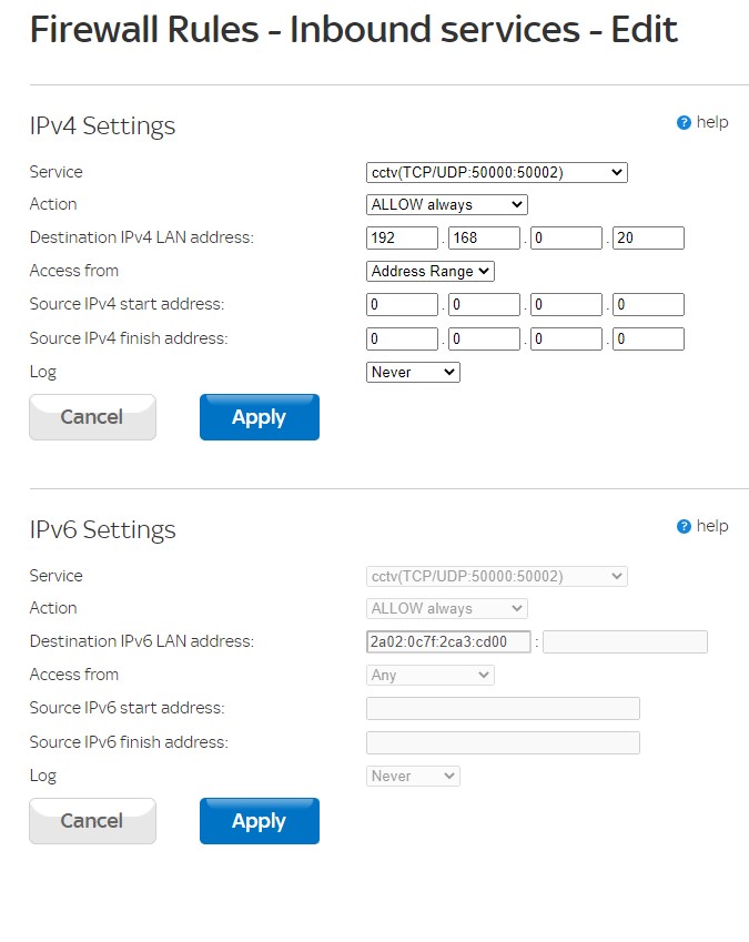

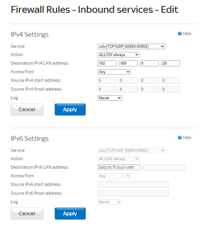

Also, regarding the router settings. At the moment the Firewall Rule settings for IPv4 are showing as Access - Any with no start or finish addresses, I'm wondering if it should be 'Address range' with start and finish addresses as per the attached images.

Yeah that's normal. The cameras connected directly to the NVR are managed via Port 8000.
The connection is there, the port forwarding is working, the NVR is logged in to Hik Connect, and so is your app so you shouldn't be having any issues. Lets see if the app will work while just connecting to your system on your WiFi - taking the Hik Connect service out of the equation. To do that you just add another site in your Hik Connect app. You can do this as follows:
