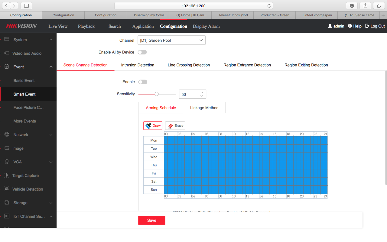

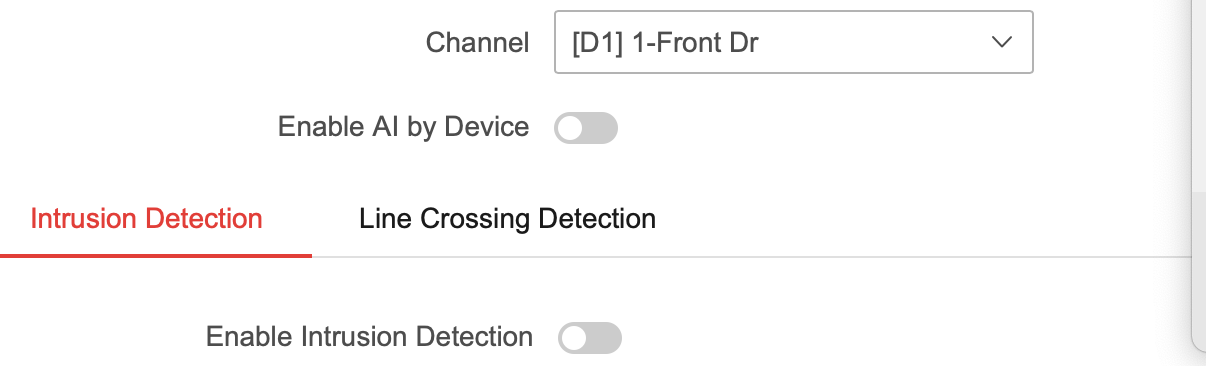

Whereas in the NXI-I series confusingly it shows:
When you've deleted, disabled, switched off the 'Enable AI by Device' switch and saved go to the following page. Configuration > System > VCA Configuration. In the example below I'm using the NVR AI for one older camera that doesn't have AcuSense. In your setup with the switch off, The AI Engine should not be running and should have no linked cameras.

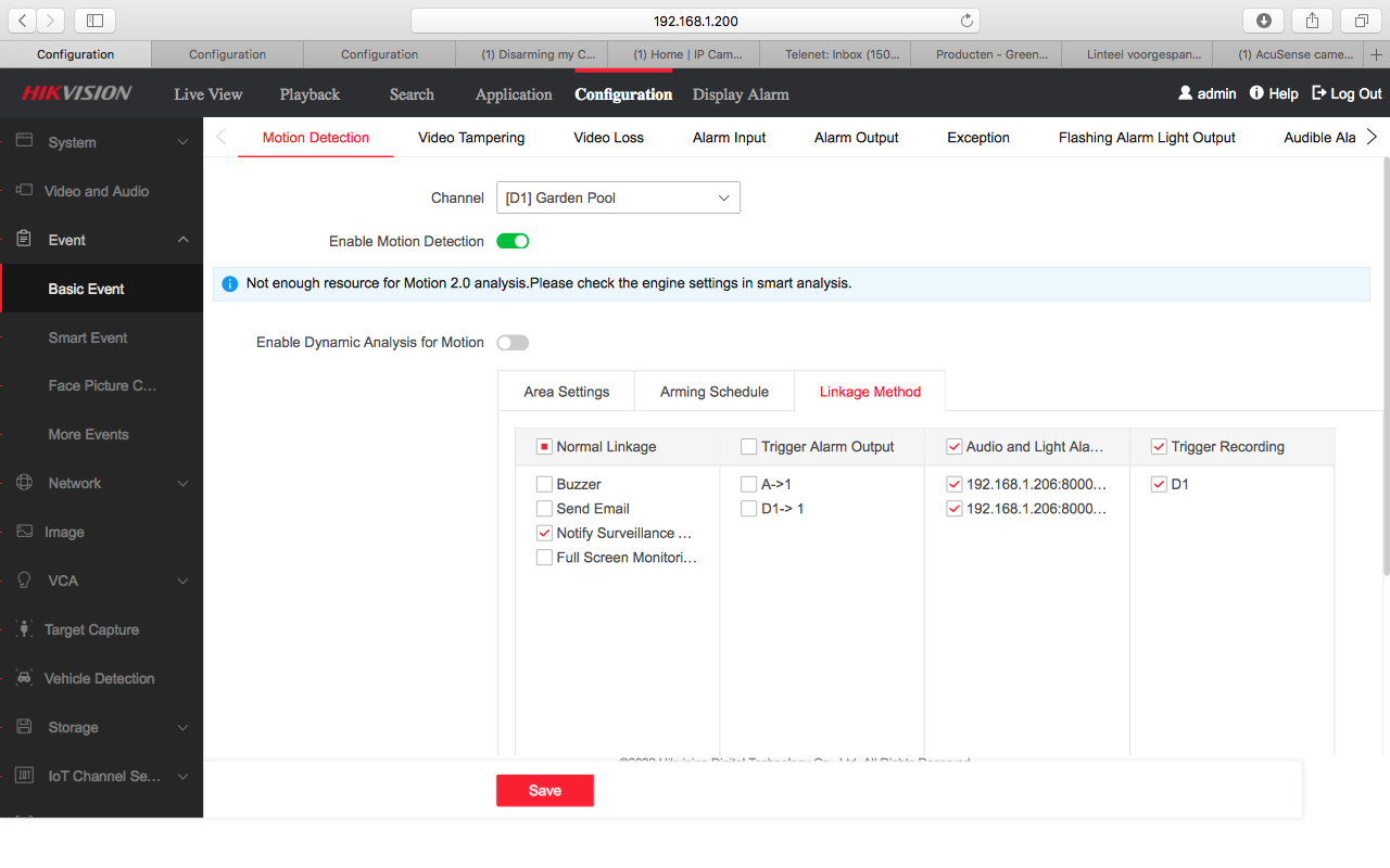

And still I get this message (not enough resource...)
And yes Enable AI by devices untiked

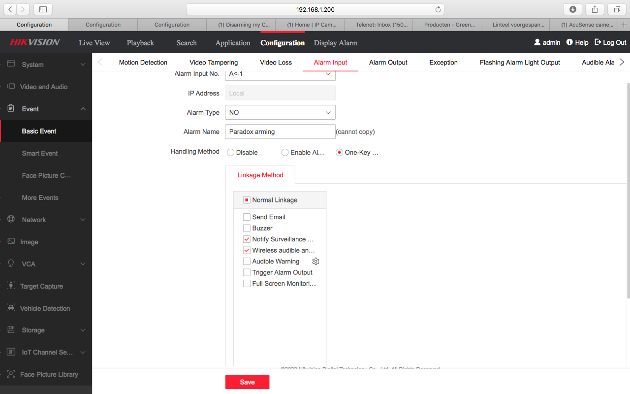

What should I enable in this screens to have His connect notification, audible warning and flash light, knowing I want to disarm this by NO contact on input 1 of the NVR? are those 2 screen correct? Because I have the warnings and flashlight, but the are NOT disable when the alarm input 1 is open.
To delete the previous configuration in the NVR AI engine you can't just untick the box. As I explained previously, while the box is ticked you have to delete the intrusion area and line crossing areas and disable them, only can you then untick the use device AI and save.
The options look to be correct on the other two screens.

But I still have that not enough resource message, strange, I did all you said. clear areas, disable everything.
At the moment I only have motion detection as event. Strange.

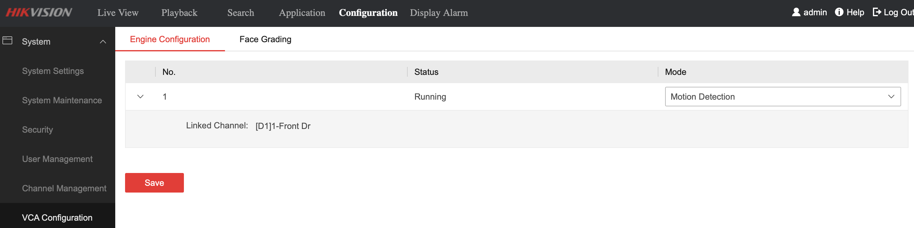

I think it's just the order that you've disabled/deleted things. Both the camera and the NVR have the AcuSense facility. So using Intrusion detection as an example, there are two configurations:
- with 'Use Device AI' OFF - you are using the AcuSense from the camera
- with 'Use Device AI ON - you are using the AcuSense (AI) in the NVR (and this is processed in the NVR AI Engine)
At some point you have configured Intrusion (or line crossing) with 'Use Device AI ON'. When you turn the switch off it appears to delete the intrusion area you set up; but it hasn't - it's just put it to the background and it is still in the AI Engine configuration. You can't delete the configuration for events that were configured while the switch was On when it is switched Off.
Try this and do it in exactly in this order, do not deviate! :
  1. In the NVR go to Intrusion detection for the camera and temporarily turn ON 'Use Device AI' and save
  2. Clear the Intrusion Detection area and save
  3. Turn off Intrusion Detection and save
  4. Repeat steps 2 & 3 for Line Crossing (in case you've added anything there) and also Motion Detection
  5. Turn OFF 'Use Device AI' and save
  6. If you have any other cameras connected to the NVR repeat steps 1 to 5 for the other cameras
  7. Go to Configuration > System > VCA Configuration. There should be nothing running (sometimes it takes a little time for it to shutdown)
With all of the above completed you should be able to set your event(s) up again for the camera without restriction. It should be possible to use Motion Detection, Line Crossing, Intrusion Detection simultaneously as with the 'Use Device AI' switch off, the camera does all of the processing.

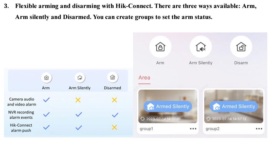

Arm - Enables push notifications, events and audio/strobe light alerts for the specific area (so long as the audio/strobe alarms are within their time schedule)
Arm Silently - Same as arm, but the audio/strobe light alerts are disabled (annoyingly it does not disable the push notification)
Disarm - No events, no push notifications

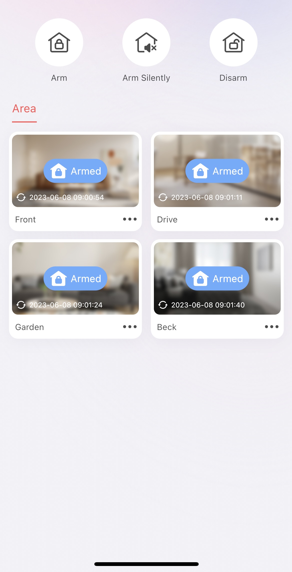

I have the M series and also have the function, I've created areas 'Front', 'Drive', 'Garden' containing each locations cameras (as shown in pic).
