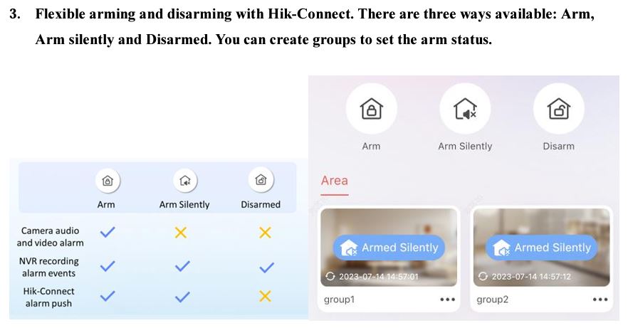

Found this in release notes for NXI-K:
Yeah that’s pretty much how it should work but as described earlier in post 31 ‘Disarmed’ disables alarm events (no clips available in app). Also it would be better if ‘Arm silently’ disabled Hik-Connect alarm push. That would mean the event clips were available in the app but there would be no audible push notifications. As it stands, if you stop the audible push notifications (‘Disarm’) you’ve also lost the event clips on the app.
I’ll just accept it as a feature that doesn’t work for now.
Can I ask which app you are using? I've got the Hik-Connect app on my iphone but it doesn't look like this, and it doesn't have these 'arm' or disarm options. I have the 7604-NXI-K1 with the DS-CD2387G2-LSU

It does. However there are now multiple NVRs and DVRs where it's possible to split the cameras into zones, arm and disarm the zones and arm the zones silently (disabling the strobe/siren where present). That functionality is in Hik-Connect and the firmware is standard release not customised. You don't have to have Live Guard (ISU/SL, LSU/SL) cameras to use the functionality; you just need a model of DVR/NVR that Hikvision has added the functionality to.
