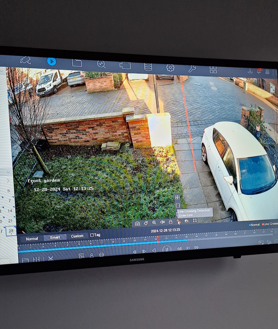

makes me think that it's working similar to yours as it should in playback. The issue is doing a retrospective VCA/motion search where you define a line on screen during playback. It should (using the dual VCA and save camera VCA) display anything that crossed that line, human, animal or otherwise. It's that search that doesn't work for him.
No mate. Mine does that. What doesn't work any more is the line crossing detection line drawing option on play back. It doesn't show any triggers anymore.

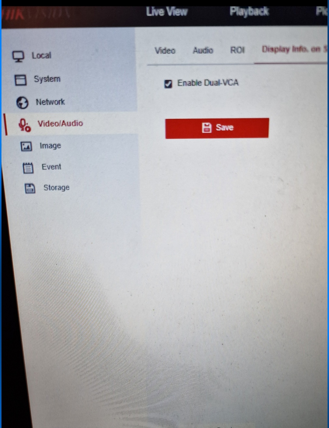

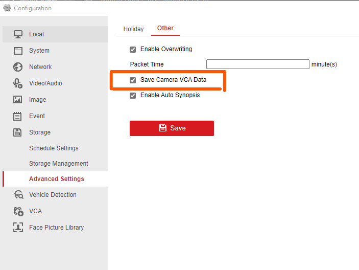

You have to go on NVR GUI Configuration-Record-Advanced-Save Camera VCA Data or something similar
or goto
nvr web browser:
Yes the above option was added into firmware without warning and with a default of off, meaning that the search function just stops working until it's enabled. 'Enable Dual VCA' ensures the camera sends the data but unless 'Save Camera VCA Data' is turned on, the NVR just discards it.

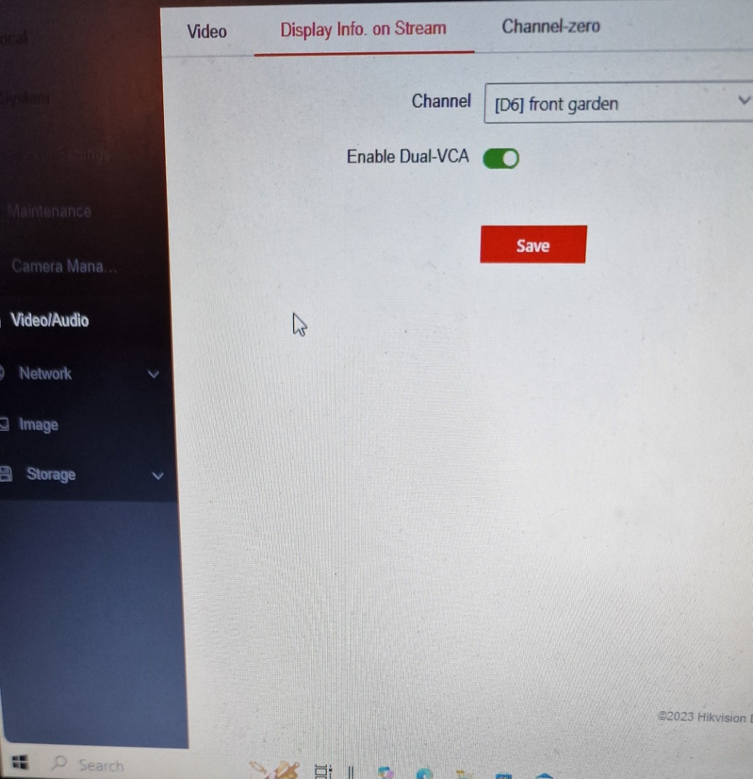

Hi JB. You gave me a good idea for testing. By disabling one at a time for v5.7.19 :-) :-)

Thank you. It wasn't ticked in local nvr. I have done it now so will check it tomorrow and see if line works. I have unchecked basic events though but left all smart markers checked.
It should be fixed and would be noticeable straight away as you'll see markers appear after the time you made the change when you search.
Sorry. Disabling, all combinations Dual VCA and Save VCA Data, didn't work for me :-) :-)
Yes it has worked. Thank you all and likewise thanks for your patience over the last couple of days.
