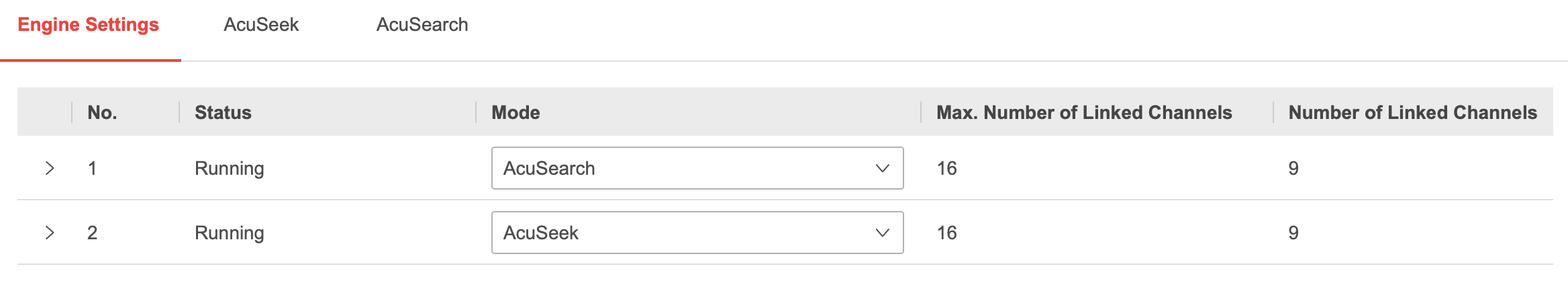

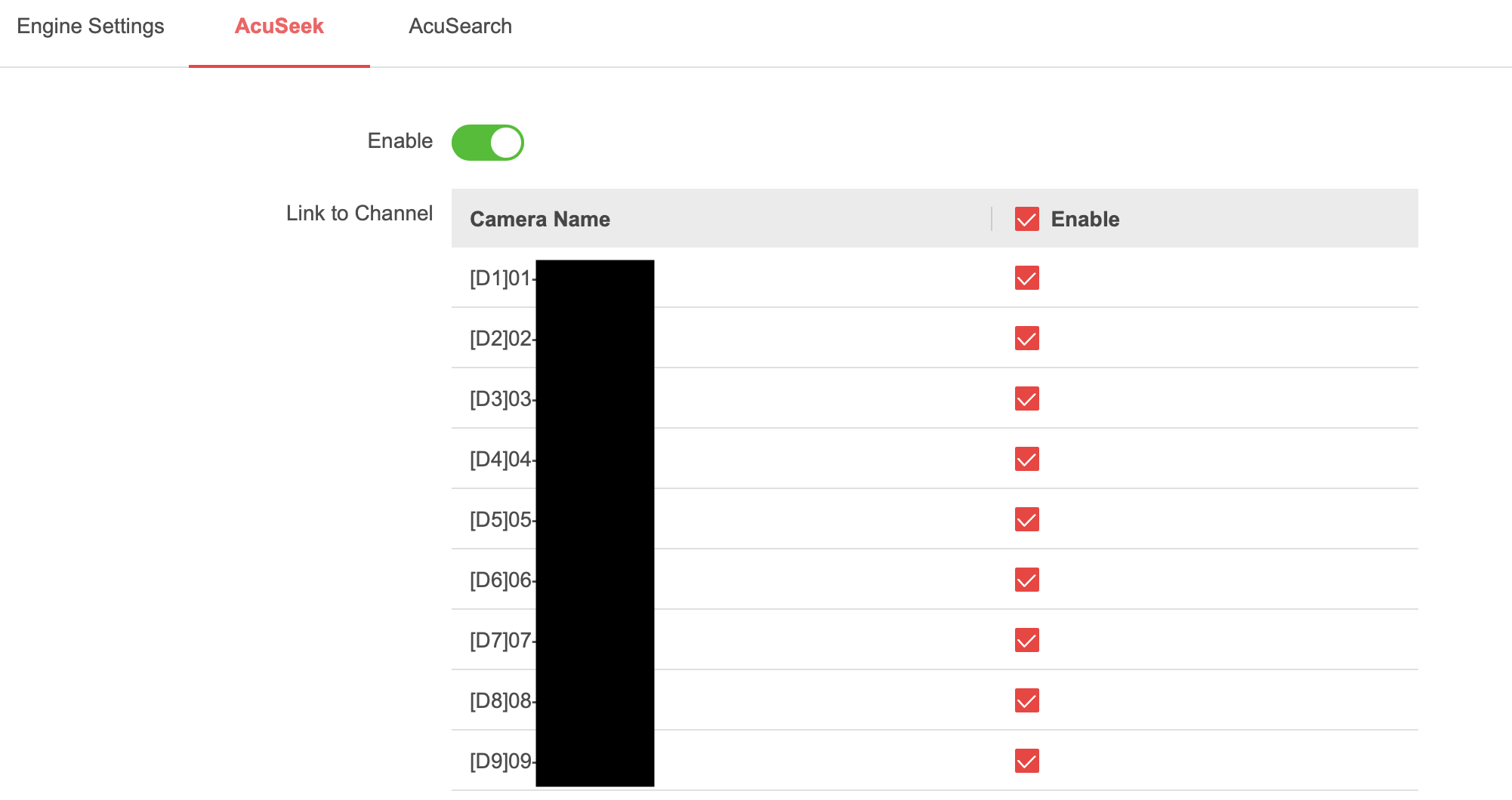

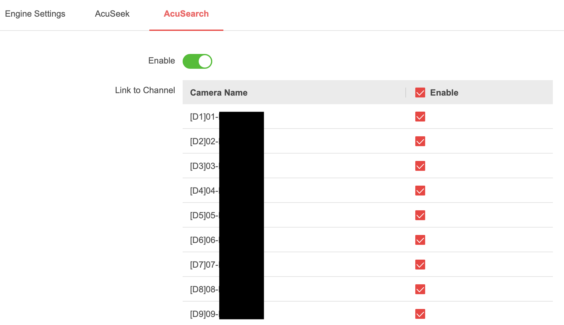

Had another issue yesterday. An unexplainable failure of the AcuSearch function. AcuSeek continued to work normally but on local UI, web UI and Hik-Connect AcuSearch would fail to find any targets to search despite there being people and vehicles in view. The photos below show the setup with both engines in use - one for AcuSearch, one for AcuSeek and all channels enabled:

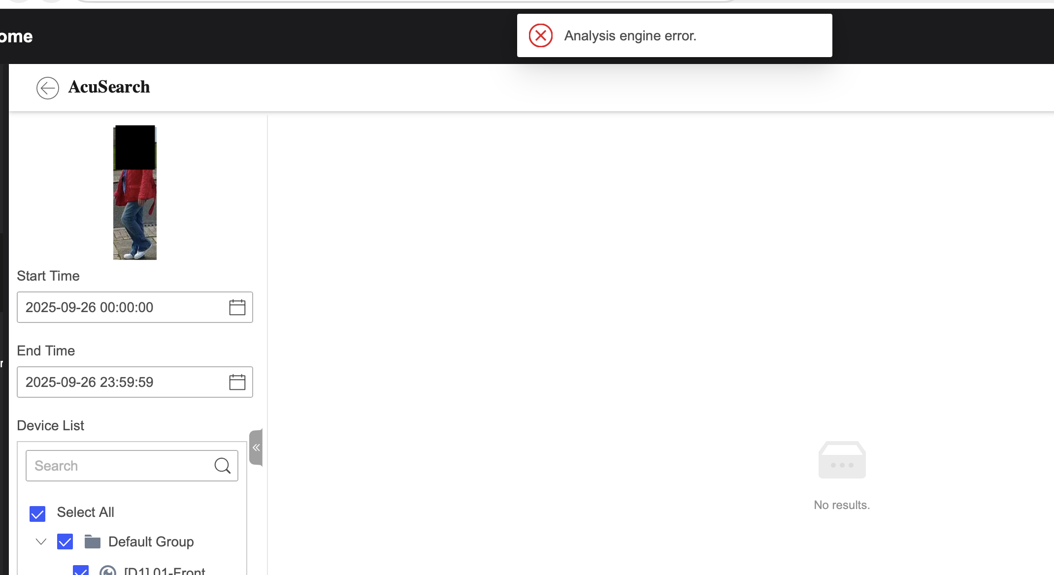

On the local UI a message of 'failed to find target' or similar was displayed, on Hik-Connect it just timed out while the web UI displayed 'Analysis engine error' after a short time. The image shown below is the result of a successful AcuSeek search followed by the AcuSearch icon being clicked on the result. In the local UI and Hik-Connect it would not recognise that there were any targets present to search:

I didn't try a normal reboot, but a shutdown and power cycle from the local UI resolved the issue.
