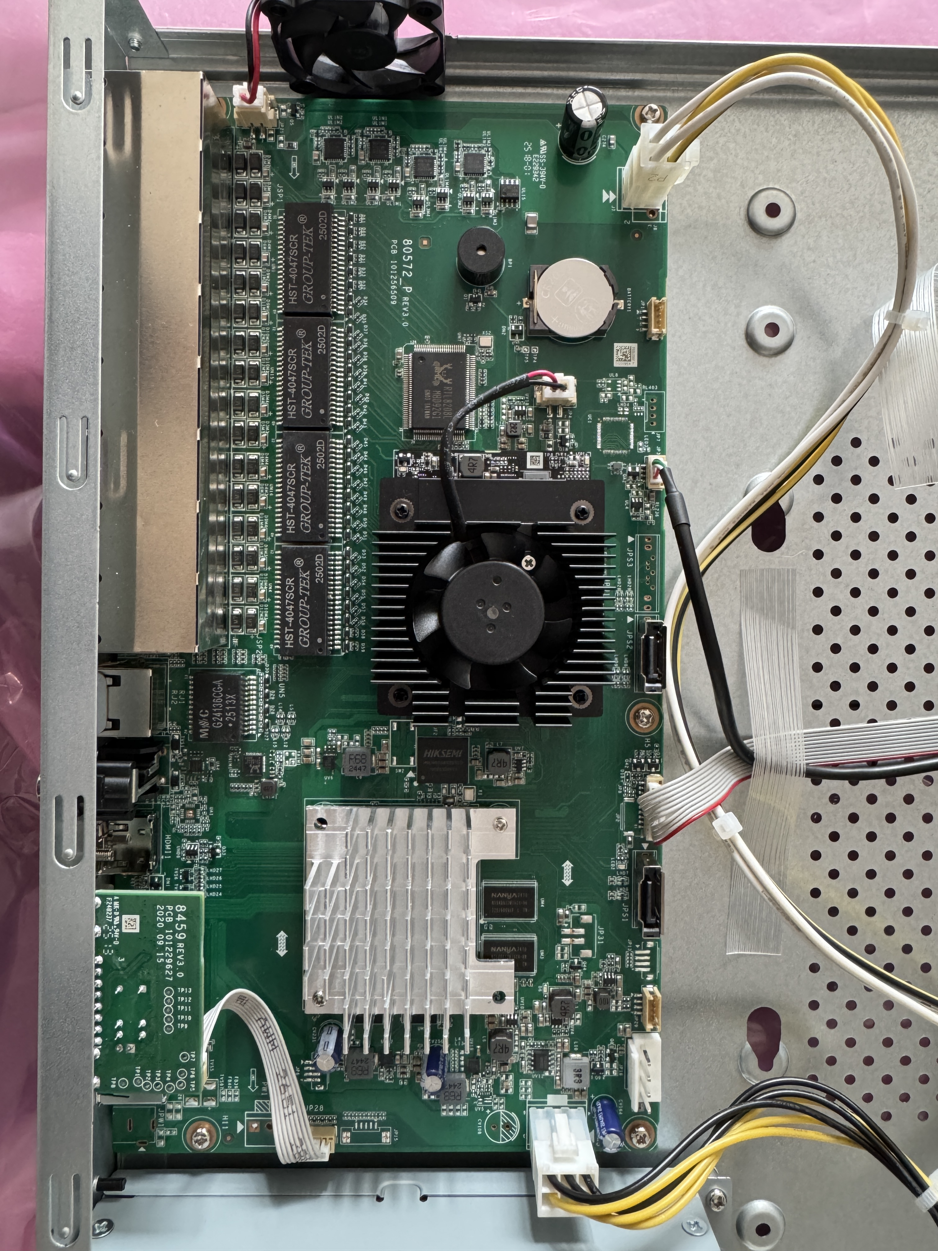

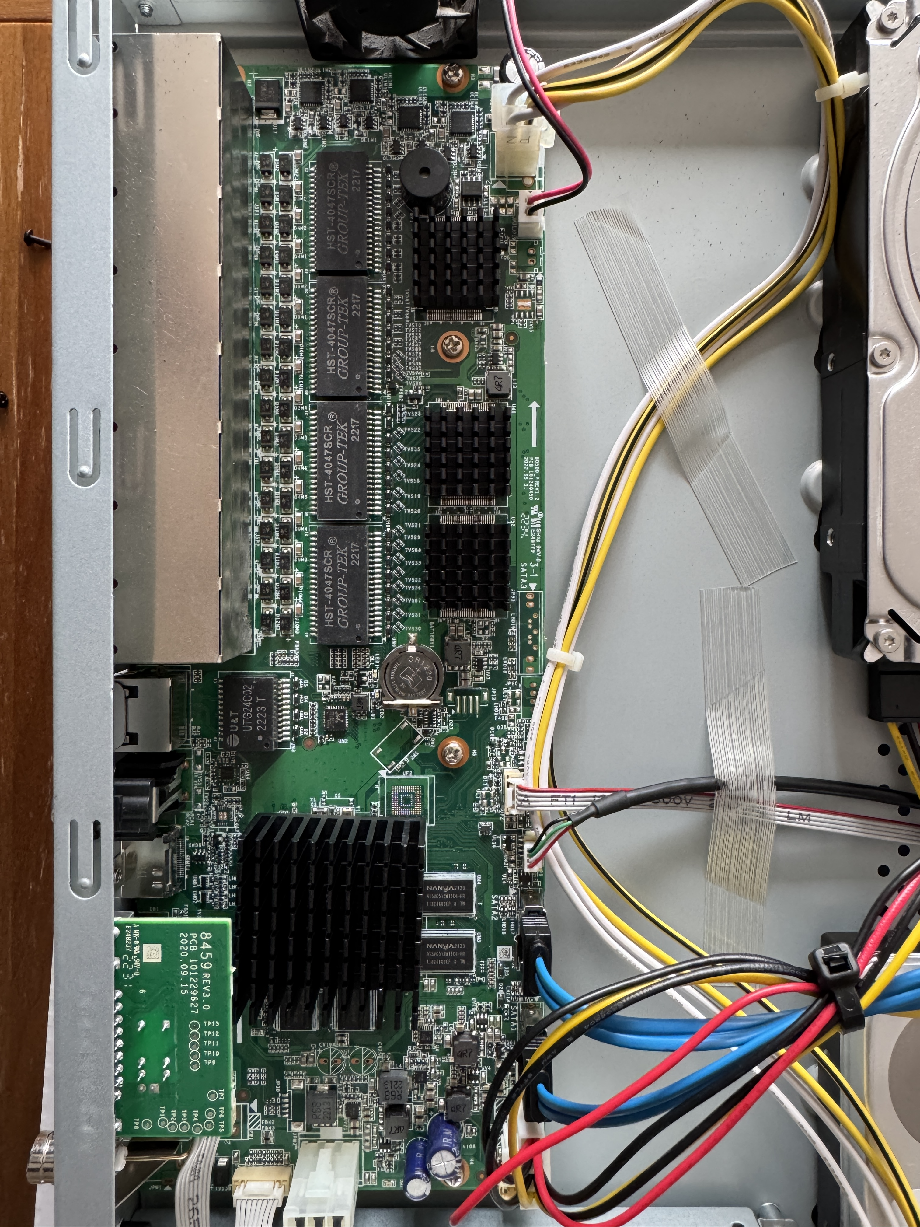

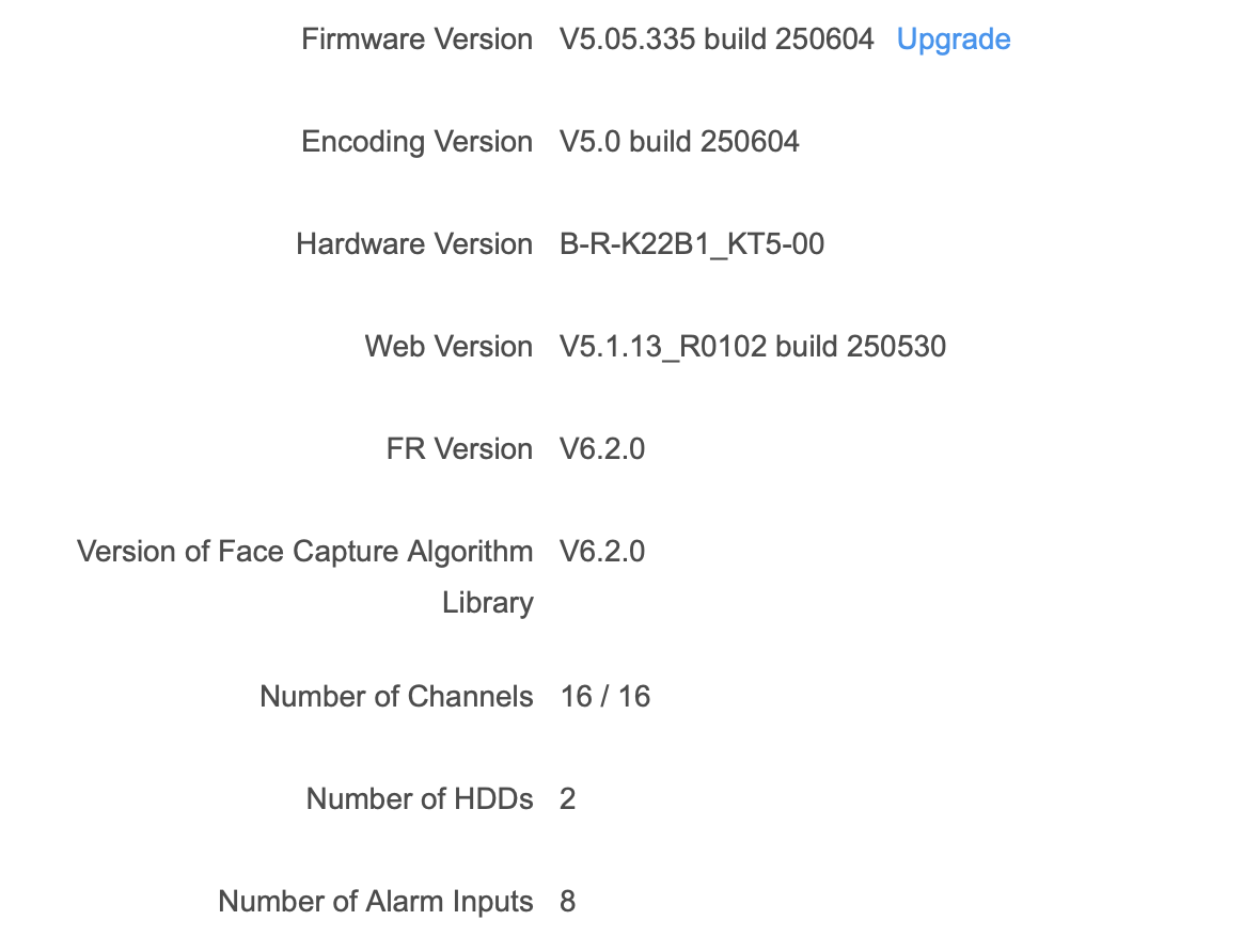

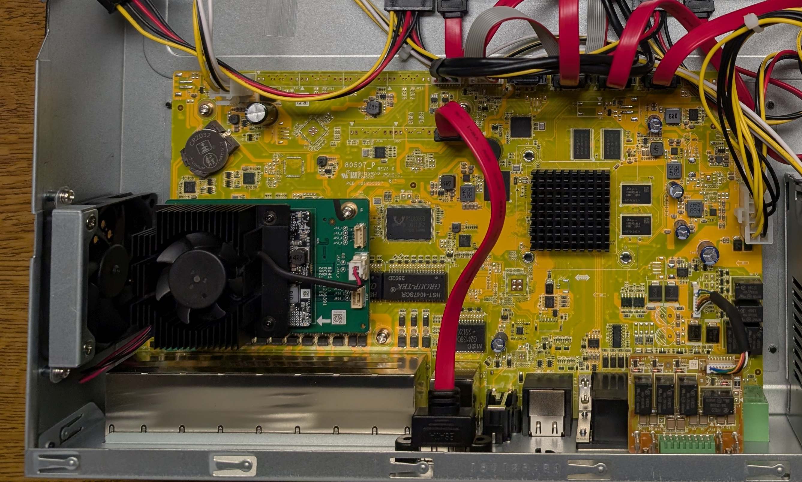

Mine has come shipping with V5.05.335 build 250604 which is the same as yours was running. The board in the 32ch. looks quite a bit different too.

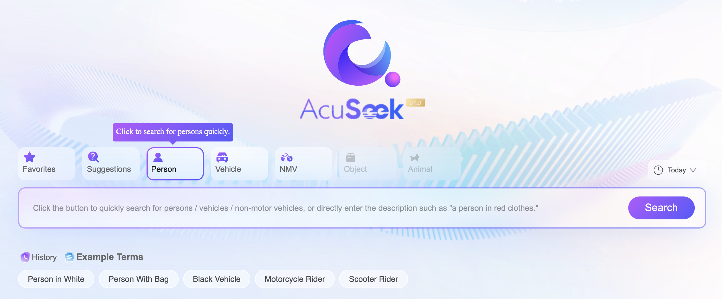

I think you need to go to .351 to get AcuSeek working on Hik-Connect. Then .361 adds Perimeter Protection engine (as all NXIs have for non AcuSense cams) but using that will be at the expense of losing AcuSearch and AcuSeek as there are two engines, you cannot have Search without Seek (and vice versa), plus each uses its own engine. Really these models are only good for use with AcuSense cams as a third engine would be needed for Perimeter or motion2.0.
