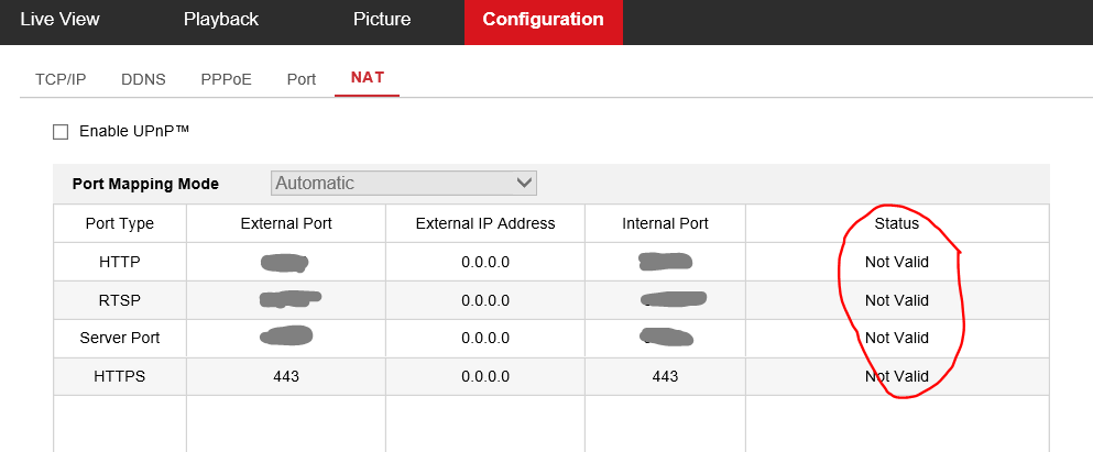

BTW - just checking the NVR via web browser... to confirm if the reset hasn't altered the settings you gave.
Does this below look correct? Especially the status?

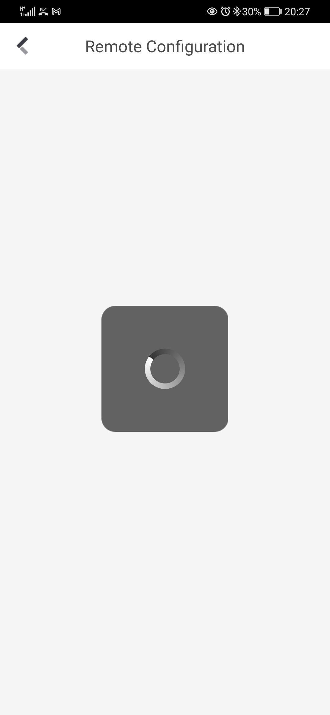

So on mobile network I was able to configure DDNS - entered the ports, admin and password. Was able to save successfully.
But if I click on Remote configuration it just keeps processing - the wheel of death - see below.
As an additional check, tried renaming the NVR alias name on mobile network. Didn't work. Same error as before.
I'm about out of ideas on this one now JT. Once DDNS Configuration is completed in the app it should work normally as it allows login to the NVR via the service with your admin user password. As you've made further changes - I'd just try (in this order) logging out of the service on the app, reboot the NVR, once the NVR is back up and showing Hik Connect status as online, log back into the Hik Connect service in the app. There's nothing else I can think of unfortunately.
