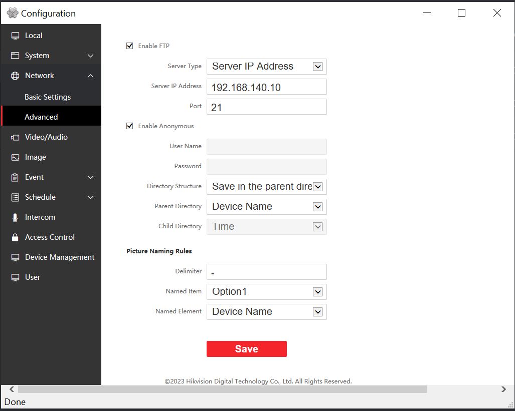

@NoFate, thanks for your very kind offer of checking out FTP. I've attached a copy of my FTP config on the camera. If you can confirm this works, and you have NTP working as expected, that would reassure me it's not an issue with the firmware version.

Just tested FTP, enabled it, enabled motion event, but indeed , it doesnt do anything, doesnt send image on ftp when motion is detected ; or not even when call is detected...
I dont see any connection coming in, so not sure why that feature does :-)
My guess, since 8003 needs an indoor, and images are saved on indoor, it needs to be enabled there, alltough i dont see any ftp settings there

So good news is the camera appears now to be working correctly. Bad news is that FTP really doesn't seem to work as @NoFate has also established. Disappointing as that's my preferred mechanism for getting images back from a remote location. Also disappointing Hik support hasn't come back on this. Guess I'll be waiting for the next firmware release int he hope this gets fixed.

So....I kept working on the FTP issue to QNAP because I don't like to be beaten and have it working (sort-of). Wanted to come back here to share the experience for anyone else who has the same issue. The spoiler though is that FTP only seems to upload pictures when triggered by a door event (Door Open from Indoor Station, Door Open from Keypad) and motion detection events are not uploaded. If anyone has a different experience I'd be very interested as my other Hik camera will definitely upload events using FTP.
Looks like the 8003 wants to create the directory it is going to write to on the QNAP (I had created this manually). If you ask it to write to a directory (unless that directory is root for FTP as defined on the QNAP) it gives a login failed error, no matter what access privileges it is granted. A quick summary of settings:
- 8003 is pretty vanilla with a username and password defined, rather than anonymous login. Directory Structure>Save in Parent Directory; Parent Directory>Device Name
- Key parts of QNAP config are: FTP support>FTP (Standard); Unicode Support>No. Root directory for FTP is specified under the Advanced tab. If you;re not using Anonymous login make sure User IDs used for cameras are granted privileges for th Root!

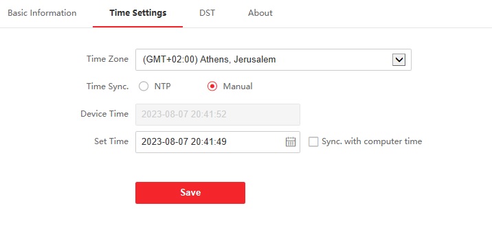

Have you managed with NTP? I have the same issue with the NTP server, which doesn't work. I set up NTP to 0.pl.pool.ntp.org, but it is not synchronizing. Additionally, when I go to synchronize with the local computer time zone is going to change to GMT+2 Athens, Jerusalem, which needs to be corrected. My time zone is GMT+1, the same as my PC.
When I changed the time zone to GMT+1, I immediately lost connection with Indoor station DS-KH9501. The network status goes to not connected, which is a registration failure. After that, you cannot ring from the door station, it says the speaker cannot connect.
I also realized that when I changed server port on DS-KD8003 from 8000 to personalize, 8080 door station changed to after some time 8000. I have no idea how it possible but it was. Today I changed it to default 8000.
I would appreciate it if anyone of you had an idea of what could be a solution and could share it.

Hi Greg, I share your frustrating. NTP is working for me but I'm not completely sure what got it up and running. As bizarre as it sounds, I think defaulting the motion detection area got rid of the invalid parameters error and may have resolved it (I've had similar issues with other Hik cameras). After that I'd probably try a different NTP server (Google or specify a non-country specific pool.ntp range) just to eliminate this. Then a reset. Let us know how you get on. Cheers
Hello, thank you very much for your answer. I tried your solution today but have yet to see a visible change. Besides that, I lost connection with the indoor panel again. This is so stupid that I have never seen it. Dahua is the same story as here we have. For example, you can not change the default password from admin :/
My device works with an artificial Time Zone synchronizing only with the panel with this solution.
