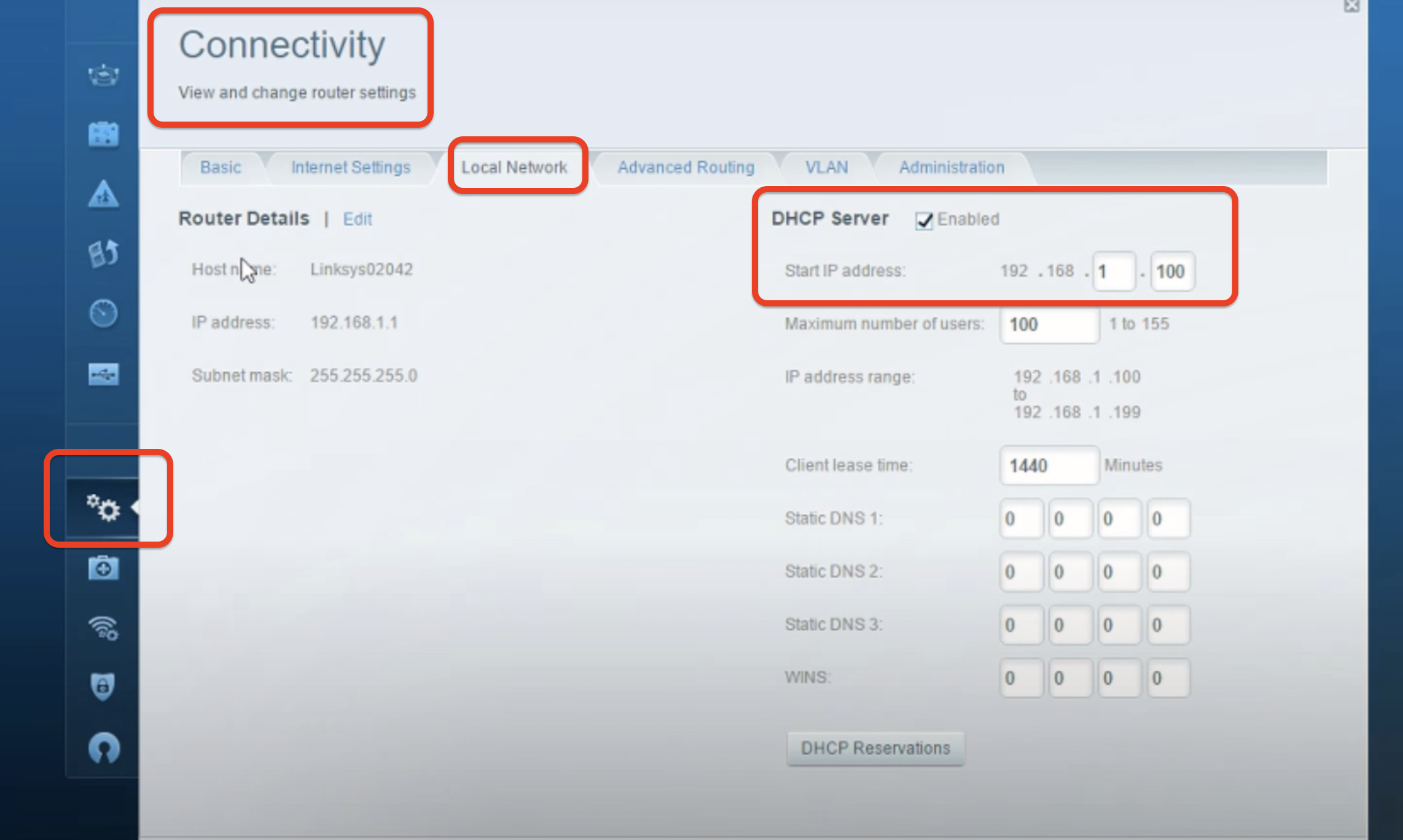

I want to make sure the IP addresses I gave you are ok.
Can you log onto the IOTT router and post a screenshot like this, red squares not needed? Or just let me know the DHCP server start IP address.
