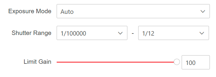

As Kyle mentioned, he'd left that camera on its default settings; Auto Exposure with 100% gain, 1/12sec exposure time (will cause image blur), H265+. I do think that the G3 provides a clearer image than previous models; better colour image day and night, brighter and sharper mono image when theres no ambient light. However I'm not seeing any drastic changes or improvements to support Hikvisions claims in their promotional material:

The slow exposure time doesn't explain why the writing on that sign was completely missed by the G2.
Edit: Actually, looking at the G2 picture again the highlights are over exposed compared to the G3. That would explain the missing detail on the sign. There's a shop with lights on to the right of the truck , and the whole shop is a blown out mess on the G2, it's better on the G3.
Both cameras need a lot of tweaking to get a meaningful idea on any differences.
