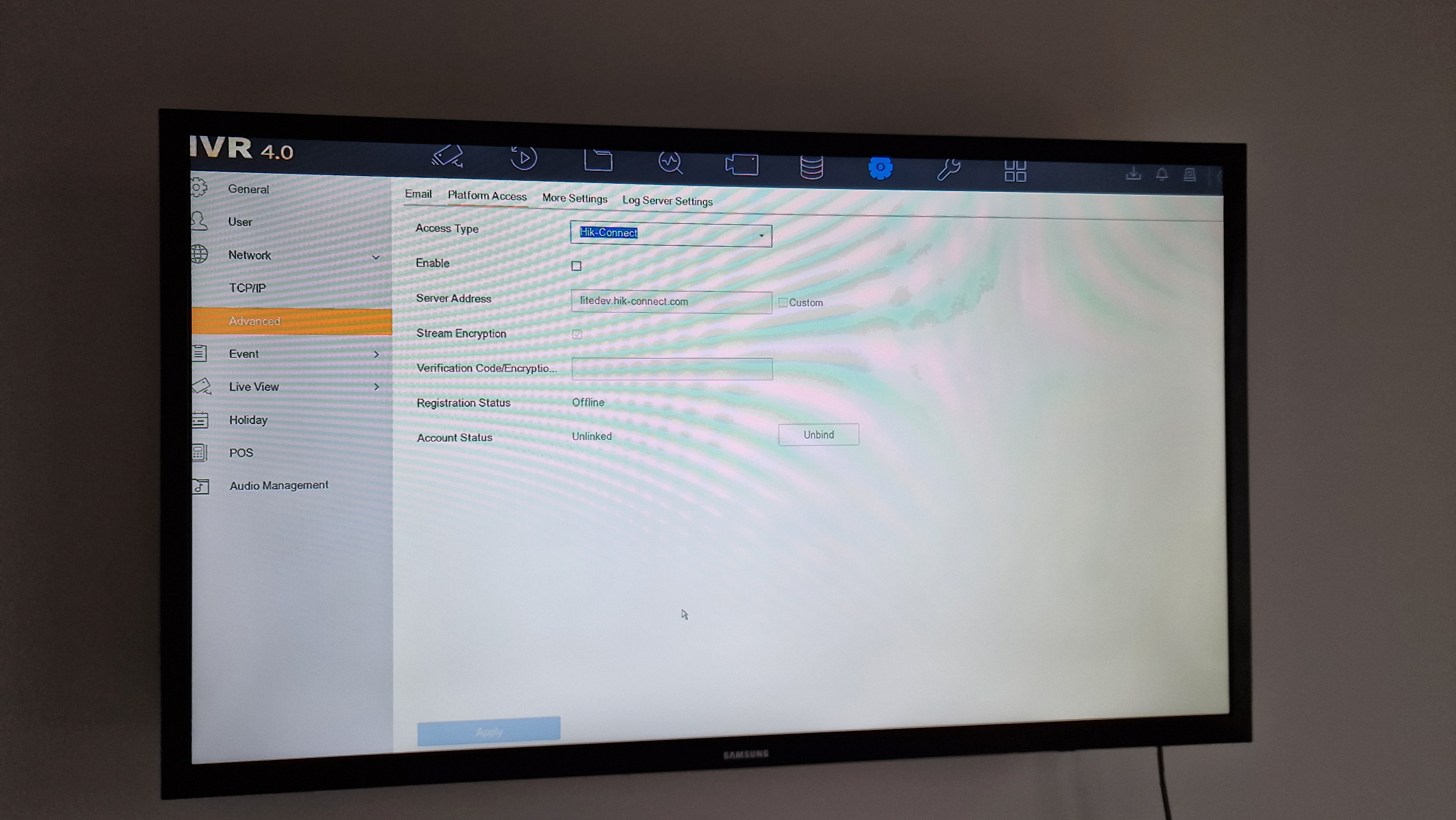

It's not ticked in the nvr menu now. And when I tick it asks for verification code. Hik connect just shows offline on all cameras.

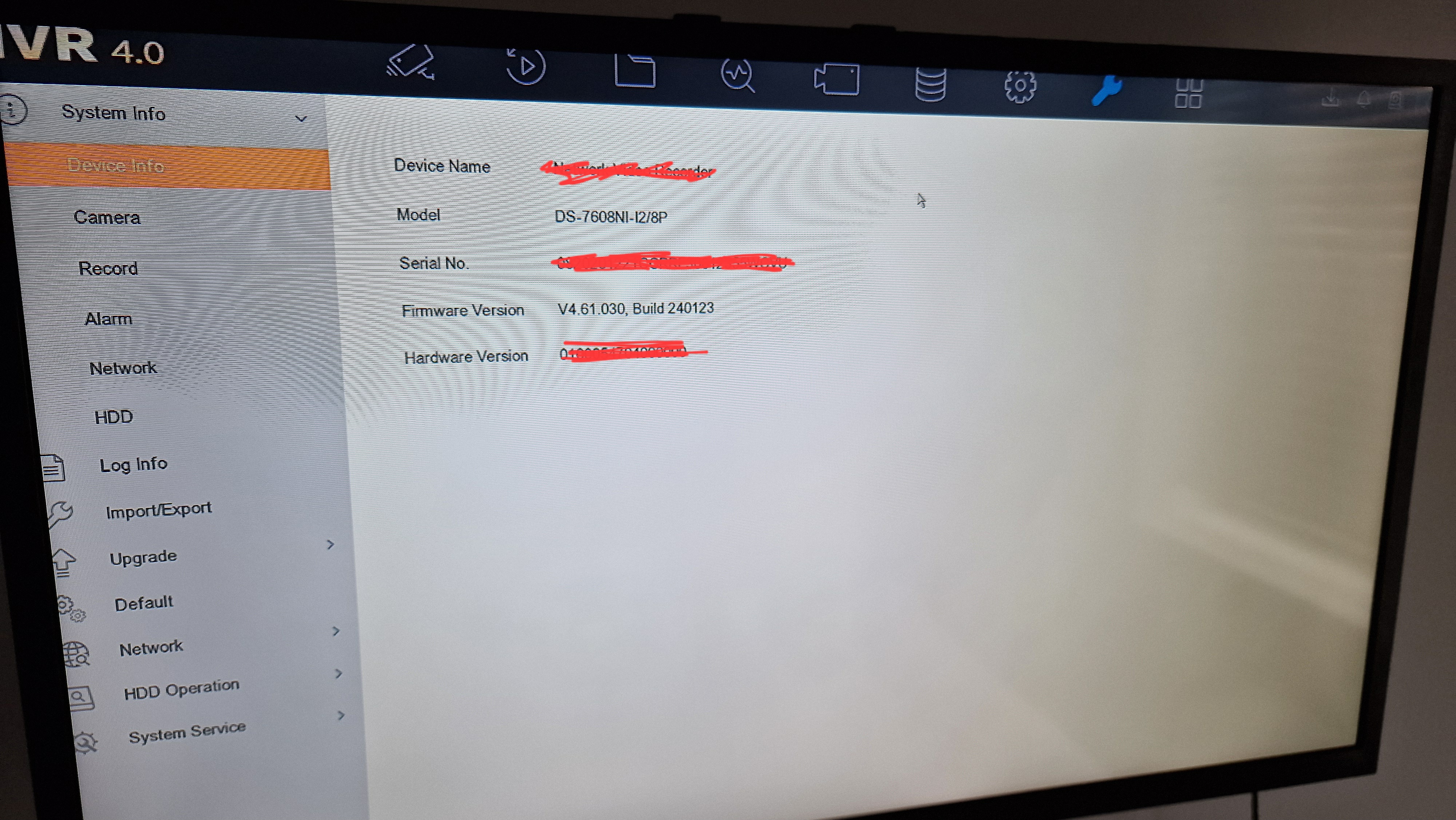

I'm in the process of updating all the firmware then will take a look at this. See if it dropped it out.
Just uploading 61020 at moment

In HikConnect app all cameras are offline after a Clear Data or uninstall - reinstall the app and verification code is always necessary to Live view stream.
In NVR GUI (Menu) under Network-Platform Access if Enabled you can see(if eye is pressed) the Verification Code or you can change the Verification Code.
It's updated now. Will leave the cameras for another day lol.

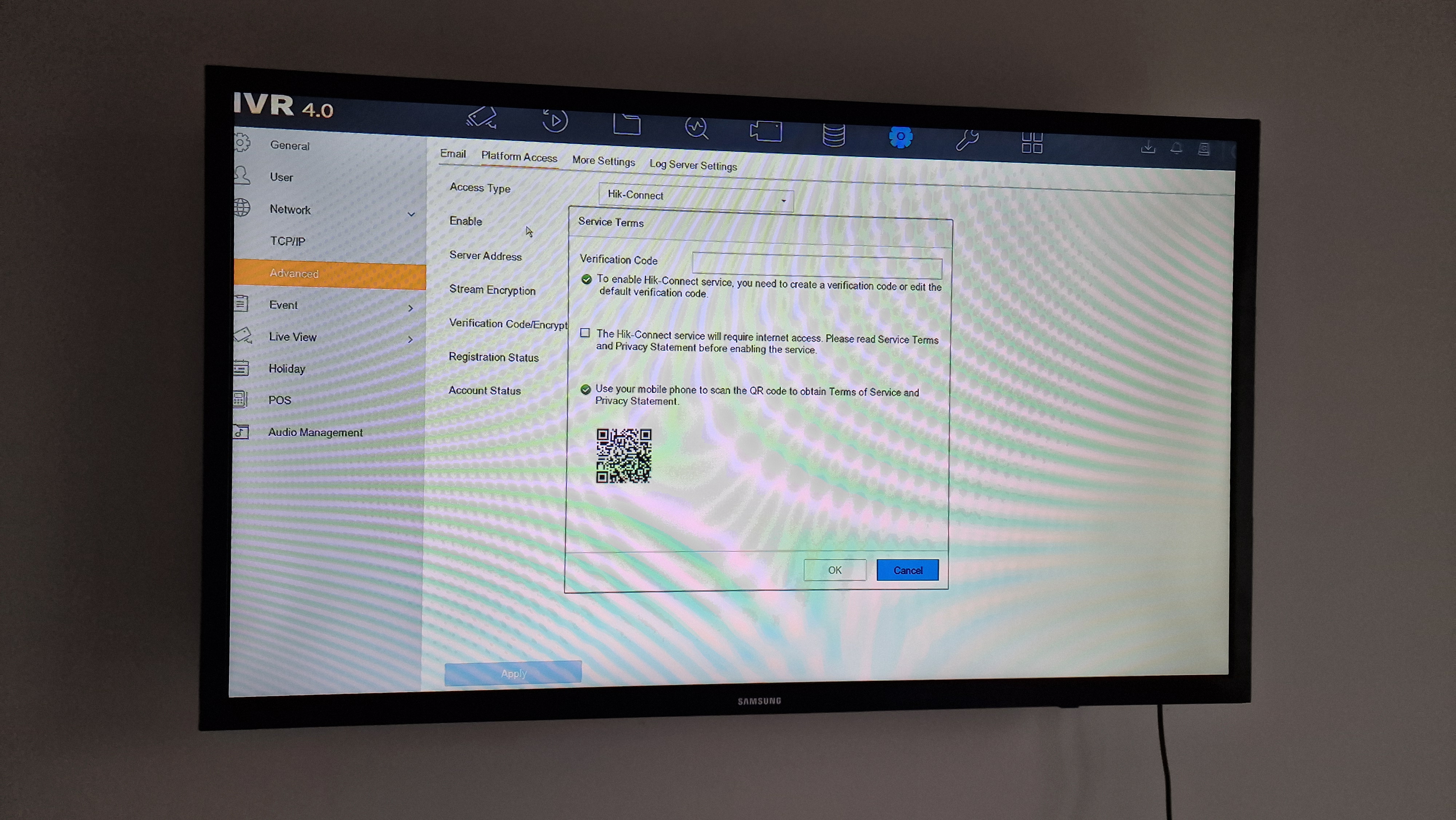

Where do I find my verification code to enable hik connect? I presume i will need to re install it again?
I suppose that last picture shows that you need to create a new one Verification Code. But you can use the same one you had in the past. In any case you need to add one. Otherwise there won't be live stream. I don't know if there is an option to disable Verification Code on your NVR but I think it's not safe
I don't remember ever doing 1? Unless there is a default?
There's not a default, it always makes you set one when you enable Hik-Connect, but it's probably reset :)
Hopefully, the cameras will come back online once you've set the new verification code and enabled Hik-Connect again.
The app will probably ask you to enter the verification code when you try and view the cameras.
You can disable it again (once it's set and Hik-Connect is showing as online) by unticking the 'stream encryption' box on that platform access page.
