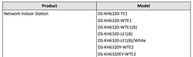

6320-WTE1 is all the same like 6320-TE1. Only difference is that WiFI module JB1970 said. Both of them works with KD8003-IME1.

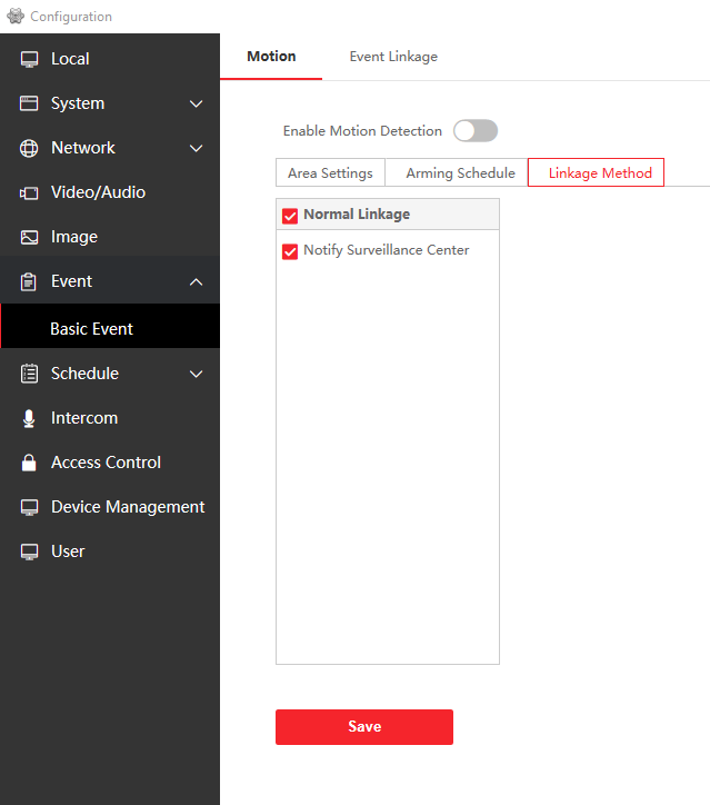

Just go to the units IP address in a web browser and log into it and go to Configuration > Basic Event to switch it on and set up. Unfortunately it's only standard motion detection (no AcuSense) so you'll probably get a lot of nuisance activations.
I adjust it in the ip address, but it's not working, I enable the motion detection and set schedule, but there is no alert.
maybe i should connect directly to the outdoor unit and not the indoor unit?
what is the difference between the event and schedule, should i set the schedule also?

You won't see motion detection event from outdoor unit on your phone. You could see it if you are running IVMS, but not trought your mobile app.
I don't understand, there is a motion detection for 6113-WPE1C?
but I can't get an alert on the mobile? what is IVMS, as I set it in the IP address as been told.
can you pls guide me how can I get an alert of motion to the app, and should I connect the app to 6113-WPE1C or the monitor?

Is your outdoor unit on hik-connect or is your indoor unit on hik-connect?
My bad, i tought you have modular outdoor, not villa door.
Is Notify center on?
my indoor unit connected to the hik-connect.
the notify center is on and I schedule the event when to work
enable hik-connect on outdoor unit and add it to hik-connect. Then see if you will recieve it.
Finally - i manage to set it as an online. Thank you for you patience. Next question is - how to set it comunicate directly with a Mobile phone. Is it possible? Tutorials on The Internet use internal monitor to achieve that.
