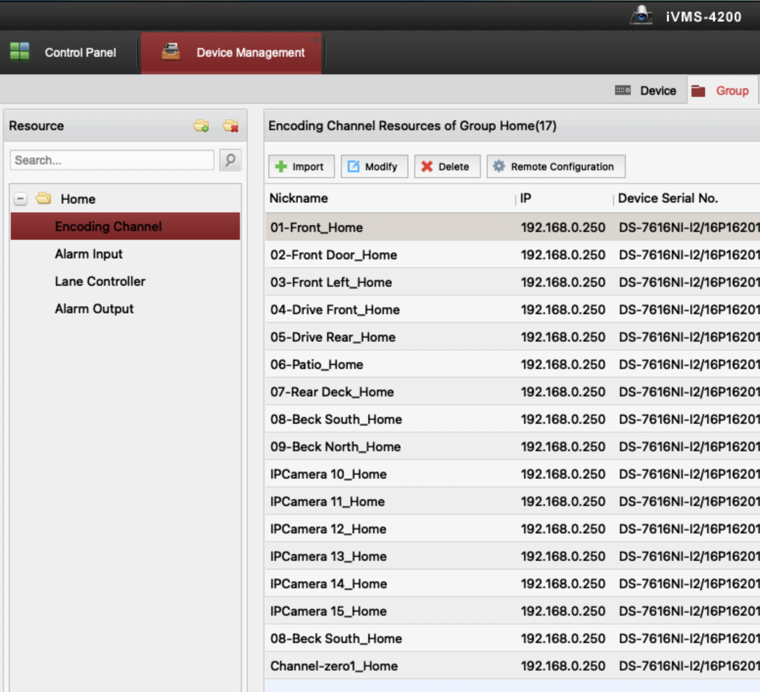

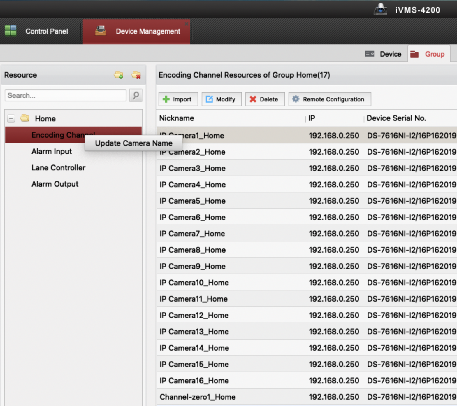

It possibly is with Hik Connect. I have an I series NVR so don't have the issue. However iVMS-4200 software requires that you update the camera names as I described in the other thread. To that end it doesn't matter what NVR/DVR you have, what firmware it's on, what version of iVMS-4200 you are running and whether you run it on Windows or Mac - the process is the same. The photos show before and after on my system.
What version of iVMS-4200 is this? Mine doesn't look the same. It is version 3.4.0.7. Possibly it can be an issue with the latest version of iVMS-4200 itself?!

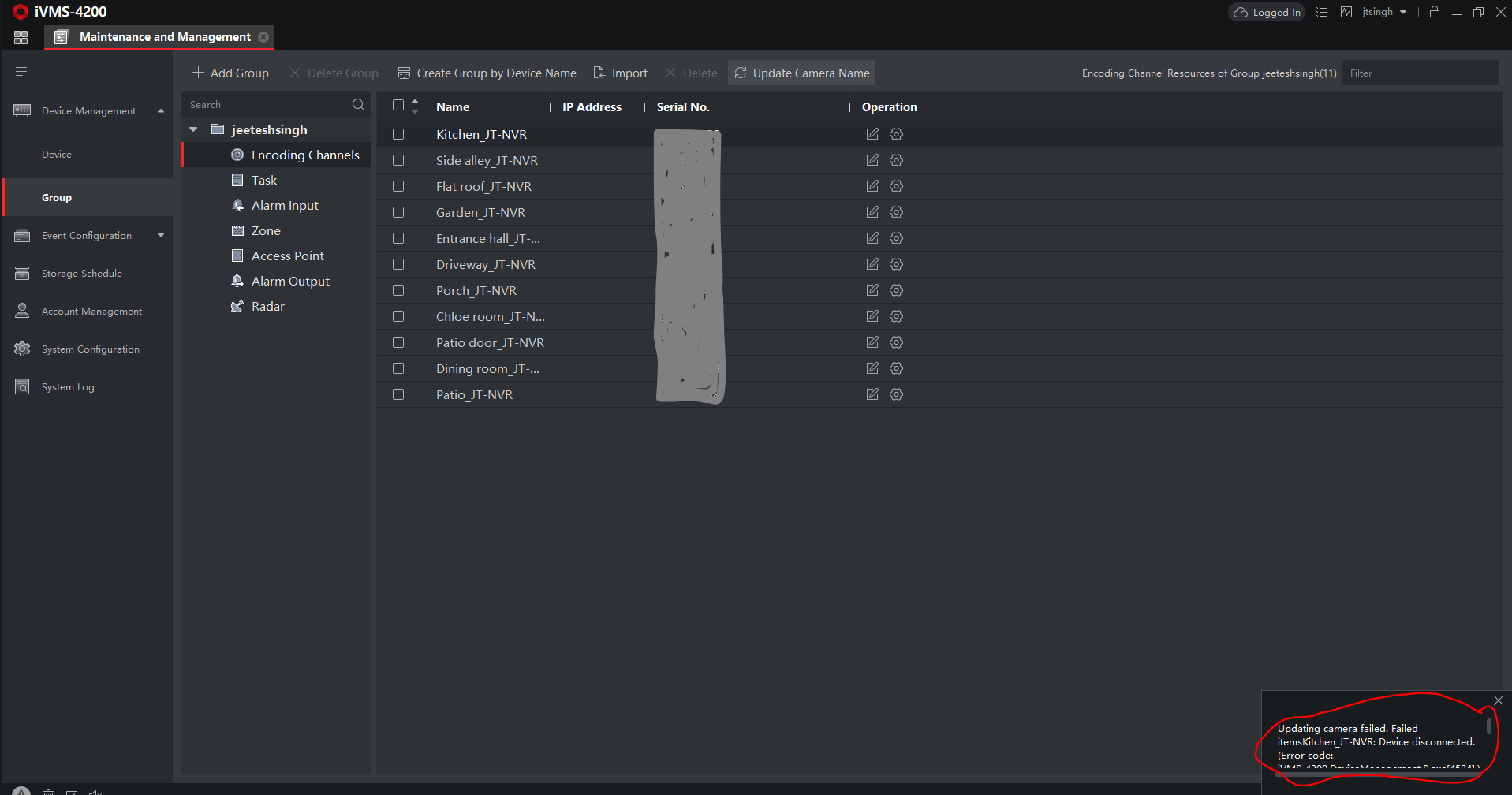

I now see the camera names but I think that's because I updated them on the Hik-Connect App. But even now if I try to Update Camera Names it gives me an error (see right bottom corner).

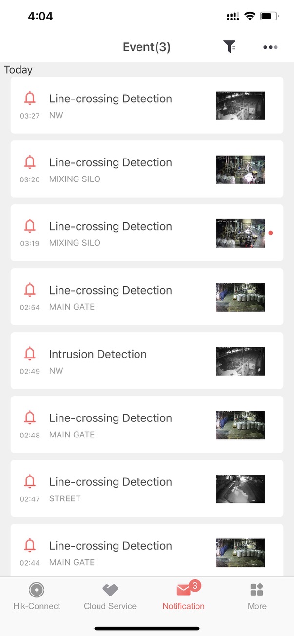

I want to use the full functionality of the hardware/software, but the events have a bad format. Instead of showing the camera name, it shows for instance camera1@DS..... bla bla bla.
I am sharing an NVR via hik-connect.com with an employee and on his iPhone everything is absolutely fine. The names of the cameras appear exactly as they should.
My solution:
1) I opened up a new account on hik-connect.com
2) I connected the NVR to this "new account"
3) I shared the NVR from the "new account" to my normal account and to the account of my employee
Now, everything works like it should. Check out the attache file.
If you need help, let me know.
I really hope it will work for you guys.
