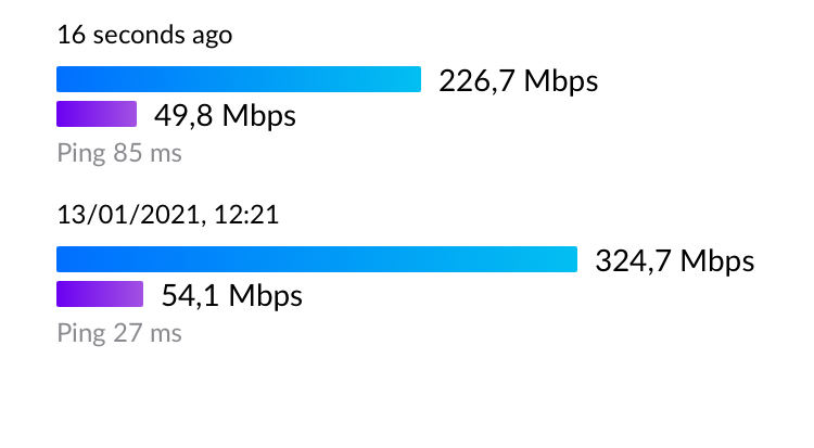

I did the same, but still after restart of NVR everything works perfectly for about a day and then no playback possible anymore. Installed IVMS-4500 on my iPhone, same issue. Can it be related to the hik-connect server?
Only other thing I could think is possibly if your bandwidth is in high usage and it cant cope fetching the video.
That cannot be an issue. Sufficient bandwidth here.
