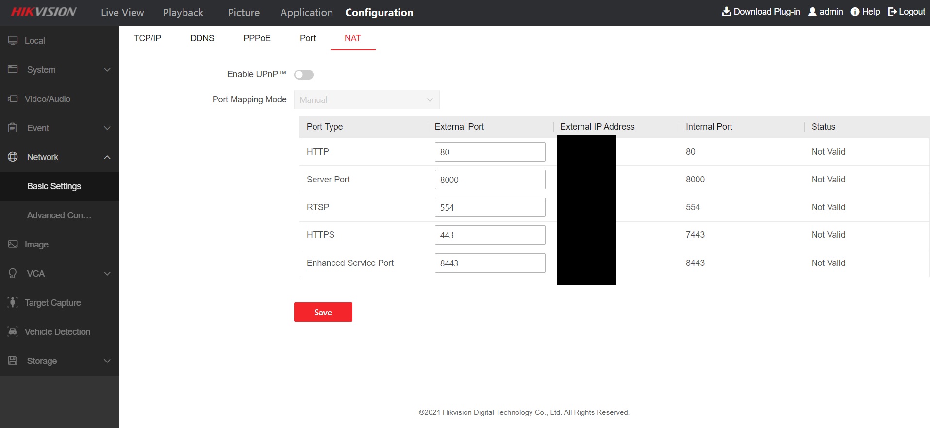

Oh ok, I wonder if you do need it originally set at 80 on the NVR to connect to the Hik connect server you then change it to the new http value in my case 8008 in hik connect then update the NVR the same, this also would mean disabling the current device that uses 80 in my port forwarding and making the changes.
Add to this i do believe when i first started remote viewing on my mobile device I think was using ezviz and later changed over.
Think i might be clutching at straws now tried it and still offline after doing changes then a reboot, think next step is a complete factory reset, i have also now made contact with someone at hikvision through email so maybe this might resolve the issue.

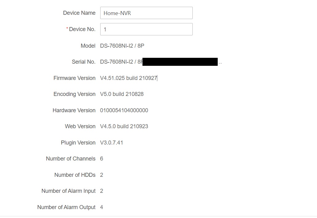

my nvr details
NVR DS-7608-I2/8P
Firmware V4.5.000 Build 210125

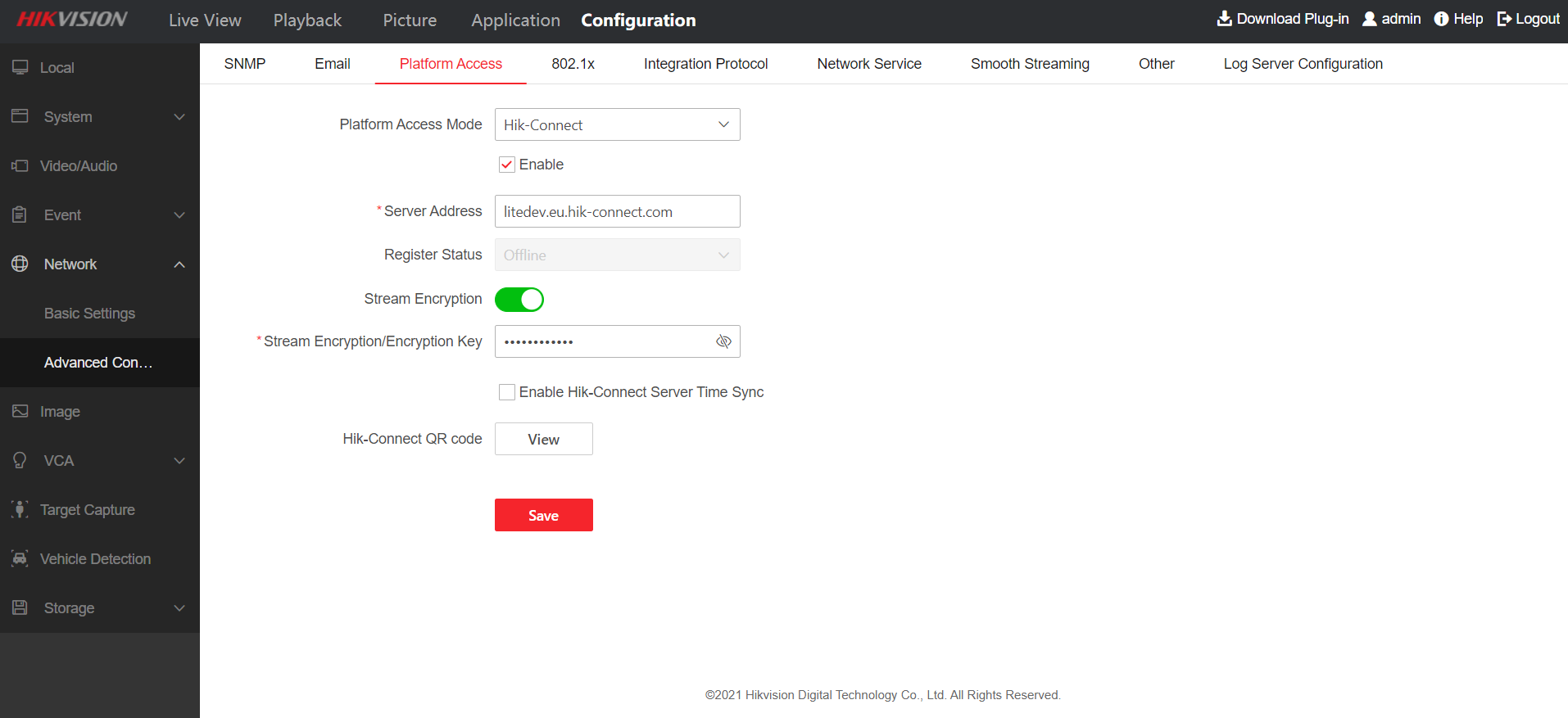

I've enabled the Hik connect platform and am online connected to server litedev.eu.hik-connect.com.
no related port forwarding rules on the router.

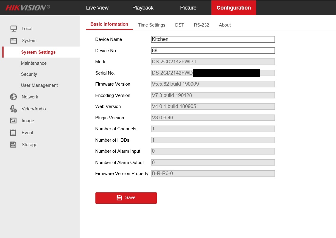

I am on V5.5.82 build 190909 wonder if it might work if i went back to same as yours? do there whole firmware versions i.e. V4.5.000 mean they are stable?

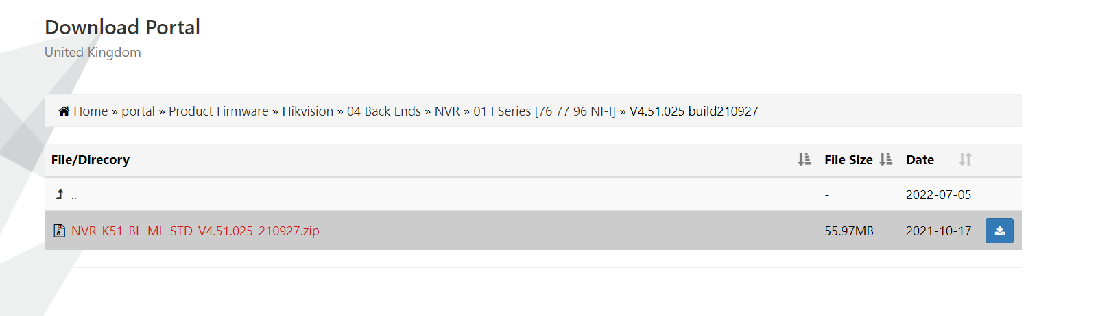

I think there is a discrepancy on our firmware versions, I believe the build number is in the format yymmdd. I cannot find your version on the NVR 76 I series EU or UK portals. Can you double check for me? Also what is your NVR model number? I thought it was the same as mine...
I think there is a discrepancy on our firmware versions, I believe the build number is in the format yymmdd. I cannot find your version on the NVR 76 I series EU or UK portals. Can you double check for me? Also what is your NVR model number? I thought it was the same as mineTaken f...
Taken directly from the NVR Model DS-7608NI-I2 / 8P

With no devices on my hikconnect account my NVR shows online / unlinked
Add NVR to hik account and its online / linked, delete NVR and its online / unlinked
Changing HTTP or server port numbers makes no difference to the above. NVR not rebooted.

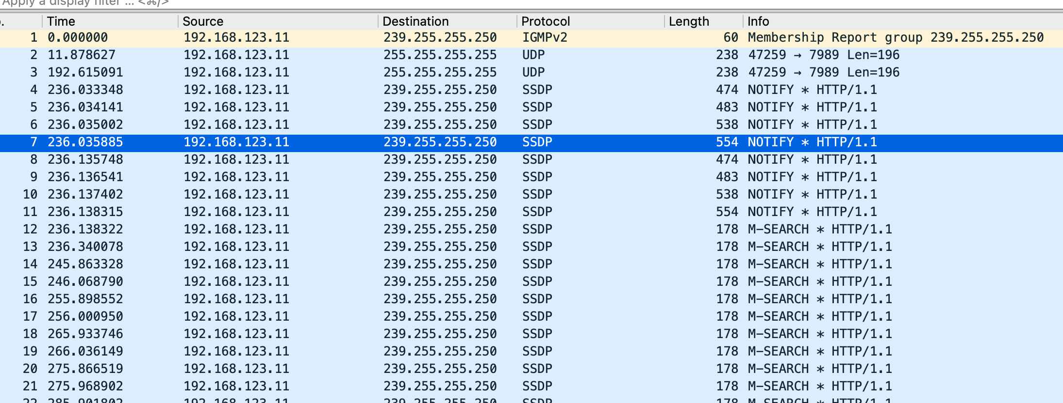

When online and linked, Wireshark shows the output below, the SSDP protocol updates the connection between NVR and Hik account.
When NVR hikconnect is offline and I enable hikconnect (no device on account), NVR goes online but I see nothing on Wireshark. I'm a Wireshark novice.
