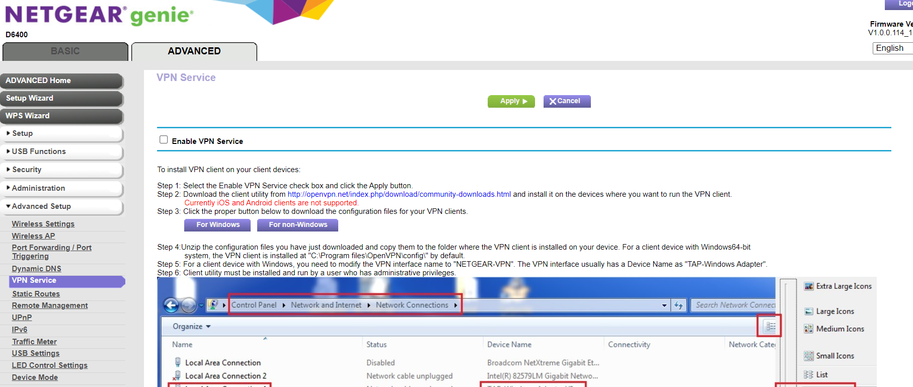

My current Netgear D6400 router does have VPN capabilities but I don't know how this will effect the other devices connected to it.
Actually just read there that andriod and iphone not yet supported
That's unfortunate, my router is from Draytek. I use 2 types of VPN connectivity, L2TP / IPSEC and SSL. I am surprised there is no Netgear Android / IPhone support, especially with the new work from home generation. The iPhone natively supports L2TP / IPSEC VPN client and I use the Draytek iPhone app for SSL VPN.
