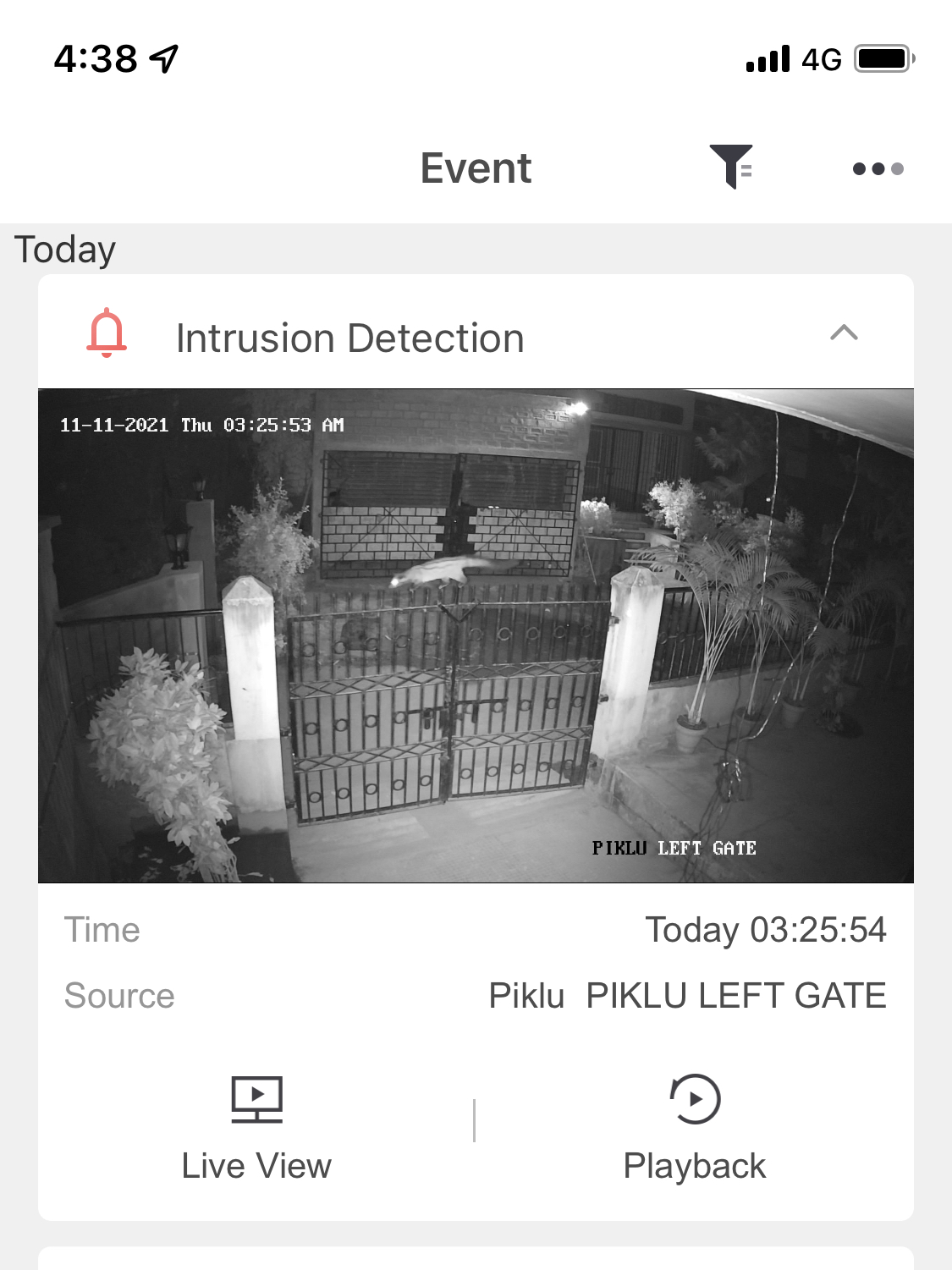

Hmmm, it seems the acusense cameras are not that great in differentiating between animals and humans as marketed by HikVision.
I get lot of false “intrusion” alarms triggered by cats and possums at Night. Attached one video - where the camera thinks the possum as a Human
I tried introducing min size and target validity in the cameras, but still I am getting the false alarms.
The thing with min size is that depending on where the animal is in the camera frame, it might be bigger than the min size.
I can’t make the min size too big, as then the humans at the farthest point becomes smaller than the min size and bypass the alarm.
Looks like all this human detection is basically based out of motion detector and not some AI based deep learning as HikVision advertised
