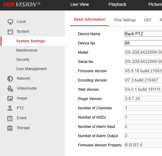

Sorry, I'm looking for available firmware for the DS-2CD2012-I camera. Current firmware is 5.4.5 build 170123. I think the new link is this: hikvisioneurope
Is the latest firmware V5.4.800 build 210813?
Thanks
That does look like the correct link since your current version is listed there before the new one... to be sure, look at the "firmware version property" of your camera... Does it contain "R0"? Here's an example from a "R7" series camera...
There probably wouldn't have been a newer version released for that EOL series camera but for the "command injection vulnerability"... Hikvision released .800 and .801 firmware to fix that security issue... I would definitely upgrade to the V5.4.800 build 210813 version!
