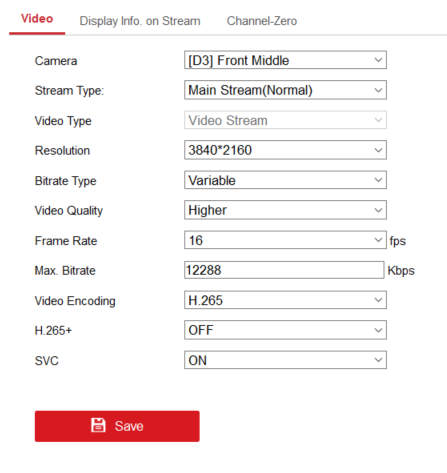

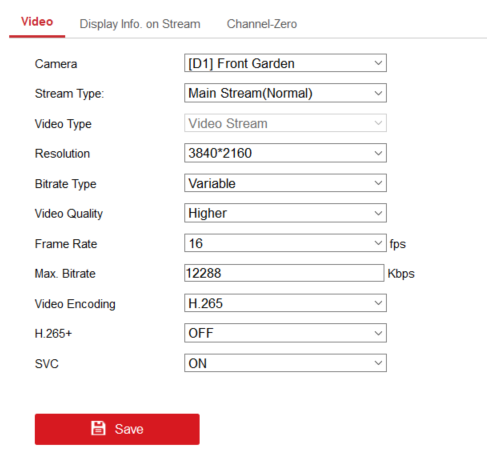

Looking back at your earlier comment in this thread you said that both cameras #1 & #3 were 2385 8MP cameras, is the full-screen issue only impacting one of the 2385 cameras?
Can you share the stream settings for both 2385 cameras?
Hi,
Any thoughts on why there is not enough resource?
D1 and D3 have the same settings, D1 will go full screen, D3 will not.
Both were fine before the NVR firmware upgrades.
