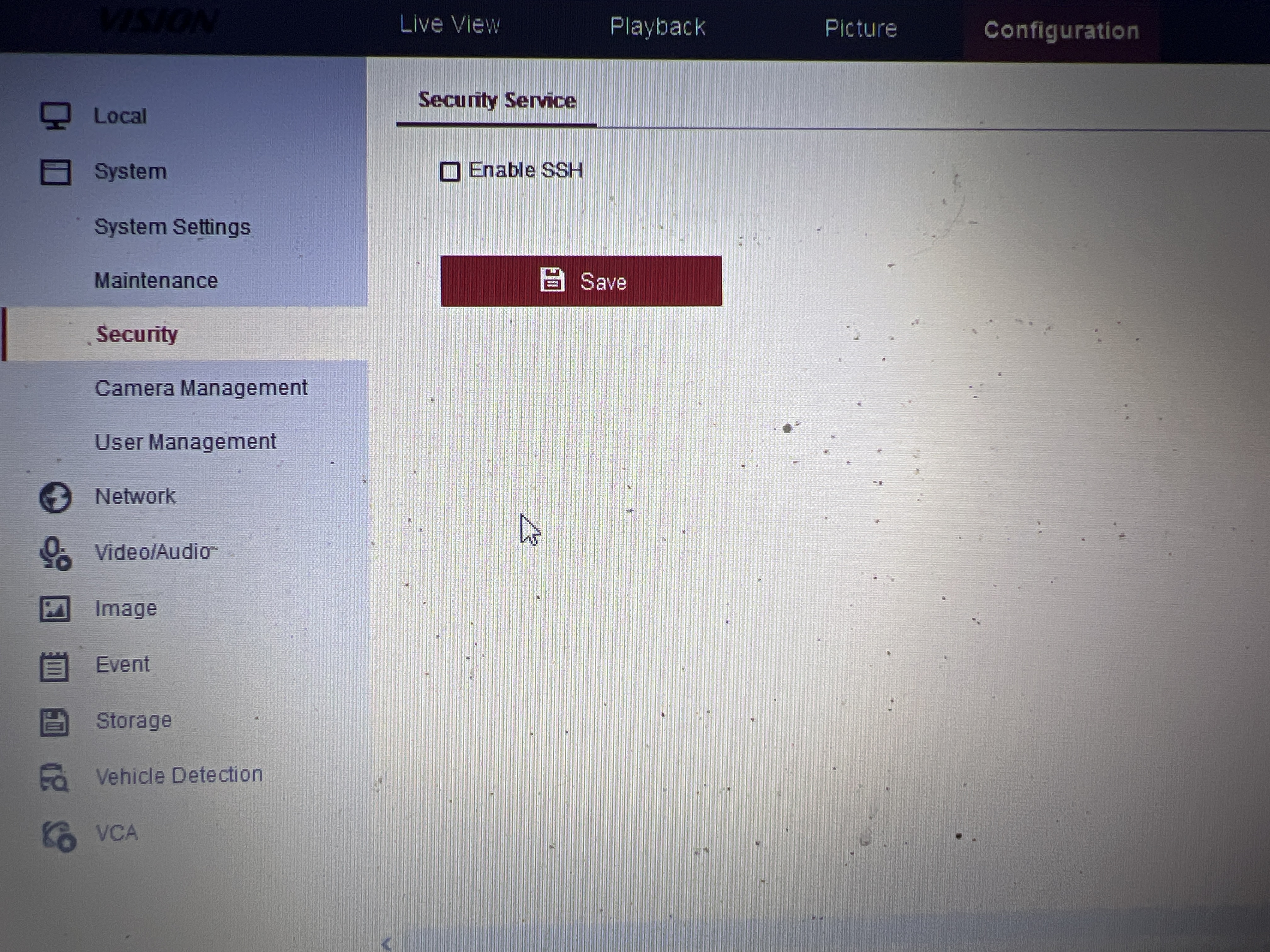

I’ve tried going into the settings on the dvr, but can’t see the option you mention. All I get under security is the below screen.
Unless it’s not an option as the dvr is too old? Or it could be somewhere else? I couldn’t see anything having a look
You needed to connect using the web browser as I detailed in the post. The photo you show is on the HDMI monitor.
I was using a laptop using Firefox web browser to connect, using the ip address of the camera to log in?
There the only options I could see
Yeah my bad. I glanced at the photo you posted and mistook it for the local menu; I can see now it's the browser.
