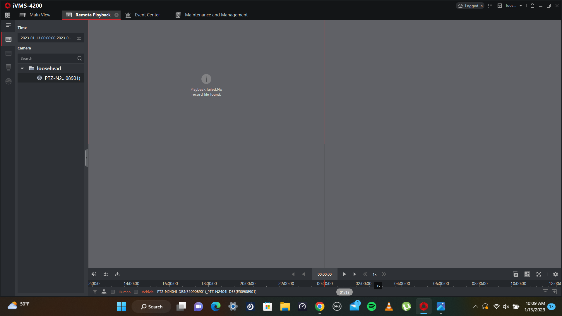

Can you share screenshots of the iVMS-4200 Main View and Remote Playback pages, please?
here they are. i still can`t understand why i can record with the ld player app and hilook

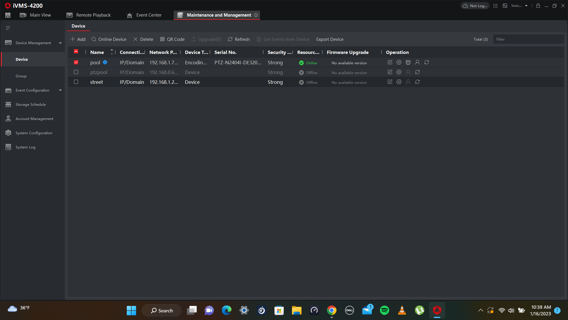

Sorry, I should have been clearer - can you send those screenshots, but while you are logged out of your Hik-Connect account in iVMS-4200, please?
her it is

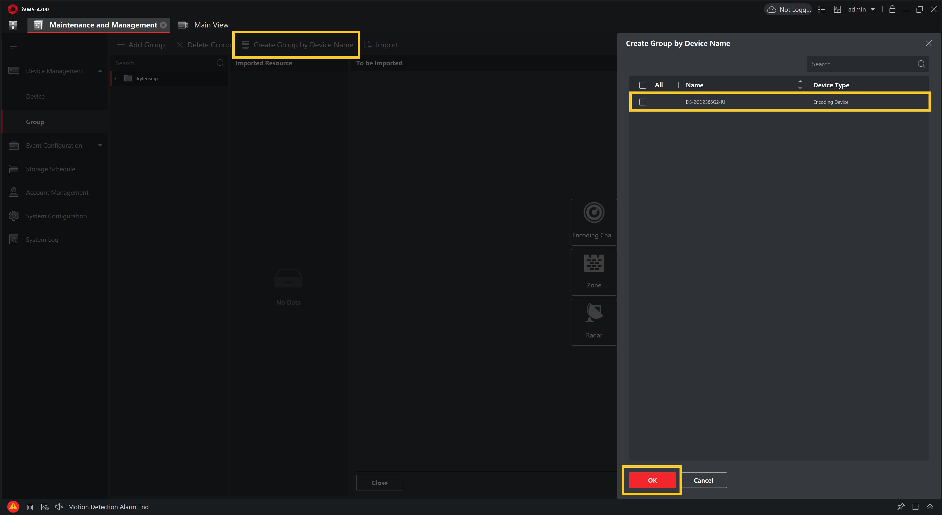

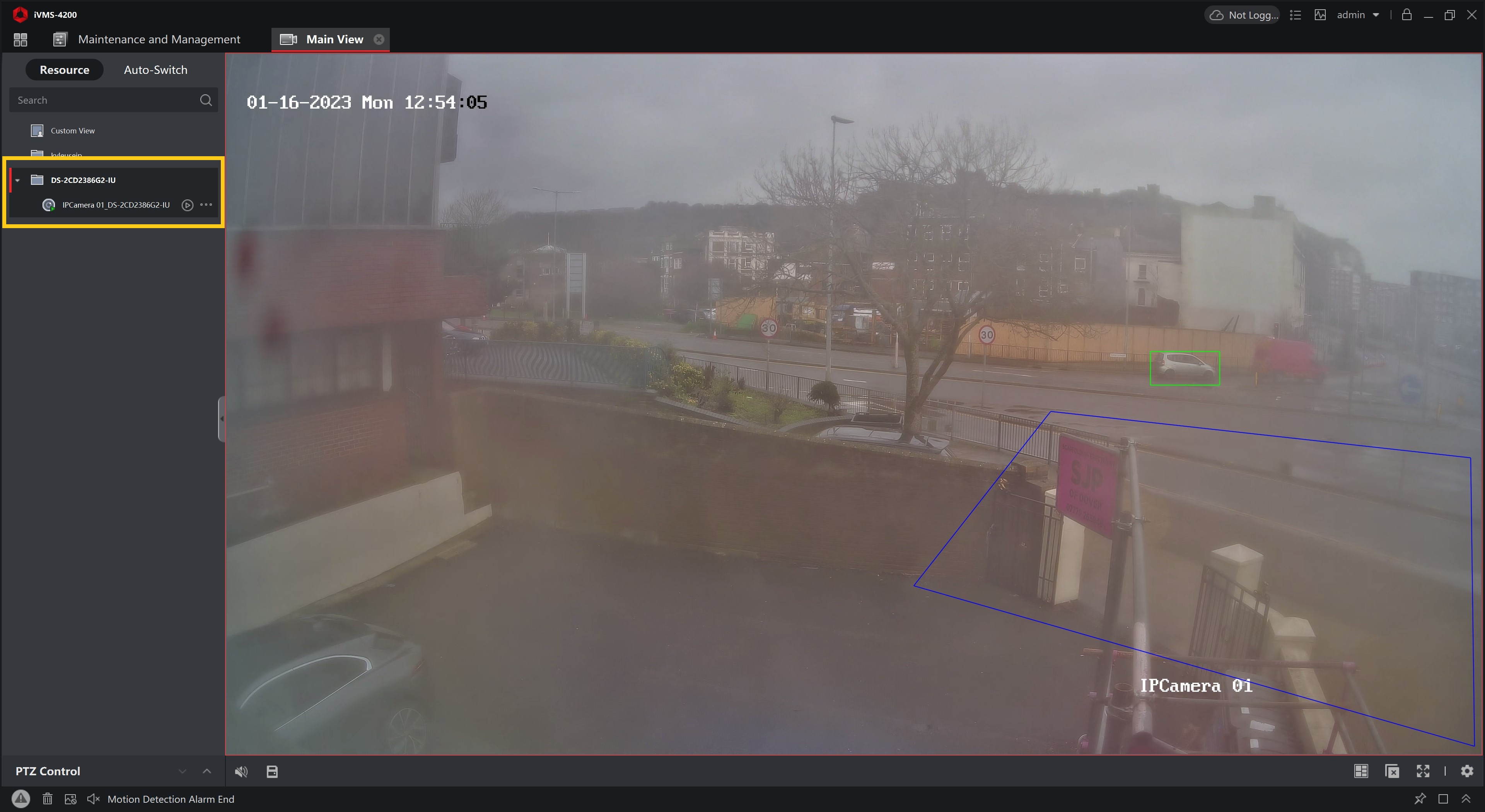

Thanks :) try the following:
  1. Go to Device Management>Group
  2. Click on Create Group By Device Name
  3. You should see your camera in the window that appears on the right-hand side - tick the box to select it and then click OK:
  4. You should now have a new expandable folder in your Main View and Playback pages for your PTZ, which should let you view the camera:

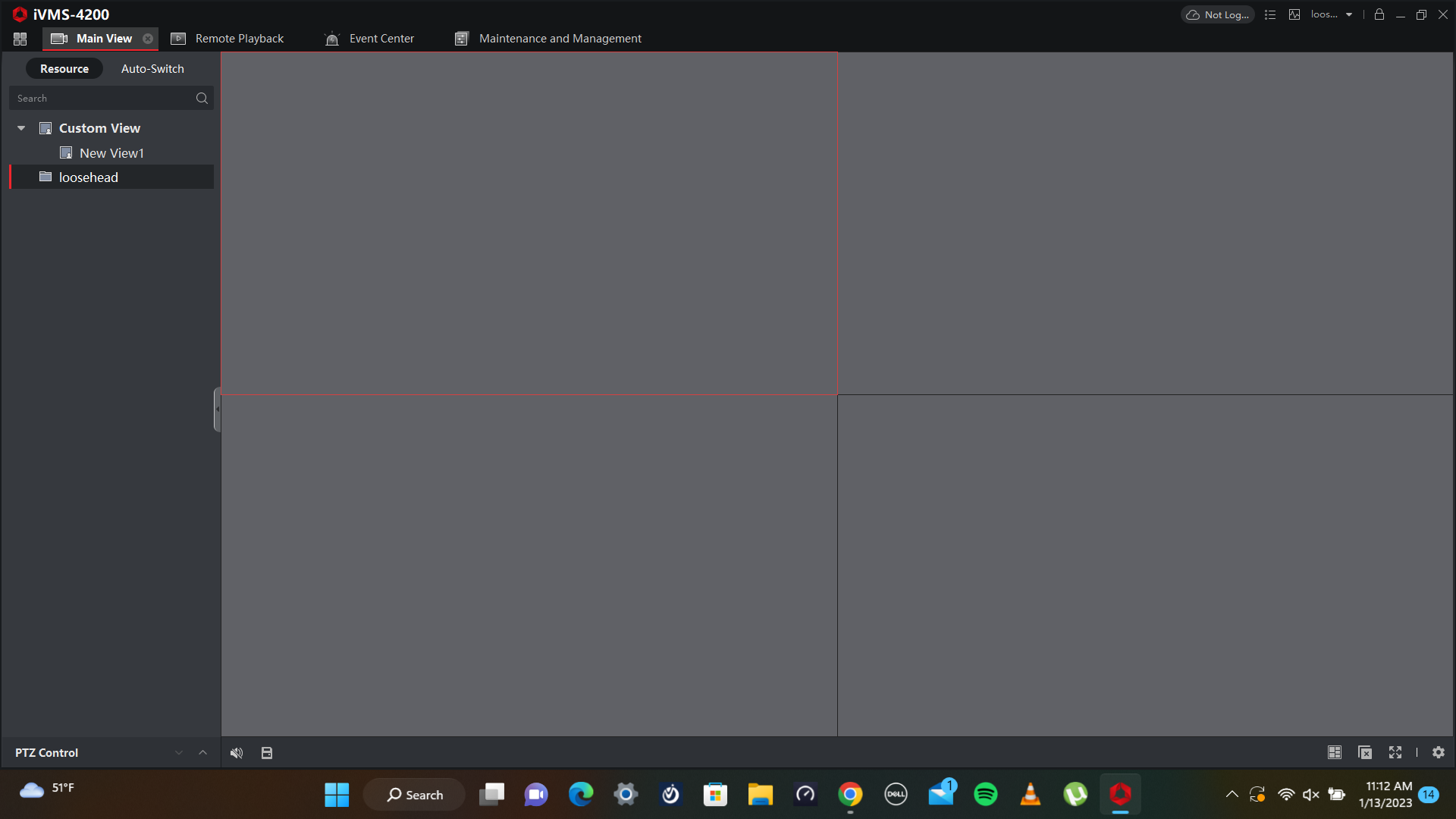

that didn`t work. i tried logging out of hiconnect and still only see original camera.
Can you send a screenshot of the main view page again after the "create new group" steps?

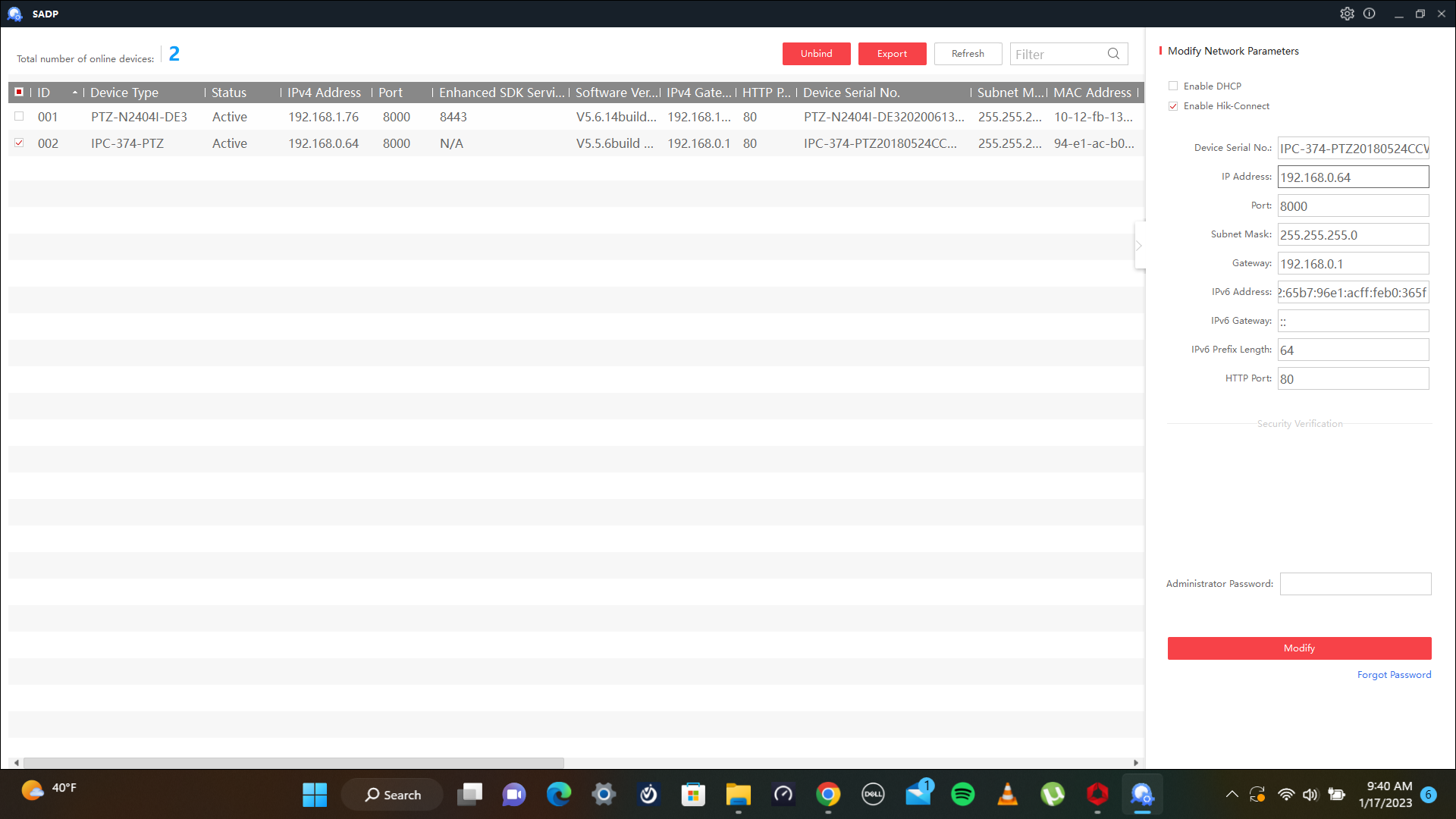

Can you also send a screenshot from SADP to show what should be viewable in iVMS-4200?

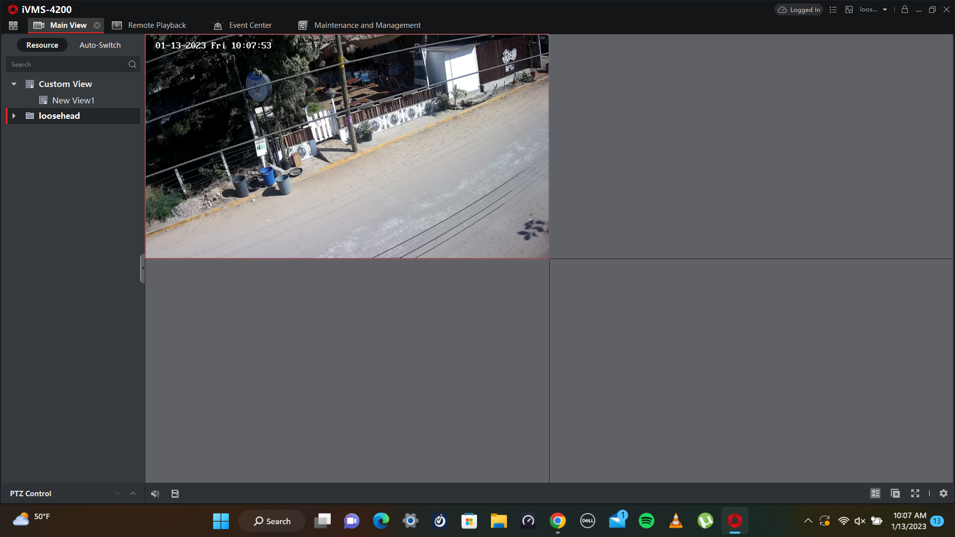

now i am viewing the camera the camera labeled street , which this screen says is offline, and it has been continuing recording for over 15 minutes now. wtf?
sorry i gave you the wrong info , after logging out of hiconnect i am viewing the camera that is not listed on the the page after log out but is listed in sadp
OK, it looks like the street PTZ has the wrong IP address for your network (IPC-374-PTZ).
Tick the box for this PTZ only and you should see a "modify network parameters" window appear in SADP.
Then, tick "enable DHCP", enter the password for the camera and then click "modify".
When you refresh SADP the IP address and gateway should change.

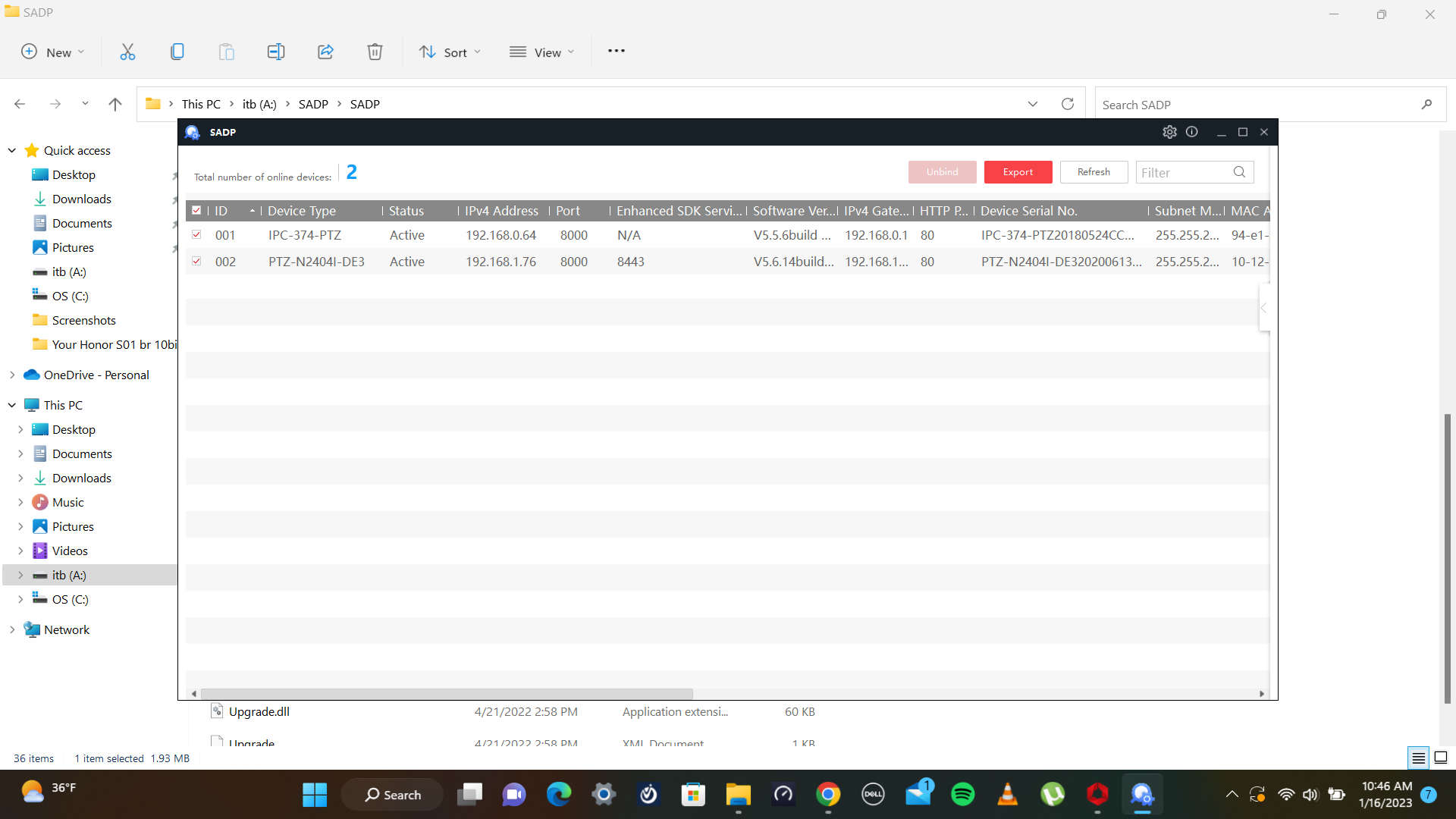

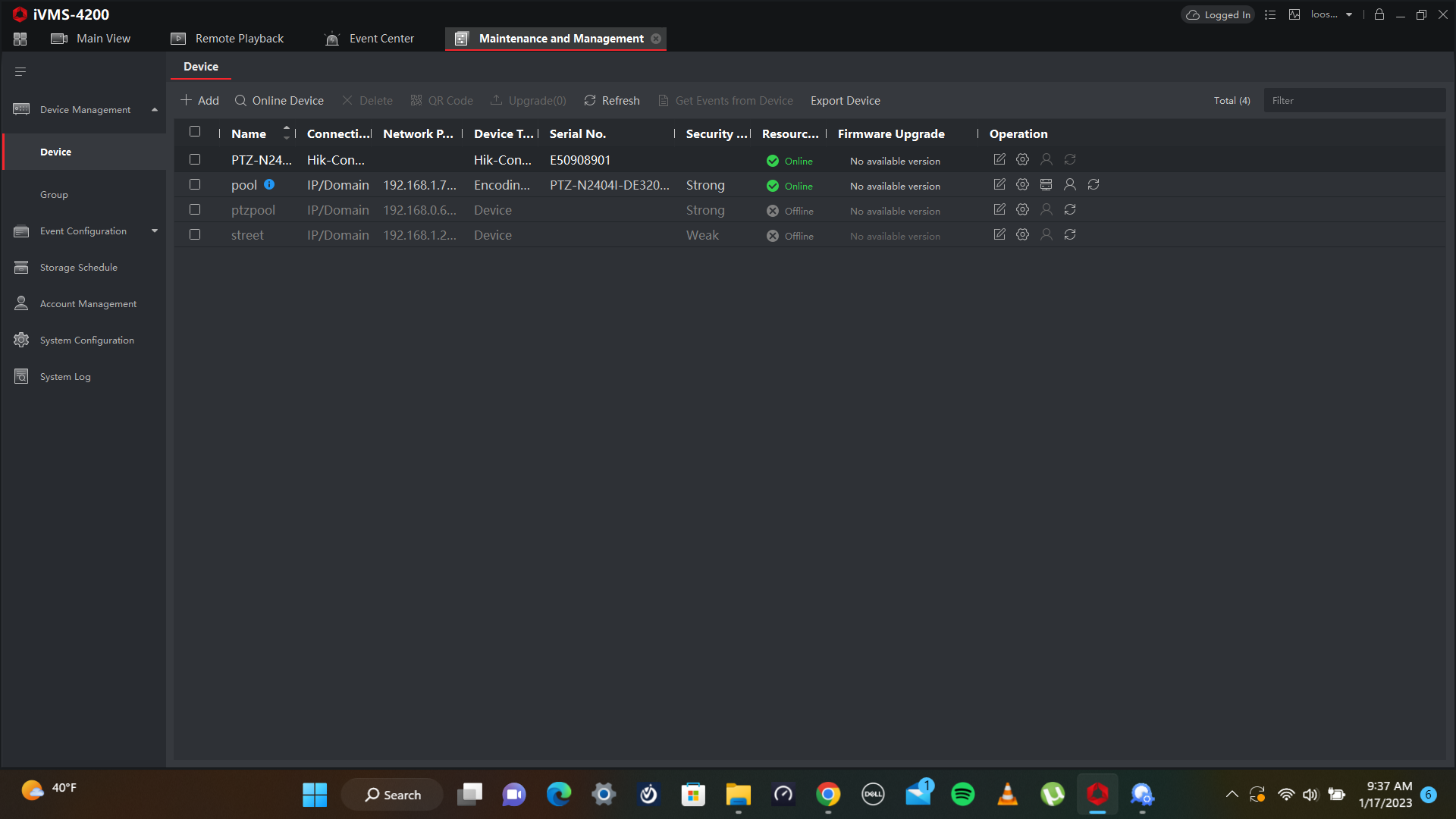

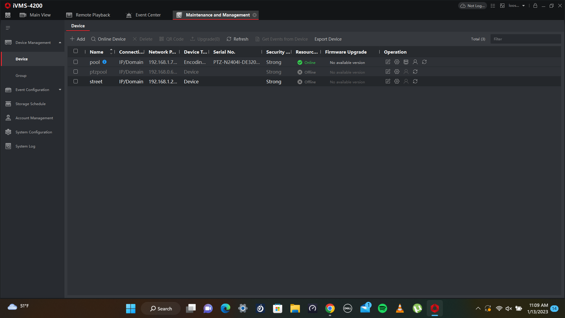

ok let me try to explain this better.when i am logged into hiconnect you can see from this screen shot that only the first 2 cameras are online, those are th only ones i am concerned about right now, the first cam i can view but it shuts off after 5 minutes, where as in the past it worked fine. the second cam i cannot view at all even though it is online. if i log out of hiconnect the first camera disappears but i can still view it and it stays on indefinitely . you can see that in the screenshot from yesterday. both cameras show online in sadp.
Thanks for the extra info.
The cameras you see online in iVMS-4200 are the same camera but added twice, as you can see that both are the PTZ-N2404I-DE3 - once from your Hik-Connect account (the top one in your list, which is why it disappears when you sign out), and then again via IP address (the second in the list).
When you view a device via Hik-Connect, it has a 5-minute timeout, which I think also applied in iVMS-4200 when you sign in to Hik-Connect:
The second one in the list should be viewable without timing out, as this isn't added via Hik-Connect.
It needs to be added to a "group" in iVMS-4200 for the live view and playback to work (see post #26 above), but I'm not sure why that hasn't worked for you.
The IPC-374-PTZ is a different camera, which has not been added to iVMS-4200, but I'm assuming that you need to be able to see this too?
So, you need to tick DHCP, which will get SADP to fix the network settings so it can be found on your network, and then either add it to iVMS-4200 with these correct settings - it should have an IP address of 192.168.1.x - it will then appear as online in iVMS-4200 too (see post #32).
If you still can't view the cameras listed as connected by IP/Domain, then you may have to use Internet Explorer to view them by entering the IP address in the address bar.
But, I think being logged in to your Hik-Connect account is confusing things, as it just means that the same camera is added twice.
Could you send a screenshot of the "group" page in iVMS-4200 too, please?

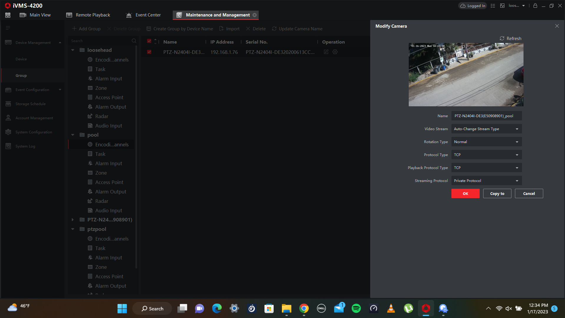

what i don`t understand is the why the second camera says online and encoding.that is also the only camera that i can access the settings menu. i see the first camera not the one that says encoding as you can see in this screen shot even though it has a different serial number. i am viewing the first camera that i can`t access the settings menu from it.
