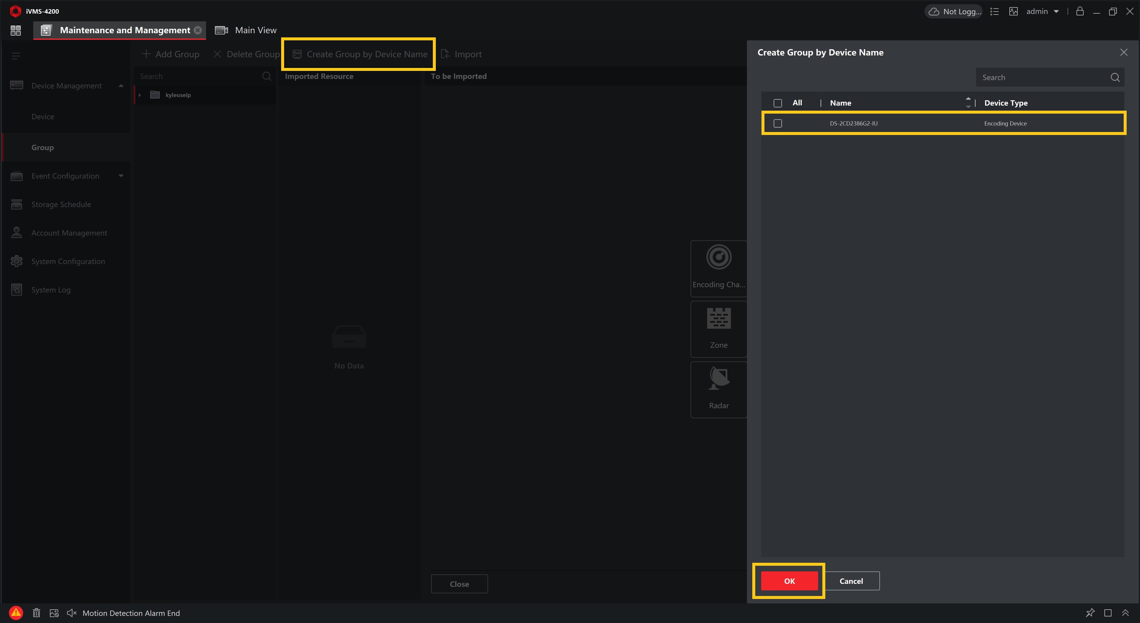

Thanks :) try the following:
  1. Go to Device Management>Group
  2. Click on Create Group By Device Name
  3. You should see your camera in the window that appears on the right-hand side - tick the box to select it and then click OK:

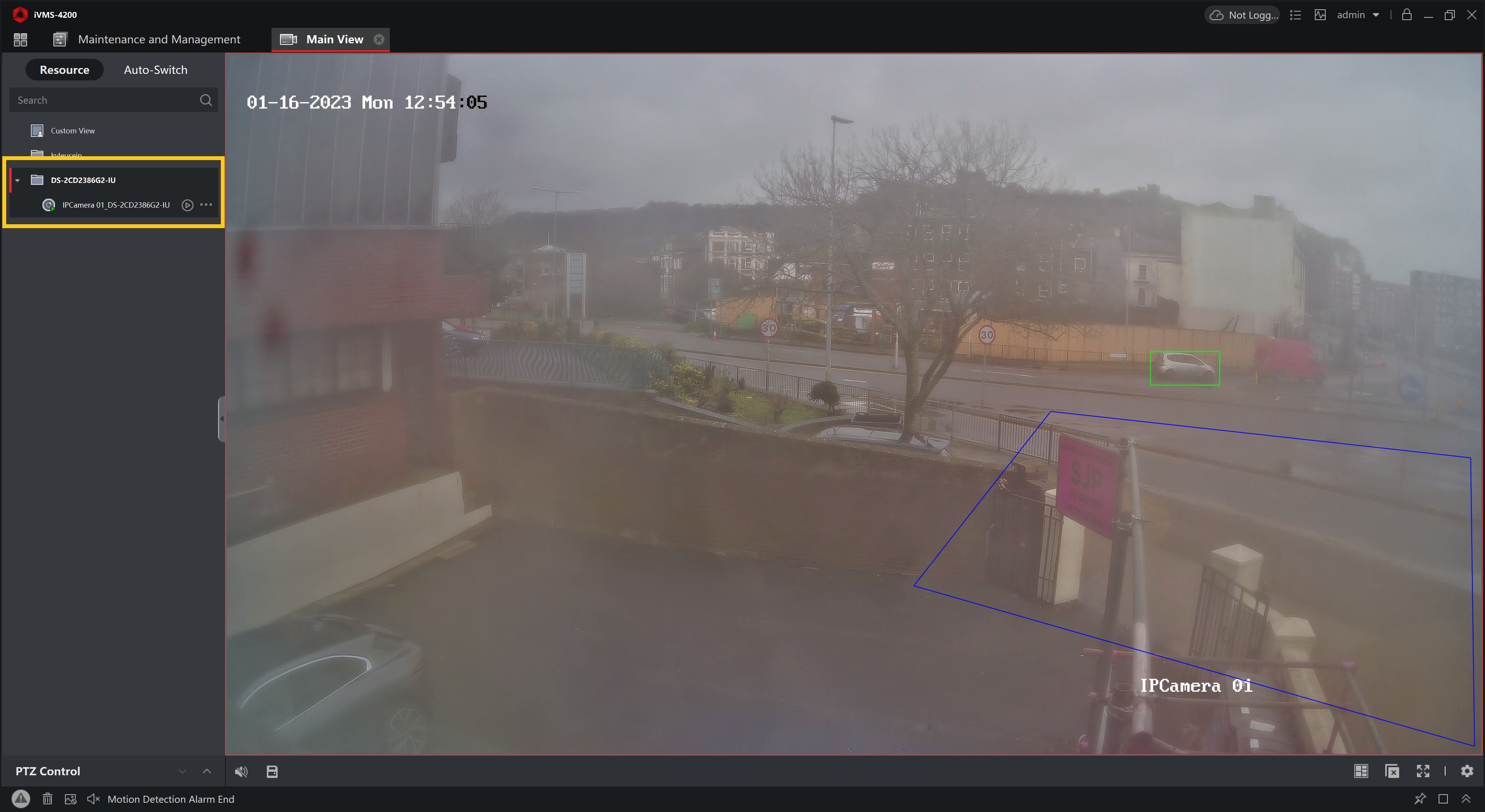

  4. You should now have a new expandable folder in your Main View and Playback pages for your PTZ, which should let you view the camera:
