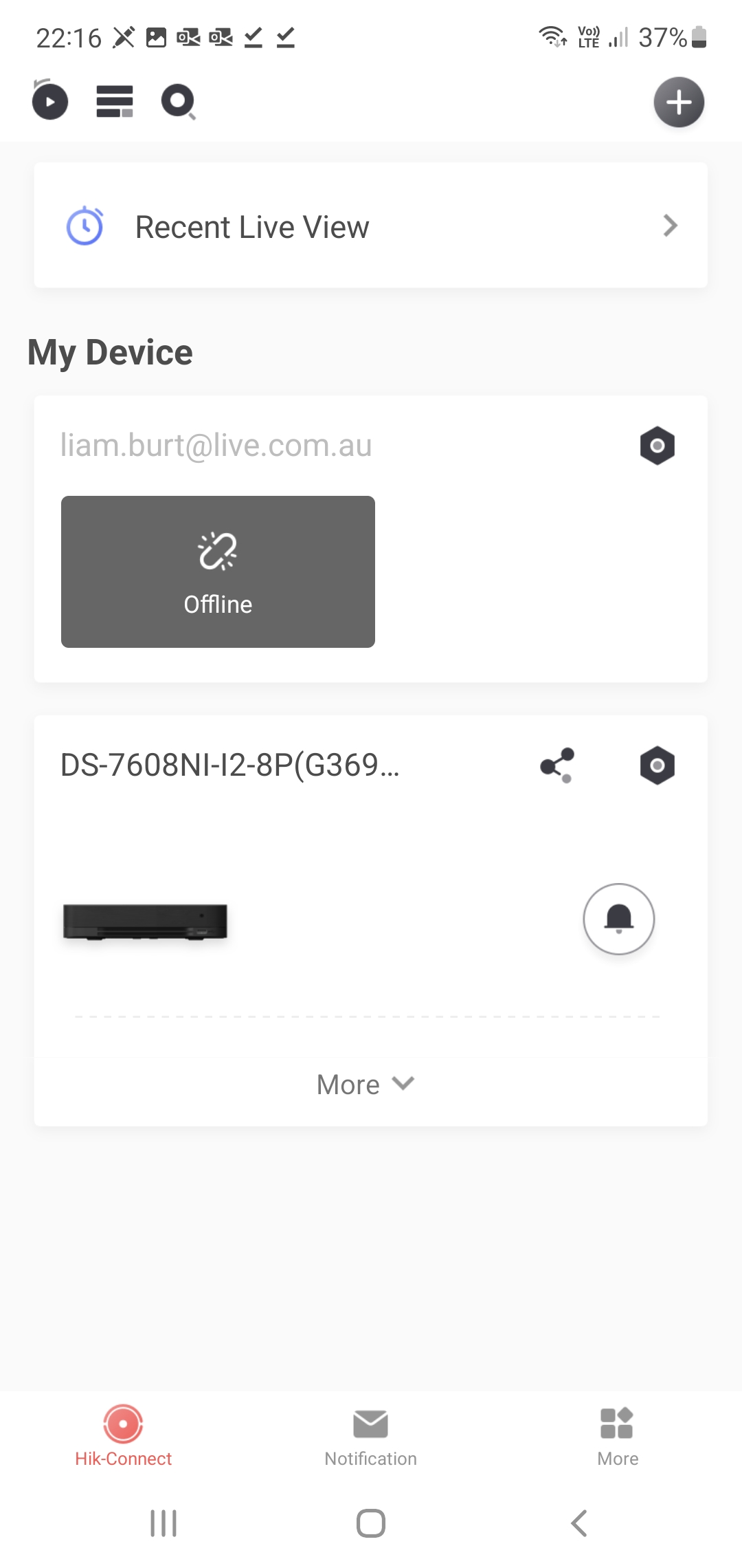

See image, I only have the solid alarm bell icon, but also should the bell with lights also be showing.
Again, thanks for all your help.

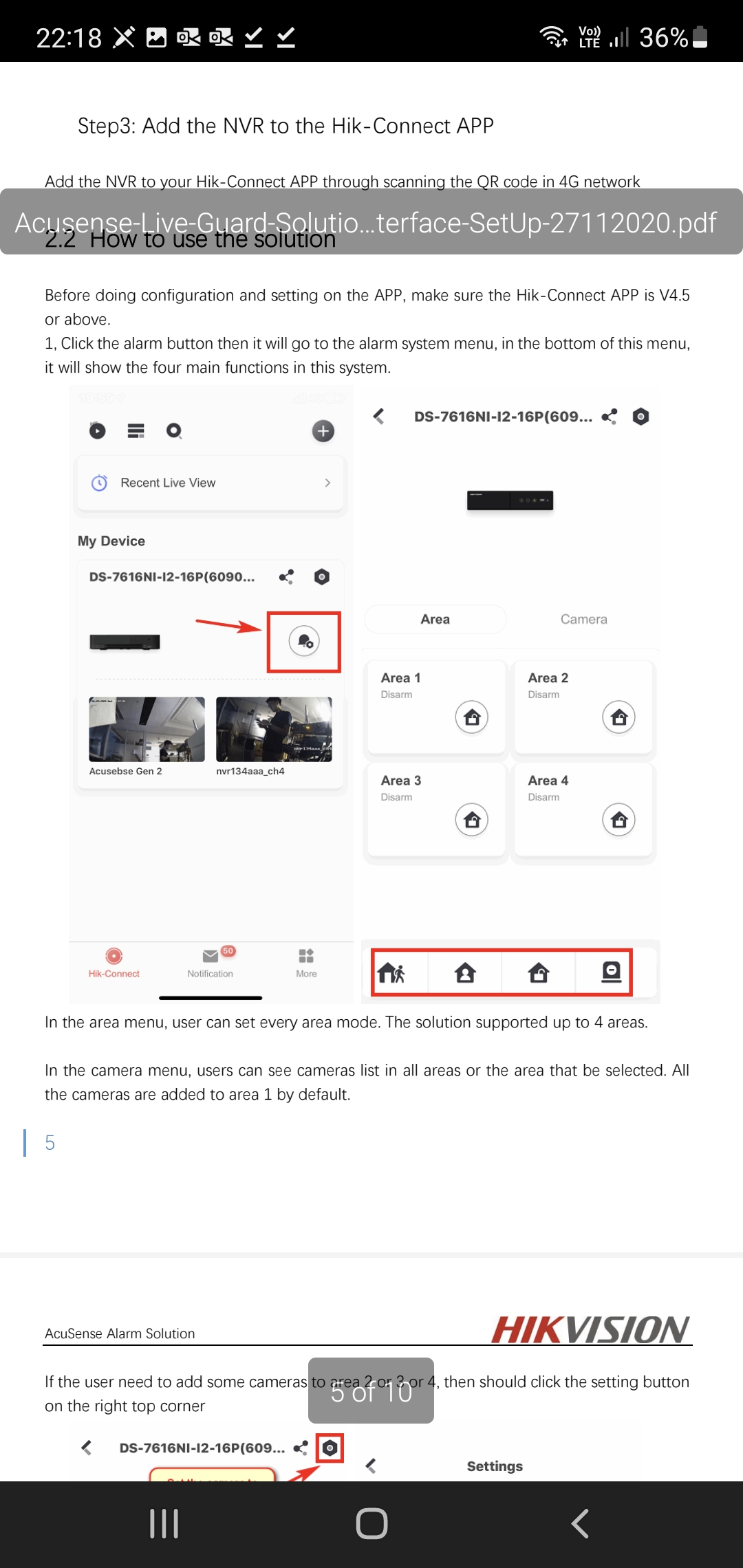

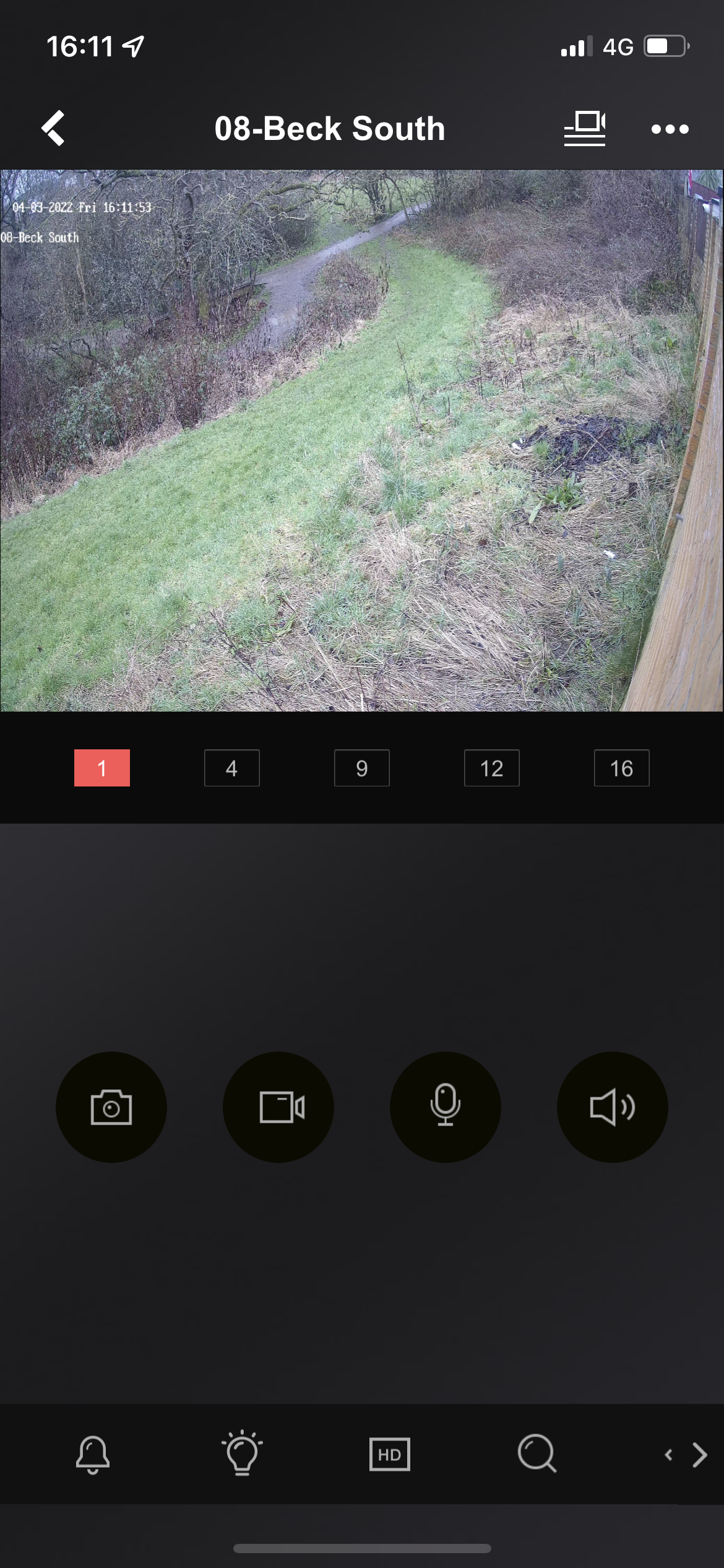

When connected to a compatible camera with siren/strobe light (ISU/SL or LSU/SL) you’ll get two additional icons on the toolbar below the picture. They’ll appear at the left hand side of the toolbar (you need to scroll the toolbar to the right hand end to get the one that fires the alarm output) See mine below for the two far left icons:

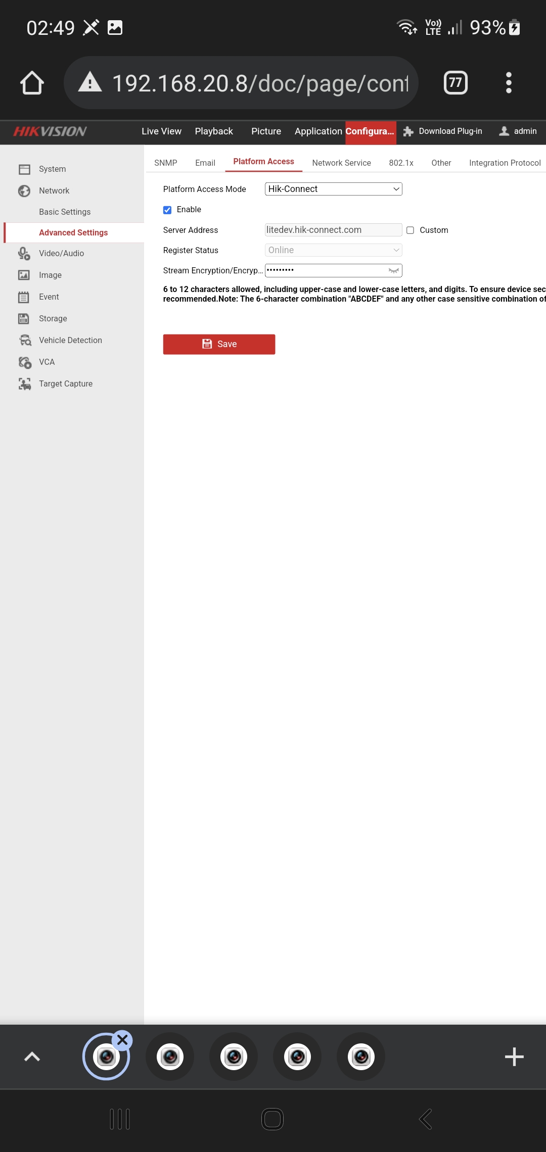

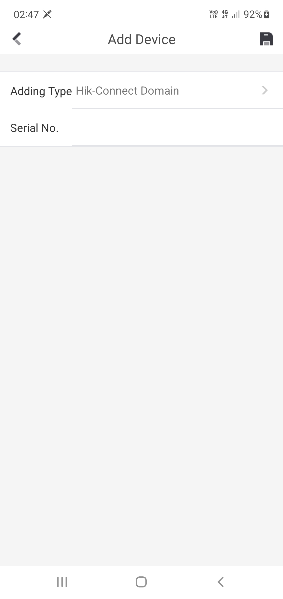

I ticked the check box in NVR gui.

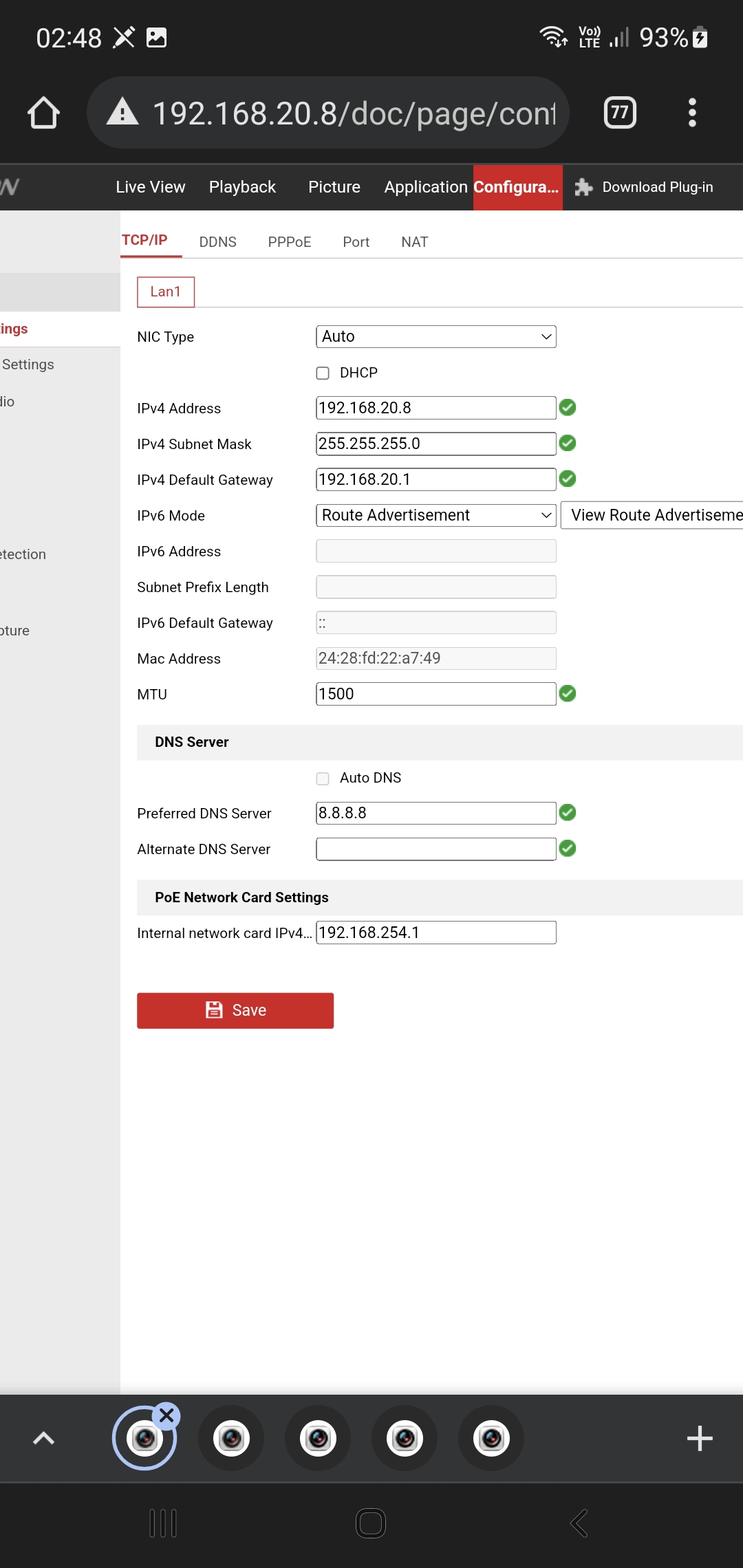

There was an issue where it was off-line, and I have to add 8.8.8.8 in the port settings, then I added the NVR as a device using its serial number

I've also had a look at a post about the firmware update. They mention the one touch button to mute notifications. With that 'new' button, where would I expect to access the page where you arm the areas and open the camera details.
The old button was a bell with a hexagon/cog. Now it's a plain bell.
My current screen can't open areas/partition to arm
Old screen (screenshot from a how to file, that looks similar)

I think the ability to trigger strobe/audio manually from HikConnect became available as a result of the NVR firmware rather than the camera. I forget which version introduced it but it will have been around V4.50 or above. In that regard neither your earlier customised firmware or what you upgraded it to will get it working. You would need to bring it up to date.
In short you need your old firmware for the area arming function and a much newer version for the function allowing you to manually start the siren/strobe. So you can’t have both.
