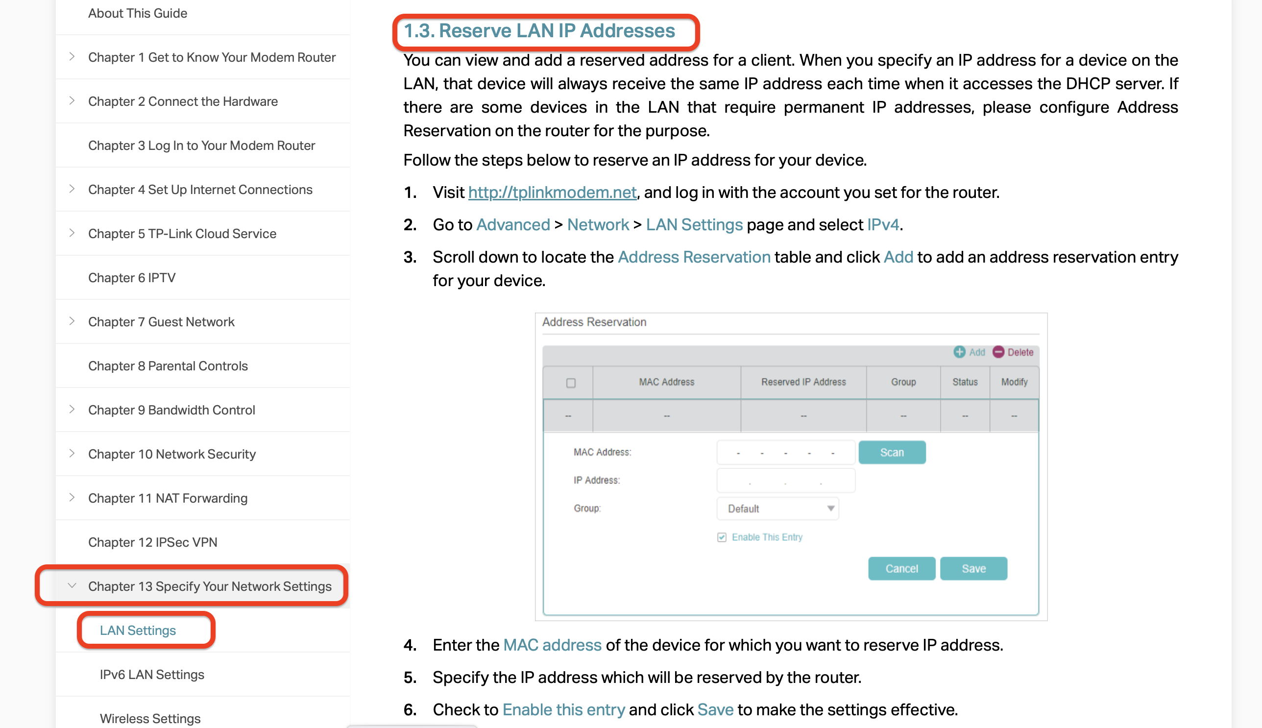

Does the attached help? From the link go to para 1.3 Reserve LAN IP address.
check NVR enable DHCP
Delete the MAC bindings that you created.
create the reserved IP address. When done send me a screen shot.
Sorry for the confusion, I'm used to routers that use DHCP MAC binding from the ARP. I think your router is an older one.

I've upgraded the firmware on the router for good measure, but I think the IP reservation was the missing trick.
NVR is happy now with.104 and should remain content for the foreseeable future!
